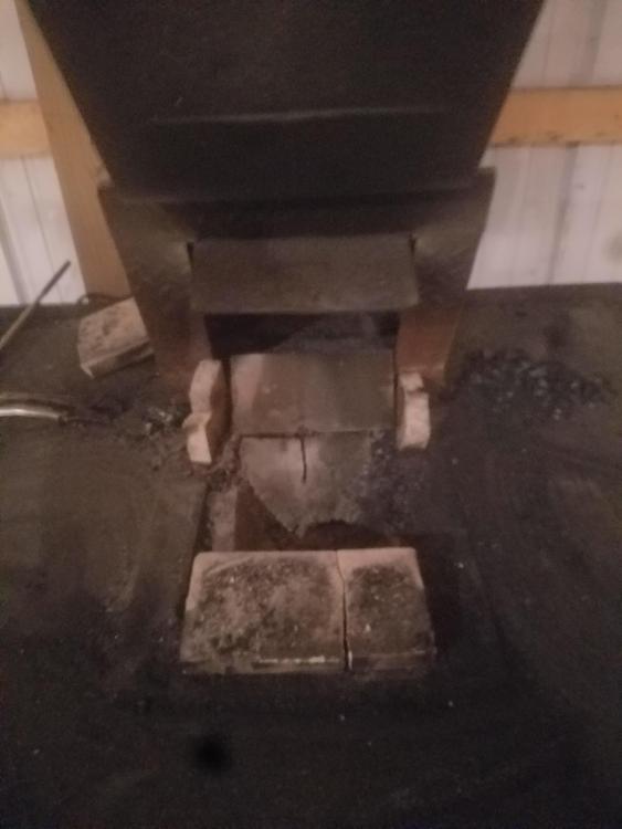

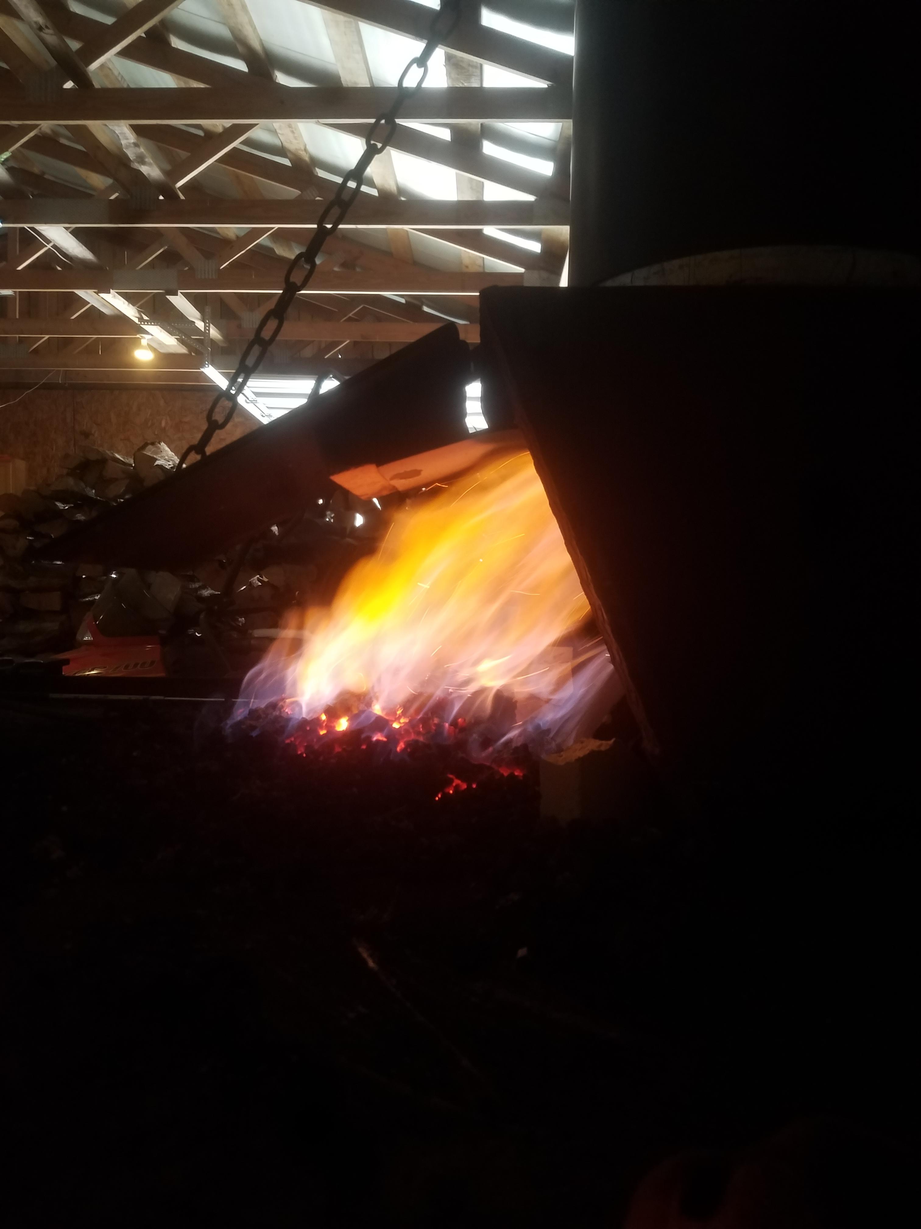

Millhand Posted January 30, 2017 Author Share Posted January 30, 2017 After two straight days of forging the I've figured out what works for me. I've had to shrink up this pot all the way around. I was burning to much fuel and steel. It's working well now. I've found that I enjoy charcoal out of my outdoor Woodstove over coal. Once I develop a way to transport enough of it I'll stop using coal. Couple reasons, 1 it's semi free, 2 I don't burn as much iron. 3 it's alot cleaner. Quote Link to comment Share on other sites More sharing options...
ThomasPowers Posted January 30, 2017 Share Posted January 30, 2017 Gotta cut way down on air to use charcoal compared to coal. In some ways its like gasoline and diesel; both can work well but you *really* need the engine designed for the fuel! I built a shovel to move coals from a wood fire to the forge. Made it from gravel shaker screen allowing me to get rid of the ash and too small pieces: scoop from the fire, shake it over the fire and dump the clean coals in the forge. Quote Link to comment Share on other sites More sharing options...
Millhand Posted February 1, 2017 Author Share Posted February 1, 2017 On a stroke of luck, the 6" horticultural blower I'm using on a vf drive will adjust across a wide range. I spent some spare moments today considering the what nots, on sorting the char out of my boiler. What I came up with is a couple 30 gal drums with sealed lids for snuffing out the char. after collecting it with screen like your description. I'll run my boiler over loaded to pile up carbon. I will run a heavy hard maple/ ash mix. Both make great piles of carbon. I can make enough to fuel my forge non stop and stockpile for the summer. I'm thinking a fork like the horse farmers use to clean Sawdust. Lots of tines 1' apart. Maybe I'll save my good coal for super clean Welding heat when I get to that point. My boiler can make a 55 gal drum of great charcoal a day if I run it accordingly. (Packed full with little energy consumption from the house) great carbon factory. Just have to figure out storage and transportation Quote Link to comment Share on other sites More sharing options...

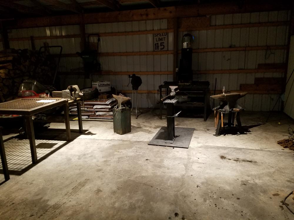

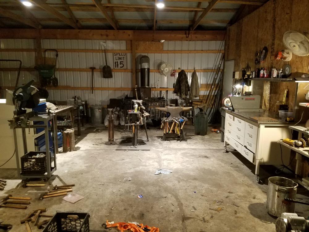

Millhand Posted February 20, 2017 Author Share Posted February 20, 2017 Shop is coming together, my daughter and I unloaded and set the welding bench today. We also swept and cleaned the shop. Good day!! Quote Link to comment Share on other sites More sharing options...
C-1ToolSteel Posted February 20, 2017 Share Posted February 20, 2017 Looking good! ...although I do think 115 rpm is a little on the fast side for blower cranking. I do like the sign idea though for newbies. Quote Link to comment Share on other sites More sharing options...
ThomasPowers Posted February 20, 2017 Share Posted February 20, 2017 The forging part of my shop has a sand/clay floor and no matter how often I sweep it it continues to be dusty, sigh... Quote Link to comment Share on other sites More sharing options...
Millhand Posted February 20, 2017 Author Share Posted February 20, 2017 Thanks C-1 that sign came with the "new to me" pole barn. It's wedged in quite solid and I haven't bothered to remove it. It's funny, my son cranks it 115 and my daughter cranks it 15rpm! Think I'm in trouble! Sand/clay is best! It doesn't need sweeping and keeps the taxes low! I still have to plumb that blower in. Figure it will be something for the kids to help with. I'll use my daughter for small work and son for welding lol Quote Link to comment Share on other sites More sharing options...
ThomasPowers Posted February 20, 2017 Share Posted February 20, 2017 Well I don't have to worry much about moisture out here and it is nicer on the joints and back than a concrete floor. Cheap too. Quote Link to comment Share on other sites More sharing options...

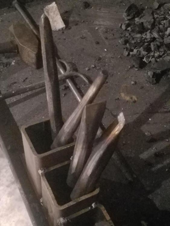

Millhand Posted February 22, 2017 Author Share Posted February 22, 2017 Did I mention I absolutely love my forge? The deep pot and the insert I made to make it shallow made a 2 inch drop to the clinker breaker. It's a strange pot but it works awesome!! Hood works great as well and I'm getting good to fire management. Been mixing tractor supply coal with charcoal as fuel. Works great. 20 gal of hard maple charcoal I pulled from my boiler this am. Starting to amass my mandatory tools. Feels good to have only started with a few hammers and one set of usable tongs. Cut up some semi trailer Spring with the band saw for some more punches drifts and chisels. The one I cut to shape will be a stone chisel of some sort... Quote Link to comment Share on other sites More sharing options...

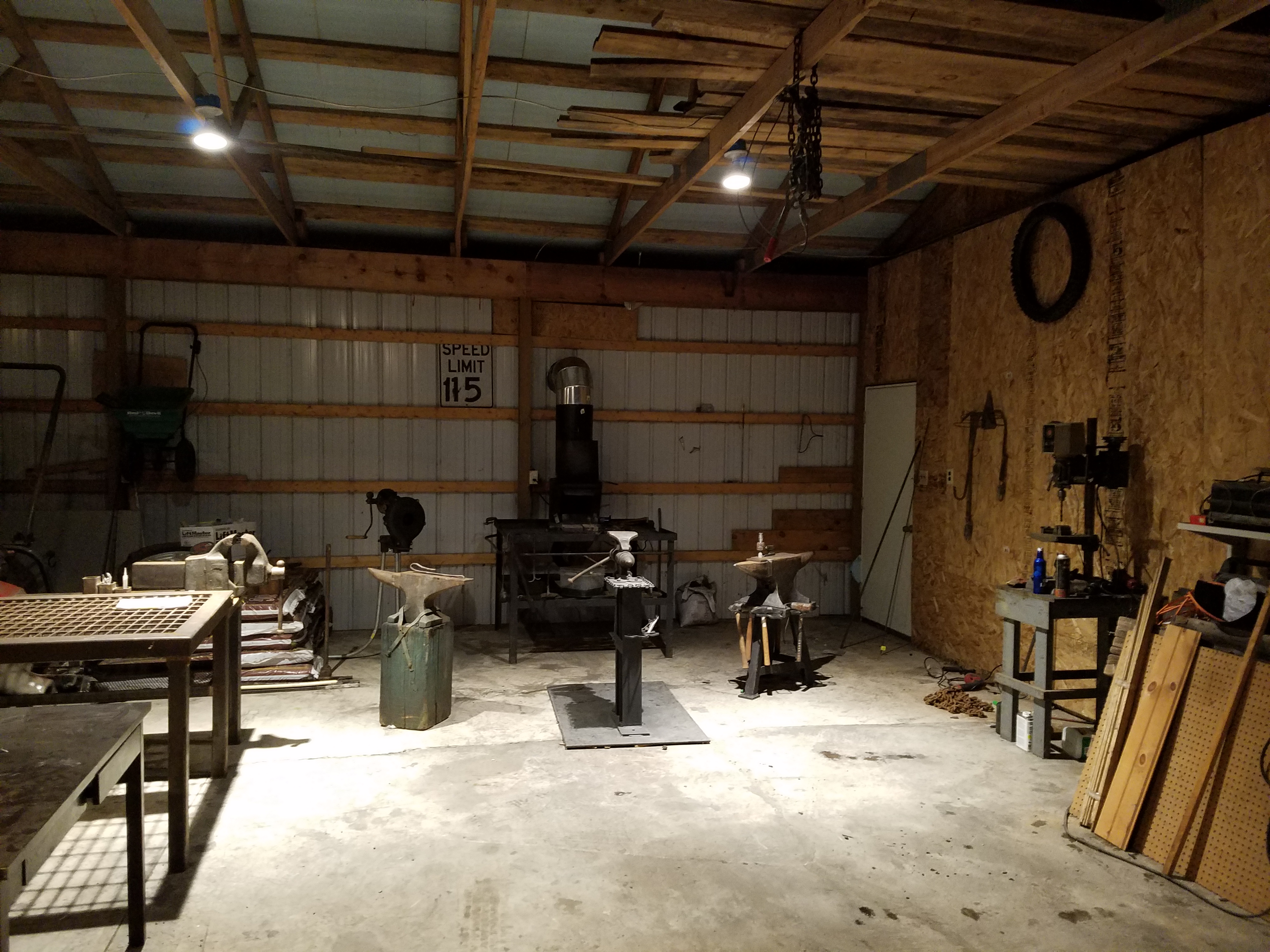

Millhand Posted June 28, 2017 Author Share Posted June 28, 2017 Wow look at how far she has come!! Feb 19 June 26 Will post some pics of some small changes to the forge. Fire pot was to large! I made a insert and built a grate to keep the coal up out of the inlet. Works like a champ! Quote Link to comment Share on other sites More sharing options...
arkie Posted June 28, 2017 Share Posted June 28, 2017 Great that you have lots of room and can get inside in cold weather! Quote Link to comment Share on other sites More sharing options...
Mark Ling Posted June 30, 2017 Share Posted June 30, 2017 if only I had a shop that big.......very nice shop. Littleblacksmith Quote Link to comment Share on other sites More sharing options...
WoodnMetalGuy Posted June 30, 2017 Share Posted June 30, 2017 I like that you're starting to get some more lighting in there. Those two ceiling spots alone looked pretty grim to work by. Seems like your shadow would often be on the work. I'm slowly converting my fluorescent fixtures to use the new 4 foot LED bulbs that look just like fluorescent tubes, but are brighter, and work great even when it's so cold the fluorescent ones fail to light. -- Dave Quote Link to comment Share on other sites More sharing options...
ThomasPowers Posted June 30, 2017 Share Posted June 30, 2017 I have a couple of fiberglass panels in the roof and generally use free natural daylight. They diffuse it well. Quote Link to comment Share on other sites More sharing options...

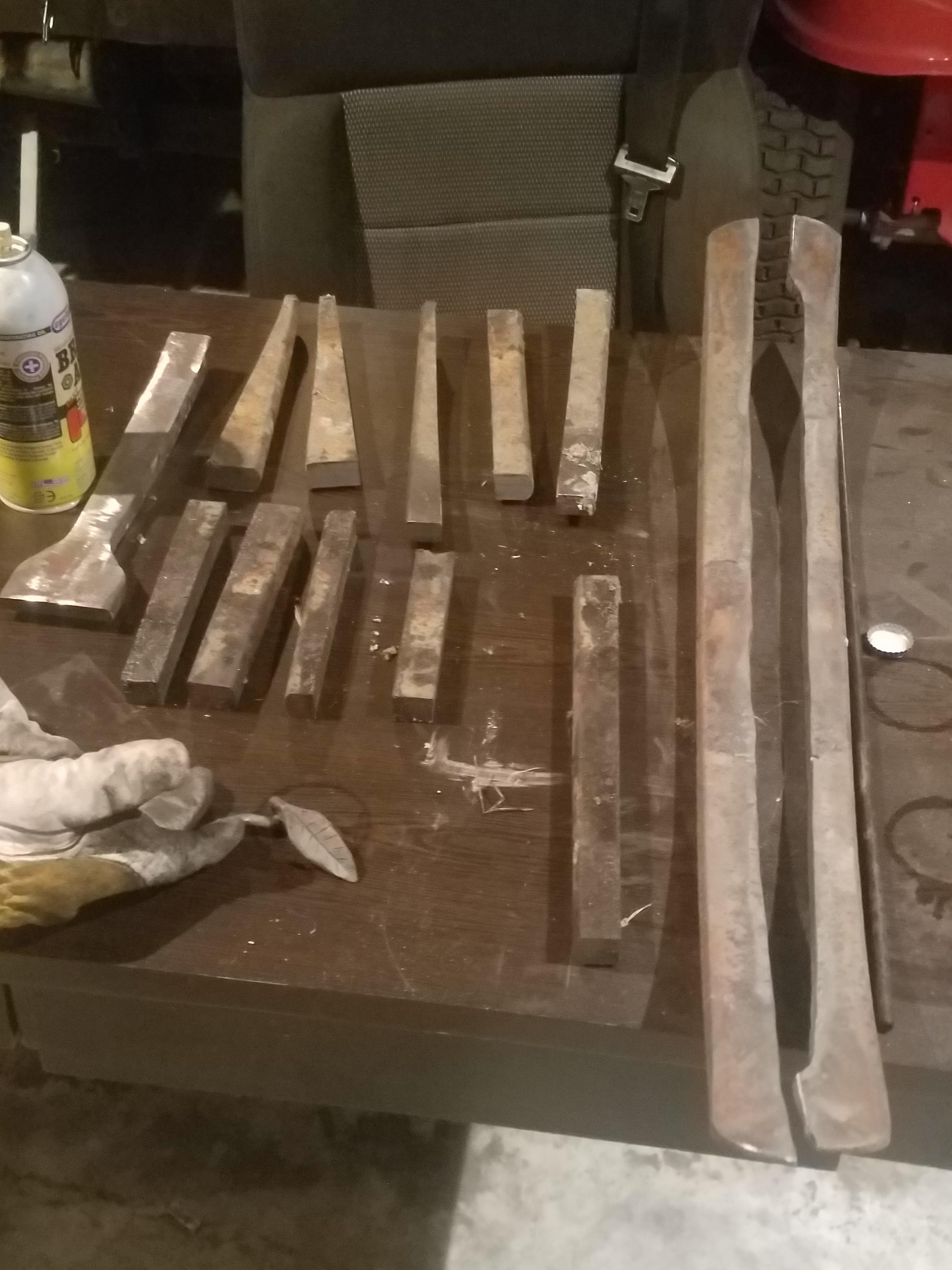

Millhand Posted July 1, 2017 Author Share Posted July 1, 2017 I like it fairly dark wile forging. Unfortunately ive been doing more tool restoration than hammering on hot iron as of late. Still have quite a few hammers to handle before I can get back to work. Quote Link to comment Share on other sites More sharing options...
Glenn Posted July 1, 2017 Share Posted July 1, 2017 Nothing wrong with work station lighting where you need it. A switch can turn them off when not needed. Quote Link to comment Share on other sites More sharing options...
