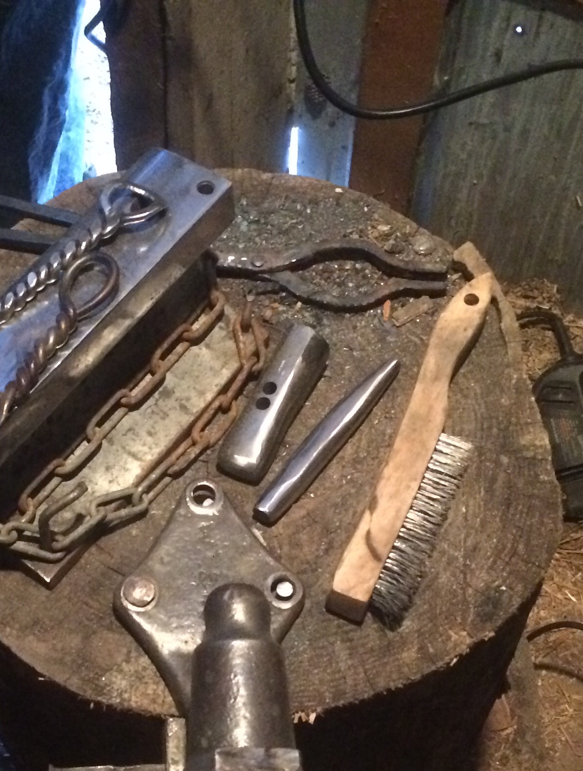

Jasent Posted June 23, 2017 Share Posted June 23, 2017 Very first thing I forged (besides tapers and reverse tapers, bends, twists, and bars)were the tongs in this pic. Only pic I have of them. Quote Link to comment Share on other sites More sharing options...

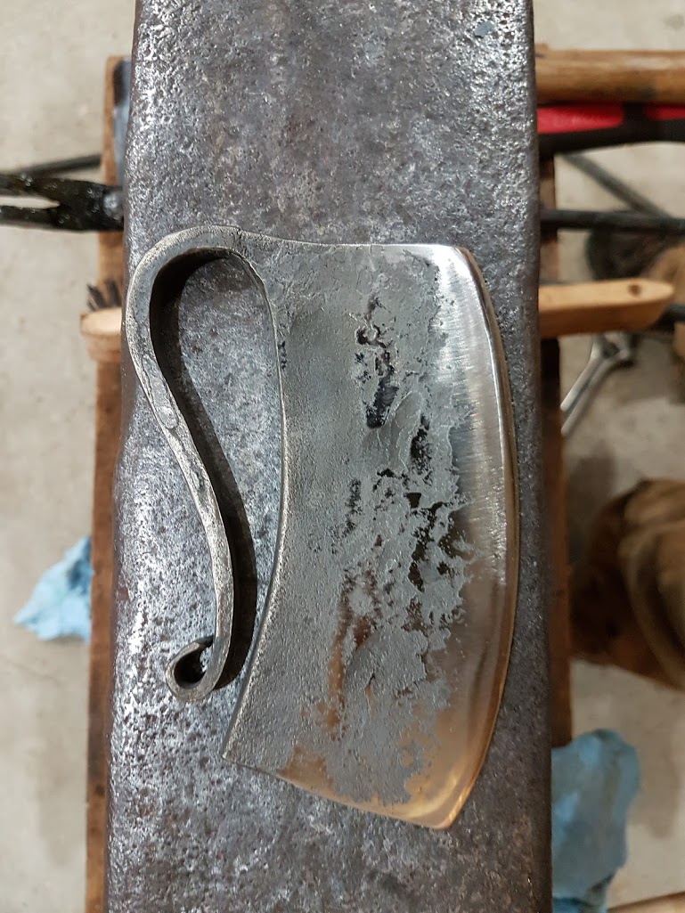

Jrock77 Posted July 31, 2017 Share Posted July 31, 2017 First thing I a made was a set of rebar tongs sadly no picture but second thing I made is this herb chopper which cuts up vegetables almost every night. Quote Link to comment Share on other sites More sharing options...

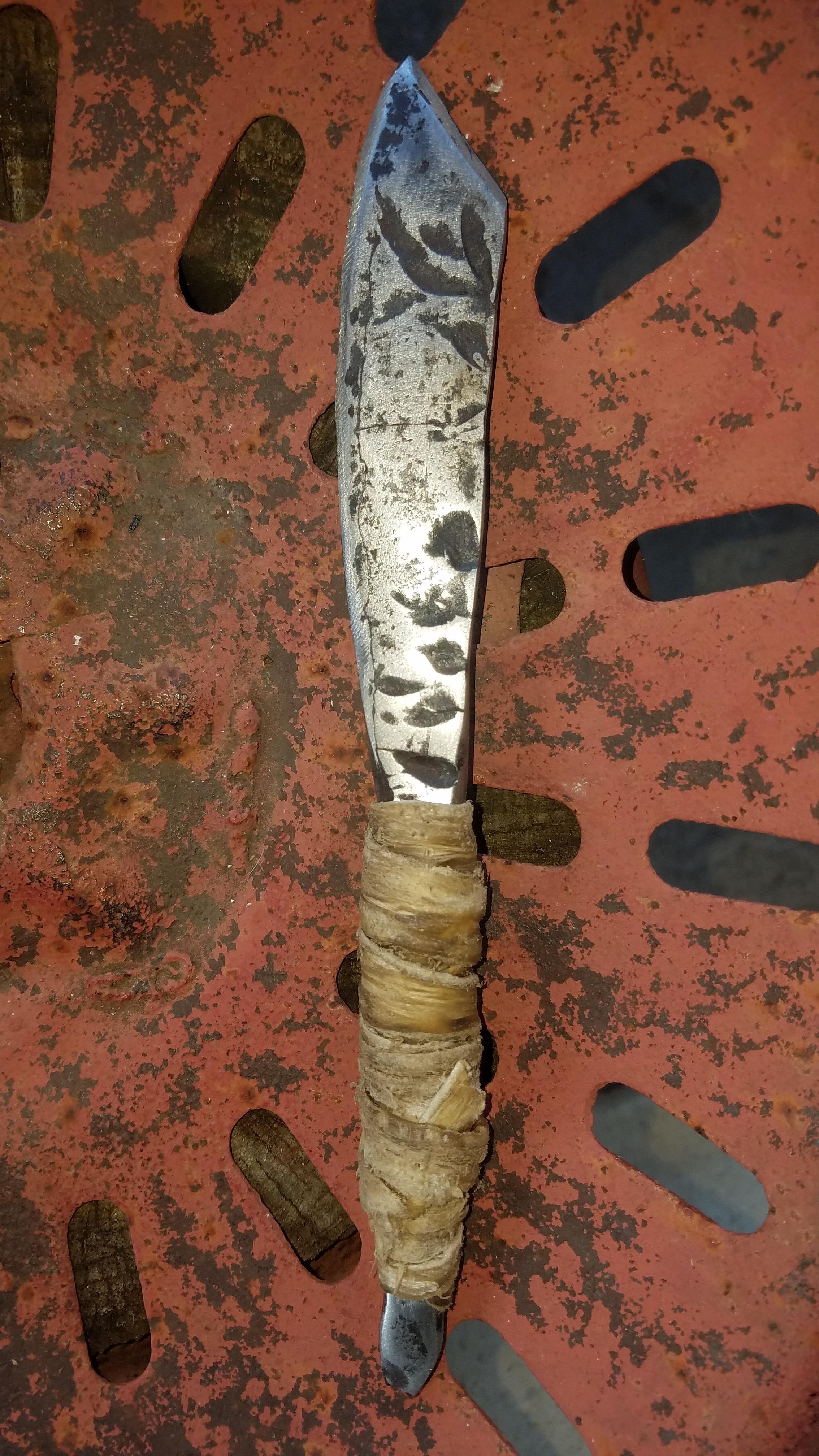

Tommie Hockett Posted August 13, 2017 Share Posted August 13, 2017 Here is mine completed this morning. It was supposed to be a spatula but turned into a knife shaped object.... I will call it a letter opener. It has alot of hammer marks and several cracks. I wrapped raw hide from a deer skin that I tanned last season on the handle. But I am proud of it none the less. But having said that, constructuve criticism is always welcome. Quote Link to comment Share on other sites More sharing options...
ThomasPowers Posted August 13, 2017 Share Posted August 13, 2017 First what is the alloy or what was it made from? Second is your anvil at the correct height OR is your hammer dressed correctly OR do you need more practices to avoid hammer dings? What did you learn from this piece? Quote Link to comment Share on other sites More sharing options...
Tommie Hockett Posted August 14, 2017 Share Posted August 14, 2017 It is hot rolled mild steel. I'm not sure other than that. The salesman at metal mart had no clue what A36 was, he said they had hot rolled mild or cold rolled. As to the next three things. I think I do need to raise the anvil another inch at least. It is about a half inch below my fist when I stand up straight. I think my hammer is ok. My wife isn't having the same troubles with hammer marks. Which brings me to my next topic. I most certianly need to learn to finess the hammer more. My wife says that I am pounding the steel too hard. As for what I learned.... I learned that my hammer technique is terrible and I need to read up on how to move metal. I couldn't figure out how to get it to move in the direction I wanted it to. I also learned that I need to have more patience on everything. BUT I did learn that this is a hobby that I definetly want to persue! I also learned not to stick your tongue out in concentration while hammering... slag really really burns on the tongue haha Quote Link to comment Share on other sites More sharing options...
C-1ToolSteel Posted August 14, 2017 Author Share Posted August 14, 2017 As for improving hammer technique, you really just need to hammer more hot steel, and it will come naturally. Everybody's first project has marks like that if not worse. Dressing your hammer will help a ton if you haven't already. Most any larger hammer you buy will have a very slightly rounded face with about a 45 degree chamfer all the way around. This keeps the face from chipping and injuring the user, but is by no means ready for blacksmith work. Just grind it to a smoth radius instead of a sharp angle, and you will get better results. Quote Link to comment Share on other sites More sharing options...
