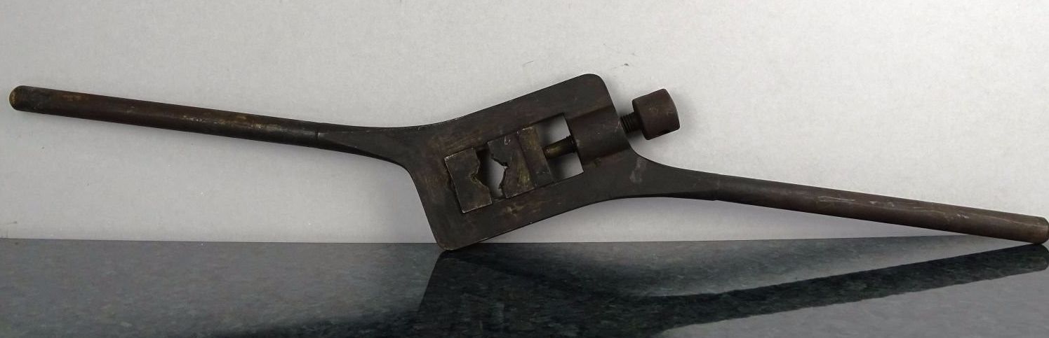

Gergely Posted January 3, 2017 Author Share Posted January 3, 2017 Hi and thanks for all the input! Yesterday I experimented with some spring steel. Was shaping an L from a 4"x3"x7/8" piece. While forming the stem it twisted real nice. I saw it coming just couldn't get any better control, also the shortness of the workpiece made hard to see good alignment. From the same reason the opposite angle correction wasn't possible. Still managed to get it right as I had plenty of mass to deal with: simply forged in the twisted corner lines, and re-established the square cross section. I was pretty happy until I totally messed up punching a hole in it I thought I report in. (Also found a tap wrench like the one in the middle of Alan's picture.) Bests to all: Gergely Quote Link to comment Share on other sites More sharing options...
