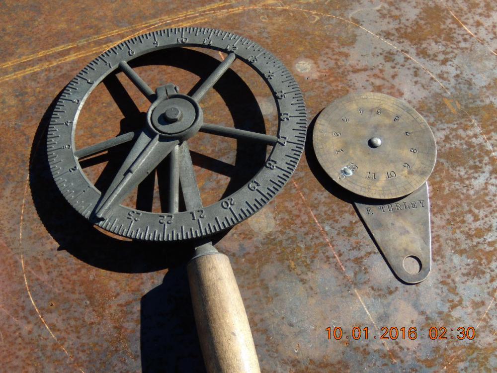

What is this? 2
Looks to be a pulley of some type, similar to ones from the top of a barn for a hay spear
Nope; it's a traveler used by a blacksmith to measure the outside circumference of a wooden wagon wheel so you can then measure the metal needed to make the tyre for it.
search on blacksmith traveler and look at the images...
Do not think it's a pulley there is no groove for the rope.
Yes, I see no groove in looking at it more good call ThomasP, pretty sure it's not the first time I was wrong and pretty sure not the last(just ask my wife)haha
Not rare blacksmith's tool though most folks don't have much call to use them anymore. You start at a designated spot on the wheel with the traveler lined up and run it around the outside edge counting full revolutions. When you get back to the designated spot t=you make a chalk line on the traveler to represent the fraction of a full revolution.  Then transfer that to your piece of metal making allowance for the shrink fit and weld.  Nowadays we tend to just use a tape measure.

Some of the travelers are quite detailed as to the markings on the side for distance. The circumference is well thought out to give a length suitable for the project at hand. The smaller circumferences work for smaller projects, but for a much larger project, they use a larger traveler with a larger circumference. Makes keeping track of the number of revolutions much easier. There is a traveler of sorts that is used in road work (or other distance measurements) that has a projection that contacts a counter once per revolution. You extend the handle, zero the counter, and walk the distance. Read the counter and multiply by the circumference to get the distance traveled. There is a small version of the traveler used in mapping to follow a road and find the distance traveled.

A little more to add. Picture enclosed of my travelers. The larger 24 inch one I purchased a few years ago from an Amish supply place in Ohio. Sorry I can't recall the name. It is probably cast of an aluminum alloy and perhaps lathe turned for accuracy. On the reverse in raised cast letters is, "Pine Creek IN 83850." The small brass traveler was made by noted smith, Tom Bredlow, of Tucson, AZ. Tom showed up at the 1976 ABANA Conference in Carbondale, IL, with at least a half dozen of these to give out as presents. He told me that his grandfather was a tinsmith who made a traveler as part of his apprenticeship, and Tom inherited it, so these that Tom made were apparently duplicates. The traveler is a 12 inch one, very carefully laid out numerically and with what I suppose are etched marker lines. If the lines were chiseled, it would have ruined and distorted the circumference. My traveler is signed and dated on the back. I treasure it.
I've seen a few old, manufactured 24" travelers of cast iron. Of course as noted above, many old travelers were shop made without the numerals. You simply counted the rotations and partial rotation.
The term we use for the median line of a curve is the "neutral axis." This means not to run the traveler on the outside or inside of a curved length, but rather to run it on the neutral axis to get the length.

Remember also that wagon wheels were never round nor exactly the same size wheel to wheel (especially when being re-tired).  A traveler makes much quicker and more accurate work of adapting to these variations than trying to wrap an old-school tape around the perimeter, especially on really big wheels.
