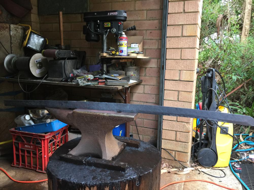

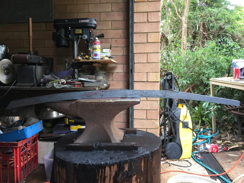

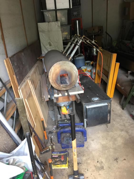

Gorō Posted November 20, 2016 Share Posted November 20, 2016 Some pics of a sunobe I forged today along with another sunobe my friend forged as well at his place Quote Link to comment Share on other sites More sharing options...

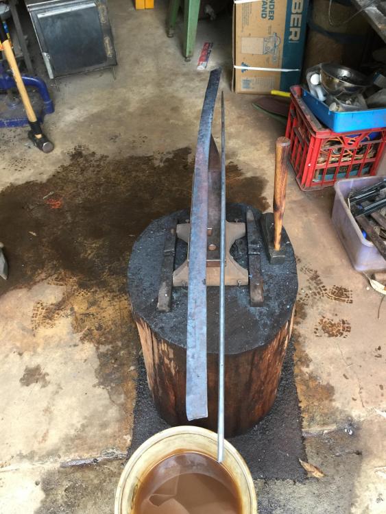

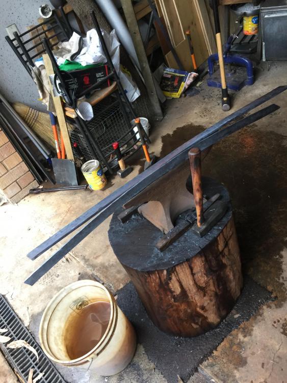

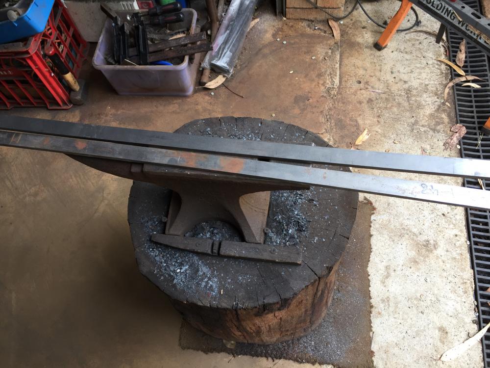

Gorō Posted November 22, 2016 Author Share Posted November 22, 2016 Just made the preform, it's time to do the profile etc first Quote Link to comment Share on other sites More sharing options...

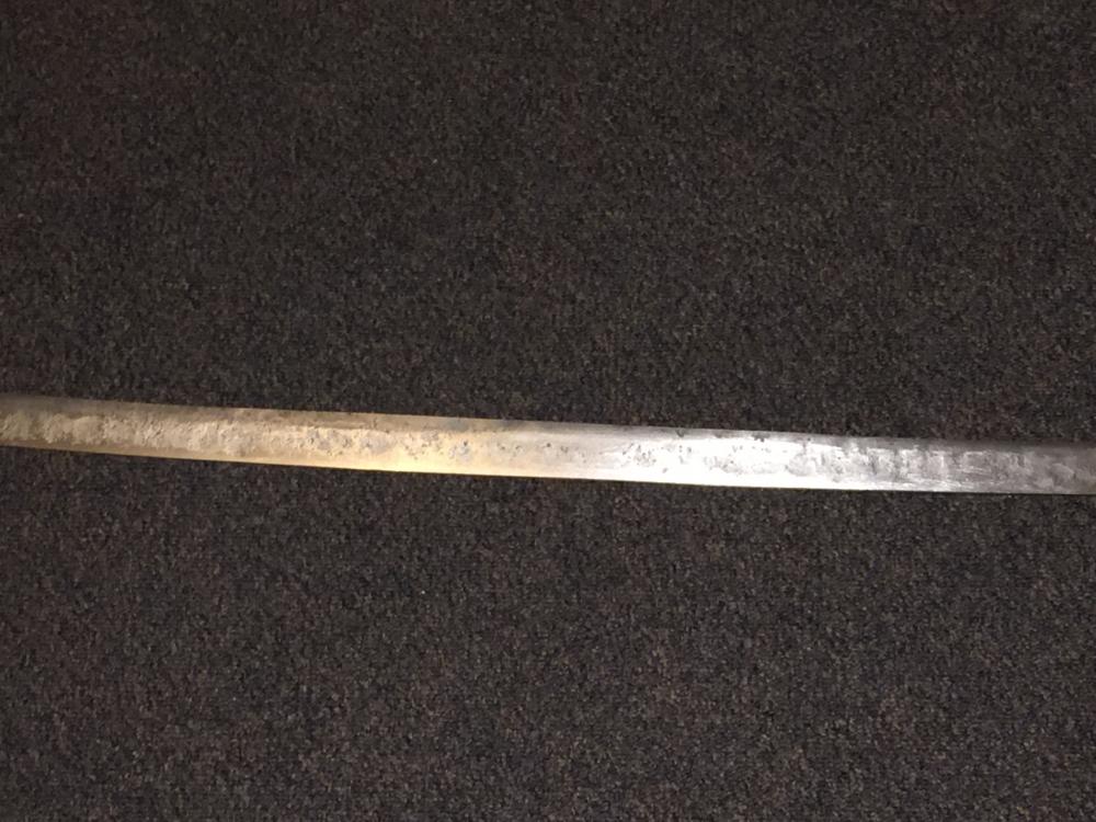

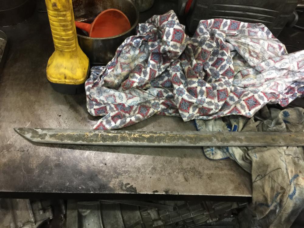

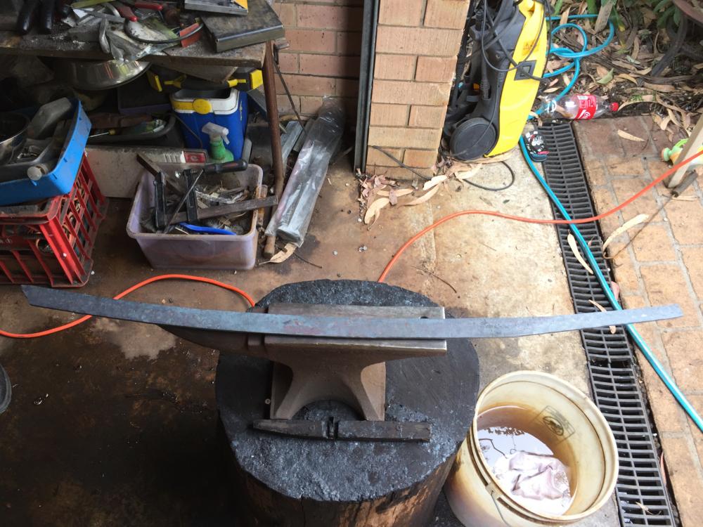

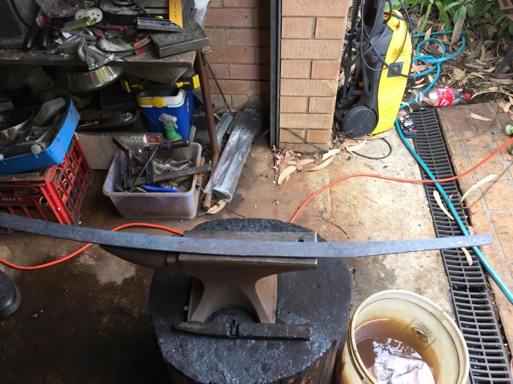

Gorō Posted November 27, 2016 Author Share Posted November 27, 2016 Abit more work on the sunobe for my W2 Shinogi zukuri katana the other one is my friends Hira zukuri katana. Quote Link to comment Share on other sites More sharing options...
JPH Posted November 28, 2016 Share Posted November 28, 2016 Hello: I hate to be a pest but why did you put in the sori? Sori is usually the result of yaki-ire.. (hardening)..that is unless you plan on having a heap load of sori on this or are you using an oil quench (something I do NOT recommend to those starting out due to flame up dangers)... or are you not planning on a Hamon?? Then again what do I know about all of this stuff anyways?? Japanese blades sure ain't my strong suit that's for sure.... JPH Quote Link to comment Share on other sites More sharing options...
JHCC Posted November 28, 2016 Share Posted November 28, 2016 3 hours ago, JPH said: I hate to be a pest but why did you put in the sori? Sori is usually the result of yaki-ire.. (hardening).. I had the same question, although I didn't know the Japanese terms. Quote Link to comment Share on other sites More sharing options...

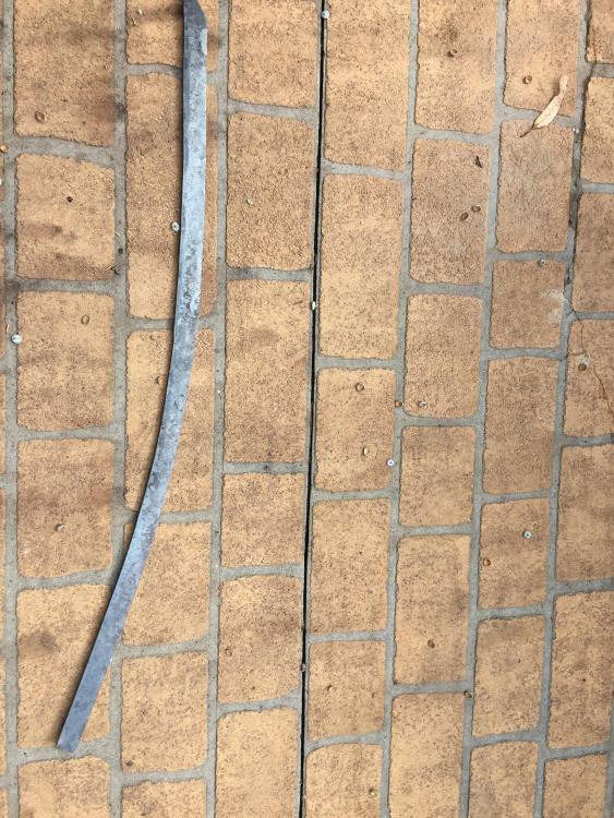

Gorō Posted November 28, 2016 Author Share Posted November 28, 2016 Steel used is w2. The reason for the sori was because i did not straighten it. When I was hammering in the bevels the bar curved and I didn't straighten it. its not finished yet. Just normalised it, not sure if I should use a grinder to take off the scale or just leave it in a acid bath?? Quote Link to comment Share on other sites More sharing options...

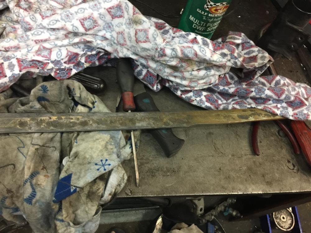

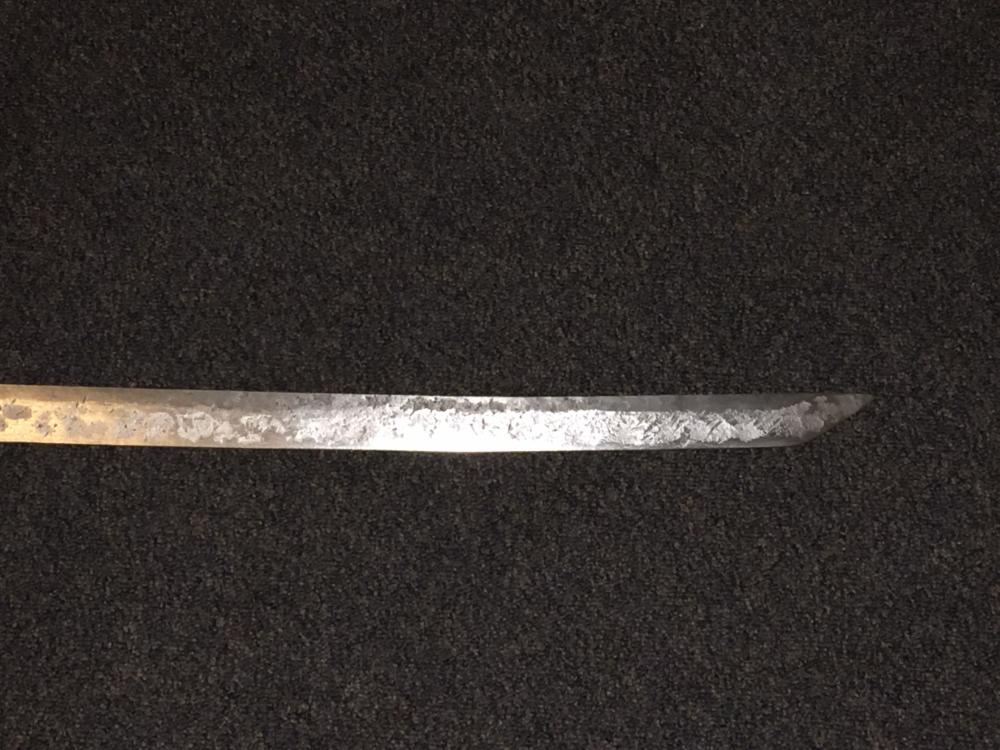

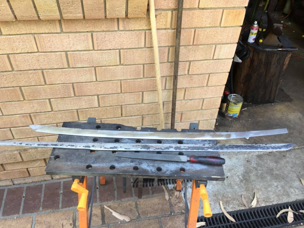

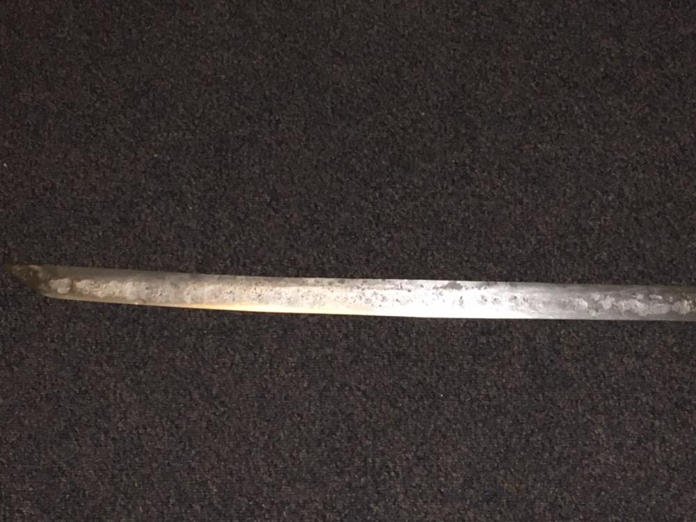

Gorō Posted December 5, 2016 Author Share Posted December 5, 2016 Filing the blades right now to get them ready for heat treat. top blade will be hira zukuri bottom is shinogi zukuri Quote Link to comment Share on other sites More sharing options...
Tubalcain2 Posted December 5, 2016 Share Posted December 5, 2016 how do u plan on doing the heat treat? Quote Link to comment Share on other sites More sharing options...
Gorō Posted December 5, 2016 Author Share Posted December 5, 2016 Not sure yet but definately want a hamon... I just dropped the work peice today whilst filing it. im very paranoid I hope this doesn't affect the heat treat. 3 hours ago, Tubalcain2 said: how do u plan on doing the heat treat? what are your suggestions? Quote Link to comment Share on other sites More sharing options...
Tubalcain2 Posted December 5, 2016 Share Posted December 5, 2016 hamon? u gotta remember i live in tennessee and we don't use those fancy terms here. you'll have to bring your kinda talk down to my level. i've not used w2 so i can't give u much there. dropin it shouldn't mess it up though as long as it didn't crack. Quote Link to comment Share on other sites More sharing options...
C-1ToolSteel Posted December 5, 2016 Share Posted December 5, 2016 1 hour ago, Tubalcain2 said: hamon? u gotta remember i live in tennessee and we don't use those fancy terms here. you'll have to bring your kinda talk down to my level. i've not used w2 so i can't give u much there. dropin it shouldn't mess it up though as long as it didn't crack. What kind of steel do YOU use for katanas. Same steel that I use? Quote Link to comment Share on other sites More sharing options...
Tubalcain2 Posted December 5, 2016 Share Posted December 5, 2016 yeh, sometimes i use zx00 tool steel though. Quote Link to comment Share on other sites More sharing options...

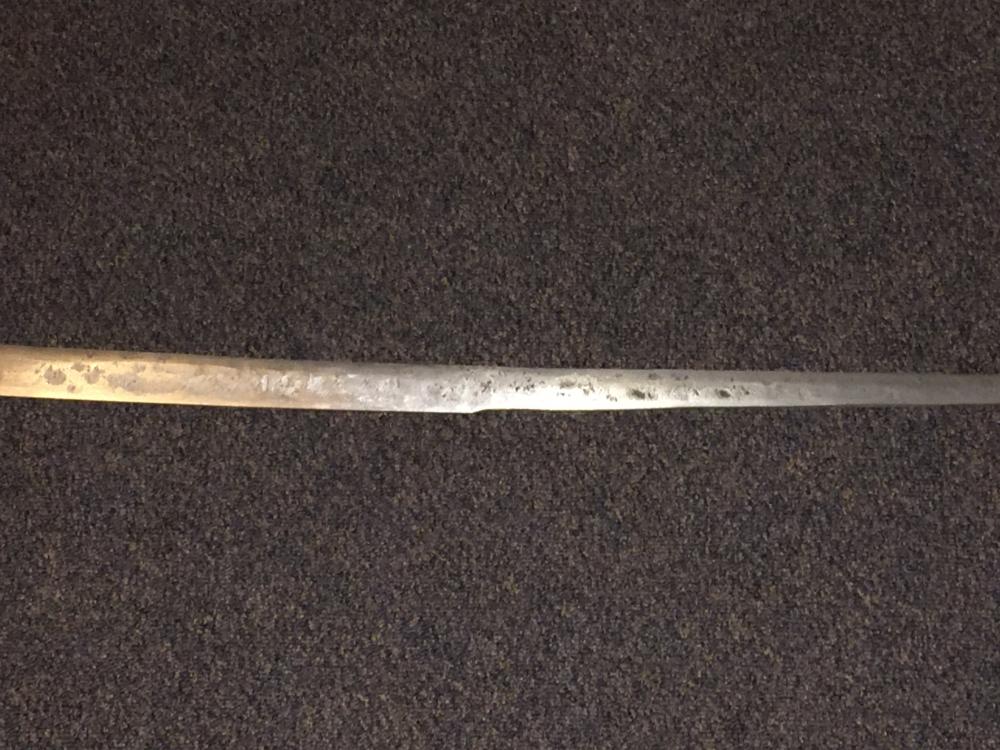

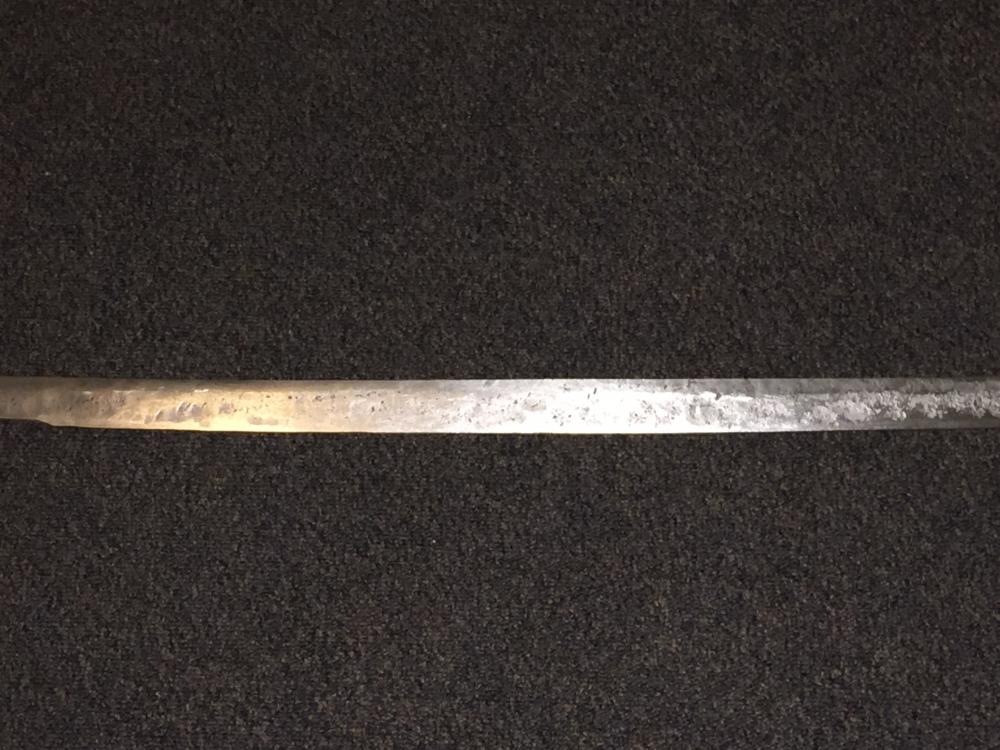

Gorō Posted December 7, 2016 Author Share Posted December 7, 2016 Some more pics after I've left it in a vinegar bath because I had heaps of trouble trying to get the scale off. Not sure if I can finish it before the weekend. If I do I can heat treat it. Been working until late so I have been unable to file it. Quote Link to comment Share on other sites More sharing options...

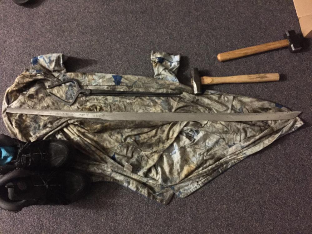

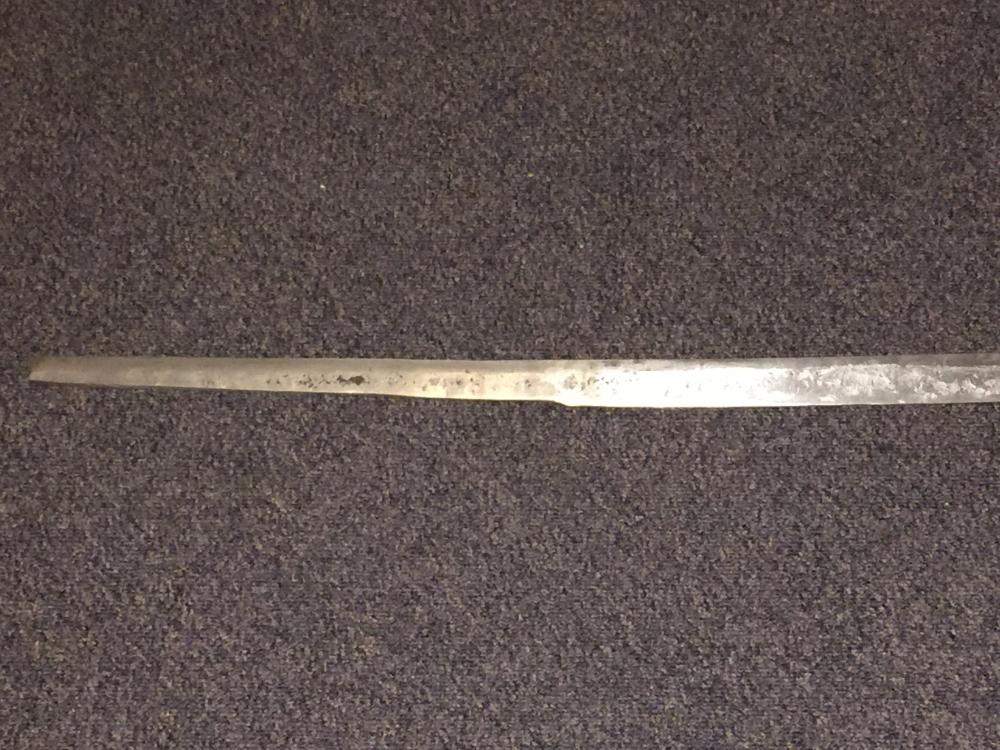

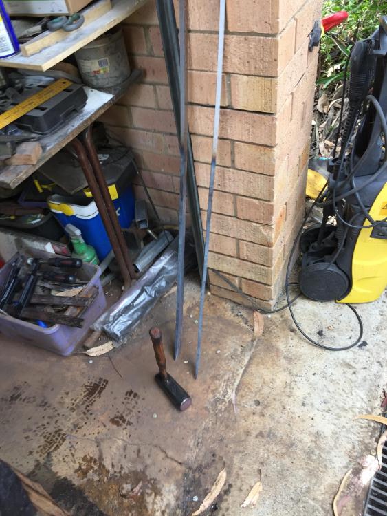

Gorō Posted December 21, 2016 Author Share Posted December 21, 2016 Almost finished filing, I'm hopeful that this will survive the quench. Ive placed next to the sunobe some tools and work boots for a scale comparison. Quote Link to comment Share on other sites More sharing options...
JHCC Posted December 21, 2016 Share Posted December 21, 2016 My very first knife cracked off a 1/4" x 2" section in the middle of the edge when I quenched it -- I don't wish that feeling on anybody! Next time you photograph this, just put it directly on the floor (carpet?) without the rag. It will show up a lot better; the rag doesn't give enough contrast. Quote Link to comment Share on other sites More sharing options...
Gorō Posted December 21, 2016 Author Share Posted December 21, 2016 10 hours ago, JHCC said: My very first knife cracked off a 1/4" x 2" section in the middle of the edge when I quenched it -- How did you quench it? I'm thinking of using water because this is w2. I want to create hamons. Ive got abit of W2 left and some sup9 spring steel that I would love to make a medieval sword out of but yeah Xmas looks so busy. Quote Link to comment Share on other sites More sharing options...
JHCC Posted December 22, 2016 Share Posted December 22, 2016 Water quench, but it was too thin and too hot. Quote Link to comment Share on other sites More sharing options...
Gorō Posted December 22, 2016 Author Share Posted December 22, 2016 13 hours ago, JHCC said: Water quench, but it was too thin and too hot. How many mm was the edge and spine? I'm thinking low 700 degrees celsius for the quenching temperature with hot tap water with dishwashing detergent? Quote Link to comment Share on other sites More sharing options...
