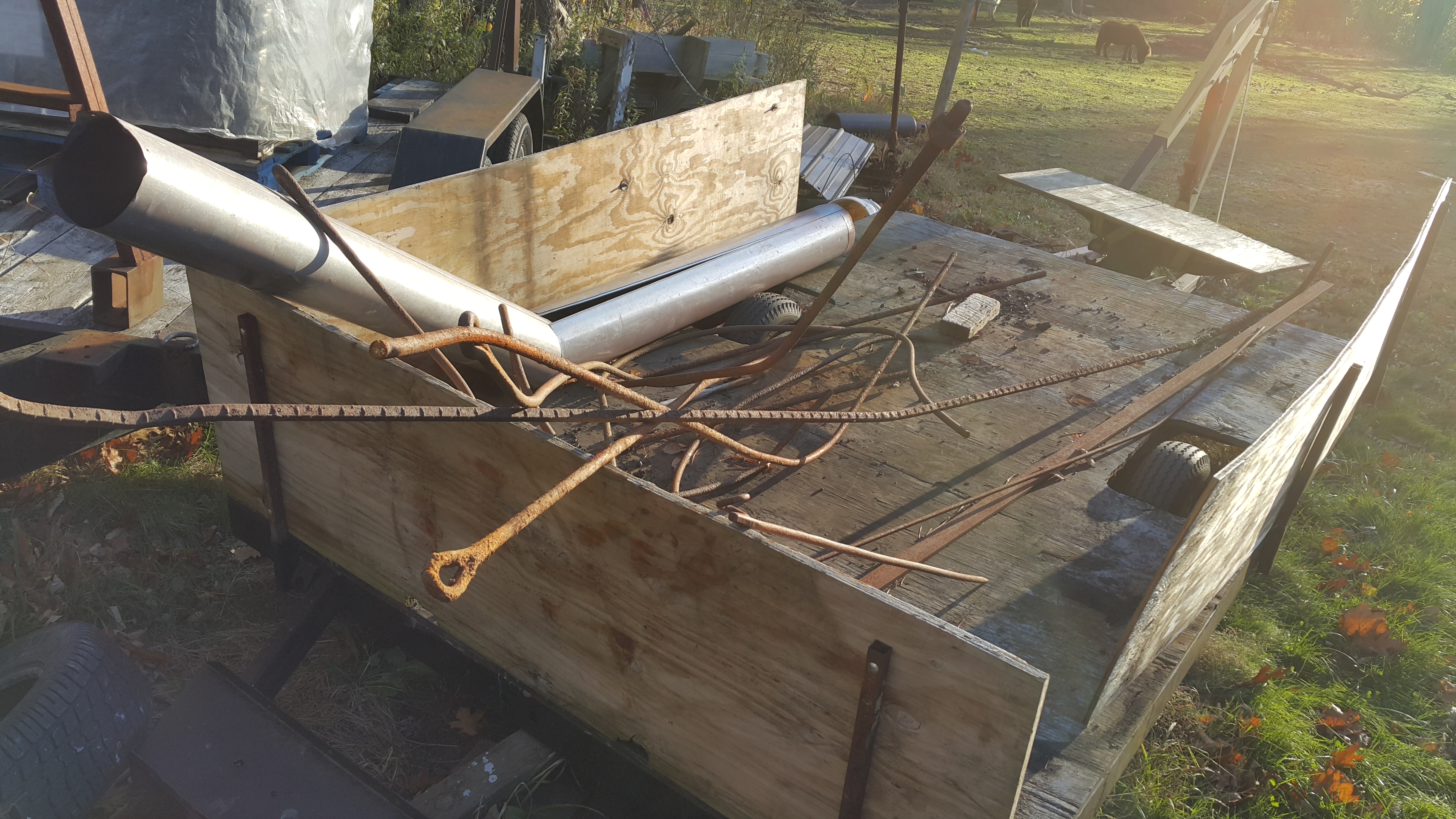

jlpservicesinc Posted October 27, 2016 Share Posted October 27, 2016 BobT, This thread probably turned into a whole different beast than expected?.. Here are some pictures of the wrought iron I stumbled across while out walking.. As mentioned before I believe they were used for rigging for cranes that worked on the Railroad as well as a watershed project by the state.. One other thing about wrought iron.. Overall it's not as strong as mild steel.. Tensions it's only ok. compression is pretty good. But any notch test and it will usually fail.. I had to cut a 3/4" bar to be able to straighten a section and with only an 1/8" notch I could easily break it in 2.. I was going to show some little videos on the difference between forging hot short and cold short as I had a piece that hated being worked hot so much so I think the guys who made it were happy to see it leave the shop.. It was originally used for a loading dock bumper.. Anyhow, after I was done with the majority of trailer making I had a scrapper helping me clean things up and the section (about 2ft long) must have gone with him.. Oh, well.. anyhow heres some pictures of the iron i found and the notch I cut in with the open break.. Quote Link to comment Share on other sites More sharing options...
BOB T Posted October 27, 2016 Author Share Posted October 27, 2016 10 hours ago, jlpservicesinc said: BobT, This thread probably turned into a whole different beast than expected?.. Here are some pictures of the wrought iron I stumbled across while out walking.. As mentioned before I believe they were used for rigging for cranes that worked on the Railroad as well as a watershed project by the state.. One other thing about wrought iron.. Overall it's not as strong as mild steel.. Tensions it's only ok. compression is pretty good. But any notch test and it will usually fail.. I had to cut a 3/4" bar to be able to straighten a section and with only an 1/8" notch I could easily break it in 2.. I was going to show some little videos on the difference between forging hot short and cold short as I had a piece that hated being worked hot so much so I think the guys who made it were happy to see it leave the shop.. It was originally used for a loading dock bumper.. Anyhow, after I was done with the majority of trailer making I had a scrapper helping me clean things up and the section (about 2ft long) must have gone with him.. Oh, well.. anyhow heres some pictures of the iron i found and the notch I cut in with the open break.. On 10/25/2016 at 5:02 PM, the iron dwarf said: plenty here Michael JIP... Good to let people know about WI ..Otherwise most ends up in the scrapyards as plain steel There is a old bridge just setting out in a cow pasture ..it is WI , Has some nice bars that 1 1/2 " Sq 15' in length..I stop by every couple of years to see if the farmer wants to sell it ? The funny part is it not over a creek or ditch..just out in the grass. Maybe some day he will sell it ?? Would hate to see the WI go to the scrapyard . Quote Link to comment Share on other sites More sharing options...
jlpservicesinc Posted October 27, 2016 Share Posted October 27, 2016 50 minutes ago, BOB T said: JIP... Good to let people know about WI ..Otherwise most ends up in the scrapyards as plain steel There is a old bridge just setting out in a cow pasture ..it is WI , Has some nice bars that 1 1/2 " Sq 15' in length..I stop by every couple of years to see if the farmer wants to sell it ? The funny part is it not over a creek or ditch..just out in the grass. Maybe some day he will sell it ?? Would hate to see the WI go to the scrapyard . Yes it is.. Lots of good information here on WI.. I regretfully gave away about a ton of it back when I quite smithing.. Was great quality.. Gave it to a blacksmith friend of mine who ended up with my 200lbs Myers.. If you have a chance to get the bridge.. It would be such a sweet deal.. Most that stuff goes to Scrap here without ever having a chance to grab any as the state projects frown on any civilian approaching a work site.. Quote Link to comment Share on other sites More sharing options...
