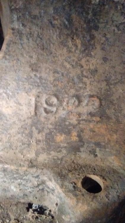

So I have this anvil, and I can't figure out the brand. I know these aren't the best pictures as it was getting dark out. The closeup of what I'm guessing is a logo of some sort is the only marking that is cast in the anvil. No serial number, no company name, nothing. Has anyone seen any markings like this one before?
Looks like the Fisher eagle. So I'd guess a Fisher from what I can see. They are good anvils. If you are looking for any other info I suggest using a wire wheel to clean it up and get pictures in better light.

I had a little extra time today so I did as suggested and cleaned up my anvil and took some better pictures. Here you can see the cast date and the word fisher. Can't decide if the date is 1922 or 1822.... I think 1922. Any ideas on the 15 or the markings on the base in the 4th picture?
The 15 could indicate weight. I've seen fishers marked 10 for 100#, 7 for 70#...So 15 for 150#
That was my assumption but thought I'd ask to make sure. Any ideas on the other markings?
second to last pic. sais Fisher even if I dont see the F in the pic.
Yea I kinda cut the F off but that is what it says. What about the picture before it with the 4 vertical lines then the U shape and 1 vertical line?

The date is 1922.  Fisher did not exist in 1822.
The other markings are codes used in the foundry by the moldmaker to identify who did the mold.  Sort of an early quality control system.   They do not mean anything in terms of anvil quality or anything else.
