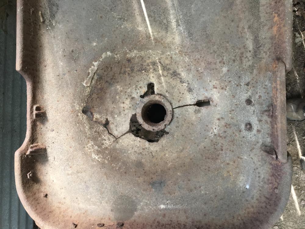

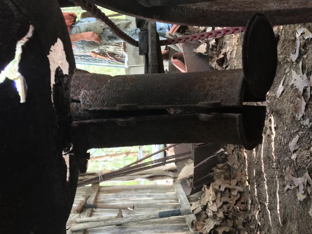

Hello, I recently posted about this old Coal Forge in a previous forum but I was wondering the best ways that I could repair this fire pan and the bottom of the blower here. The piece is pretty rusted and I'm worried that if I try to rebolt the piece together it might break. Any thoughts on fixing? And also lining the pan with clay? What should be the procedure for that?image2.JPGimage1.JPG
Boy, that's a tough one. The fire pot and pan look pretty rough. I'd probably place the fire pot maybe with a brake rotor or maybe I'd turn up something I liked better. I'd do some looking and thinking first though.
The tuyere on the other hand is hard to see in the pic. If it's just loose I'd soak in oil and replace the bolts. However it looks like a crack near the fire pot that might make for a problem. I don't know.
A break router?! And yea that's just a my only next couple of steps.
Also what should I put over the hole?
A popular air grate is round bar stock with a gap between bars like a bar grate. They allow plenty of air flow and are easy to clean with a coal rake. Maybe just bend lengths like hair pins and lay them a little ways apart.
Brake ROTOR is the disk part of disk brakes. The hub is a much better size for a coal forge, drum brakes even the small ones are pretty large for regular sized work.
Alright. Sounds good! So the other thing I want to ask here: can I weld this type of material?
Also if I wanted to line the pan again with clay how should I do that? What type of clay found where?
Maybe to much rust to weld.

what I have seen done over the years for a fix like that is find an old Lg Ox tank cut the bottom off & use that for the fire pot
that means cutting out the bad fire box then welding or using bolting tabs & attach it to the forge
thatS cast iron A PAIN to work with !! you can braze it thats the better Idea or with the right arc rod weld it not so easy !
a plasma will cut cast iron real nice I have done that on mine witch has the same problem ! pan in Good Shape fire pot Not !!
other idea find a cast iron fire pot & fab that to you"re forge pan that what i did
You cannot weld cast iron but it can be brazed which is what I did recently on an old rivet forge that was broke almost in half.
Cast iron can be welded, if you have the skills and equipment.  Most don't.  Brazing is generally a safer method; however for this example I'd go with a mending plate and bolting.
I have done enough cast iron weld repairs to advise not doing it on this project-too much work for what it is.
Drill stop holes at the ends of the cracks, and look for a proper sized brake rotor. Don't overthink this, I have a vintage Buffalo forge that has a sheet metal pan. Claying the pan will help a lot in your situation.
