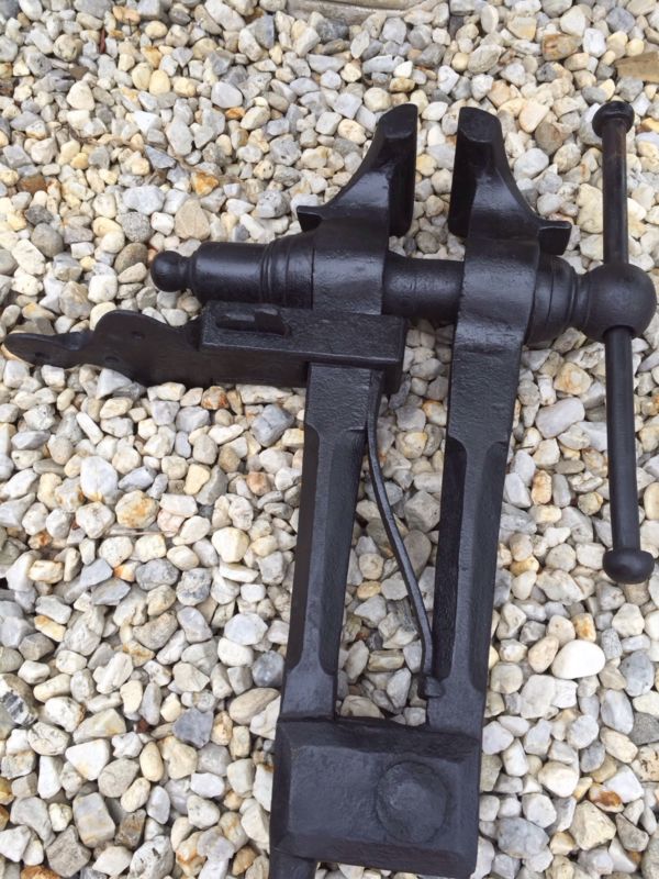

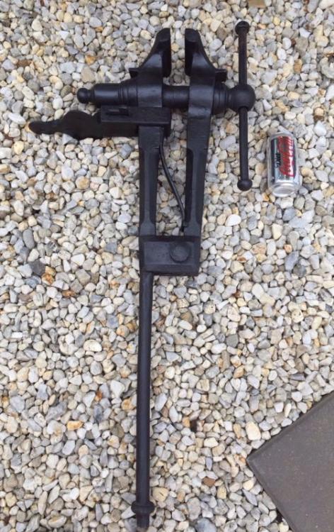

Gorō Posted October 7, 2016 Share Posted October 7, 2016 G'day looking on eBay for anything that is useful and came across some blacksmith leg vises. Found a very nice blacksmith leg vise with no rust and 5' jaws, the seller has told me jaws close but will not open. I've been told it's the screw/bolt or thread box? Cheers Link to comment Share on other sites More sharing options...
jeremy k Posted October 7, 2016 Share Posted October 7, 2016 Most likely just needs a simple to make spring. Hard to tell without a photo. Link to comment Share on other sites More sharing options...
Gorō Posted October 7, 2016 Author Share Posted October 7, 2016 3 hours ago, jeremy k said: Most likely just needs a simple to make spring. Hard to tell without a photo. Always forget the photos sorry.These are the only photos that I have of the blacksmith leg vise, hope it helps. Link to comment Share on other sites More sharing options...

jeremy k Posted October 7, 2016 Share Posted October 7, 2016 Pivot joint is probably tight, spring should open it....spring is intact. Link to comment Share on other sites More sharing options...
Daswulf Posted October 7, 2016 Share Posted October 7, 2016 17 minutes ago, Peter Bui said: Oh ok so we need a close up of the threaded screw area of the vise? Well a good picture of the screw itself. You want to know that the threads are not worn out. 10 minutes ago, jeremy k said: Pivot joint is probably tight, spring should open it....spring is intact. That's probably it. Link to comment Share on other sites More sharing options...
jeremy k Posted October 7, 2016 Share Posted October 7, 2016 The screw typically does not open a vise, the spring does as you turn the screw counter clockwise. Link to comment Share on other sites More sharing options...

Daswulf Posted October 8, 2016 Share Posted October 8, 2016 3 hours ago, Peter Bui said: Biggest problem that I'm buying this online because the vise is in another state. If it was local I could have a better look at it. Maybe take it apart if I'm allowed to . my answer is get them to send a picture of the screw itself. if the screw is good, from the other pics the vise looks good. it'll just need a lil work. a vise screw/box is the most expensive part to fix/replace. Usually not cost effective. Link to comment Share on other sites More sharing options...
jeremy k Posted October 8, 2016 Share Posted October 8, 2016 By looking at the pictures - it has not been abused and used very little - BUY IT - Link to comment Share on other sites More sharing options...
ThomasPowers Posted October 9, 2016 Share Posted October 9, 2016 reasons for not opening: joint is rusted or crudded up with old grease/oil that has hardened; cheeks have been tightened too tight with the pivot bolt, spring needs re-arching; some or all of the above. NONE of these is reason to not buy it as they are all easy fixes. Now the screw/screwbox being in worn shape is a reason to not buy a vise as that is a difficult/expensive fix. Link to comment Share on other sites More sharing options...

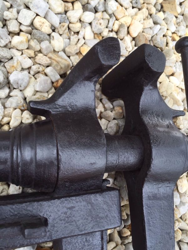

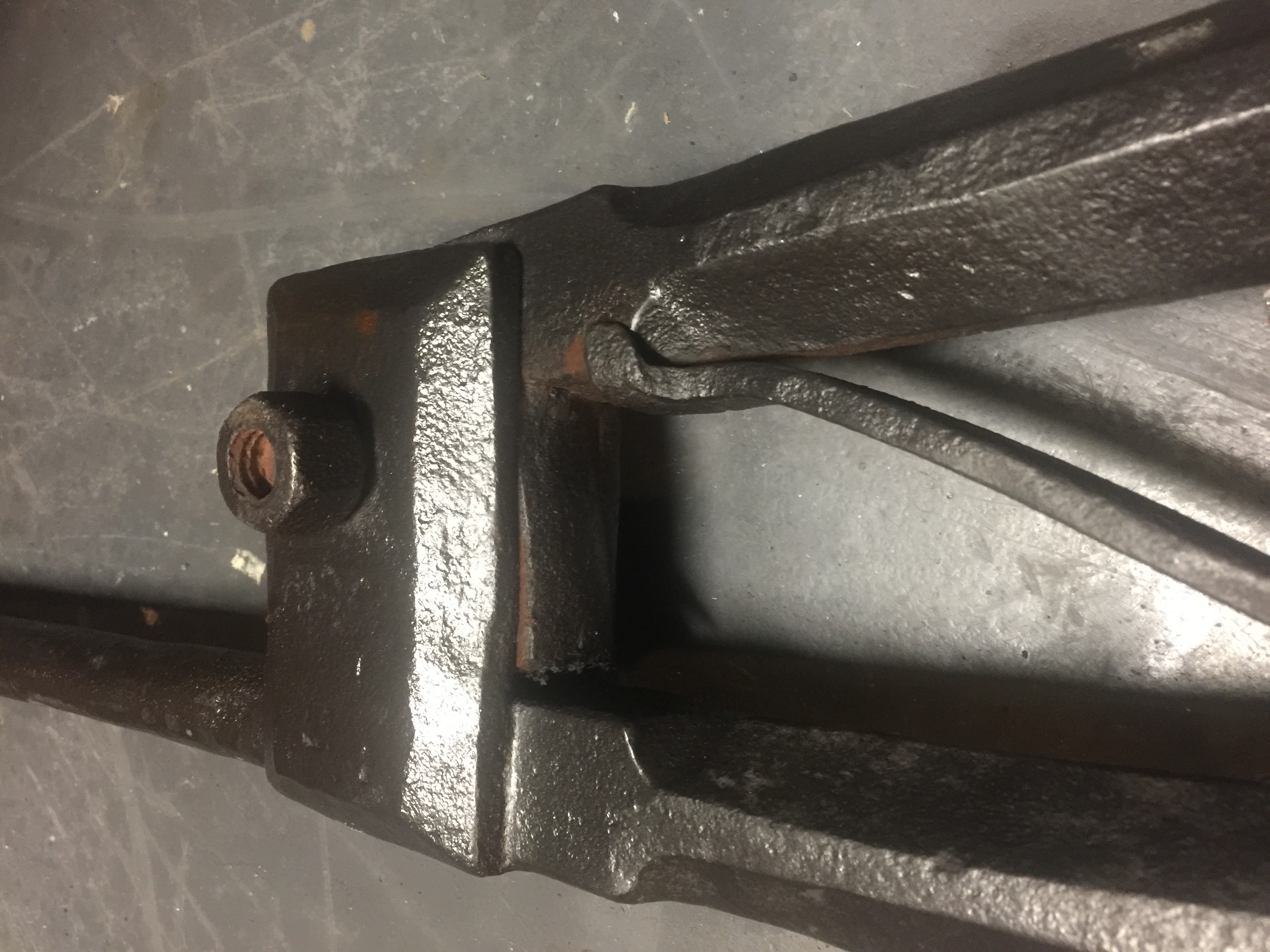

Gorō Posted October 10, 2016 Author Share Posted October 10, 2016 Here are some more close up pictures of the vise Link to comment Share on other sites More sharing options...
Daswulf Posted October 10, 2016 Share Posted October 10, 2016 Ok. Almost looks to me like the pivot bolt isn't seated properly. Usually the rounded head part of the bolt seats into a notch or two to the bracket. I think I see a space and also the nut looks to have been replaced, as far as I've seen they are a square nut there. No big deal on the nut really. But what about the screw? Ask him to wind out the handle till it comes out and get good pictures of the threads. that's the make or break item. Link to comment Share on other sites More sharing options...
