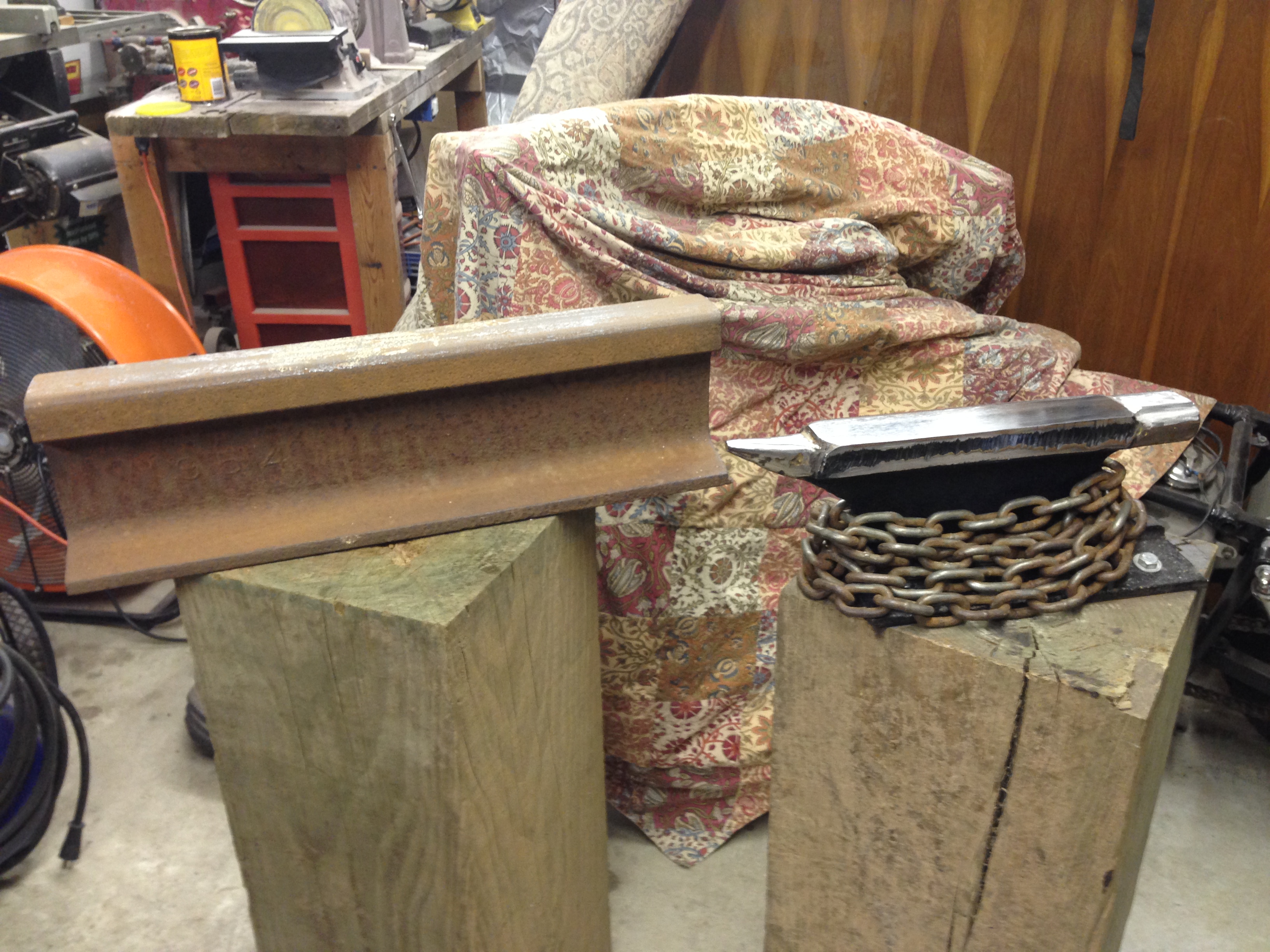

CTBlades Posted September 25, 2016 Share Posted September 25, 2016 Good afternoon. As I stated in my "interduce yourself" post I have a couple chunks of RR Rails that I plan to use for anvils until the day comes when I find and purchase a real deal anvil or three. As you can see by the photo I made a small anvil (on the right) from a 15' piece a couple years ago. Its small for sure but rings nicely and does the job for small work. I recently scrounged up a larger 24" piece that is also 1/2" taller and 3/4" wider. I am interested in hearing what you folks would do with this piece (besides scrap it), i.e. resurfacing, cleaning, stands, fastening it down, cutting, shaping. what ever your thought about it might be. Thanks.....Keep Heatin' & Beatin'. Quote Link to comment Share on other sites More sharing options...
Daswulf Posted September 25, 2016 Share Posted September 25, 2016 Search for "Another Rail Road Iron Anvil" it's a post by Charles Stevens. He made an excellent versatile anvil from one. link... http://www.iforgeiron.com/topic/42290-another-rail-road-iron-anvil/#comment-433693 Quote Link to comment Share on other sites More sharing options...
Frosty Posted September 25, 2016 Share Posted September 25, 2016 And good morning to you. (AK time ) You put a lot of work in the little rail anvil, she'll be a valuable bench anvil. I don't recommend putting that much work into rail anvils it's not really necessary or even useful in the long run. Regardless it isn't a waste of time it's all useful. I see Das just posted my suggestion for the long piece of rail you have. An anvil's efficiency at moving steel is most effected by the depth of rebound it has that's the thickness of steel between the work and the bottom of the anvil. Laid flat rail is designed to be flexible so energy from a hammer blow is dispersed in flexing the rail. Stood on end a hammer blow's compression wave is conducted the full length and rebounds. What energy is lost is to compressing high carbon steel full depth and that compression returns with nearly the same force. You only need an anvil face a little larger than the face of your hammer, it makes it easier to teach new comers proper hammer technique on a small anvil face where they can't chase the stock all over creation. Sorry for the digression, I'm like that you know. Mount it on end at the right height for YOU, radius the edges and grind the web and flanges into what bottom tools you need and you'll have an effective anvil well beyond your expectations. If you need a large flat surface for something, I've found I rarely do except to hold my hammer for the next step, there is 24" of vertical flange and come handsome inside radiuses where the web meets the flanges and rail. Vertical surfaces are much easier to straighten against than horizontal, you can sight right down the contact to gauge where to strike and more important when to stop. Anywho, those is my 7 quatlos. Frosty The Lucky. Quote Link to comment Share on other sites More sharing options...

HoobaJibbs Posted September 28, 2016 Share Posted September 28, 2016 Wondering if I'm even qualified to answer... I beat on a 8 inch long piece of track mounted (a bunch of deck screws around the "foot" and some chain) to a small work table I made. I notice that after sanding the top with 120gr grinder sanding wheel, I can push steel a lot faster and easier than what I had the first couple days. I also rub a little olive oil on the surface to keep rust at bay in humid TX every now and then (probably a sin). Looking at your setup, I'm already jealous. I will say that the RR track is soft-ish, so I'm careful with swinging the hammer full force. I plan to to get an old 100lb (actual) anvil soon, since that's just what I would be personally be satisfied with. Quote Link to comment Share on other sites More sharing options...
