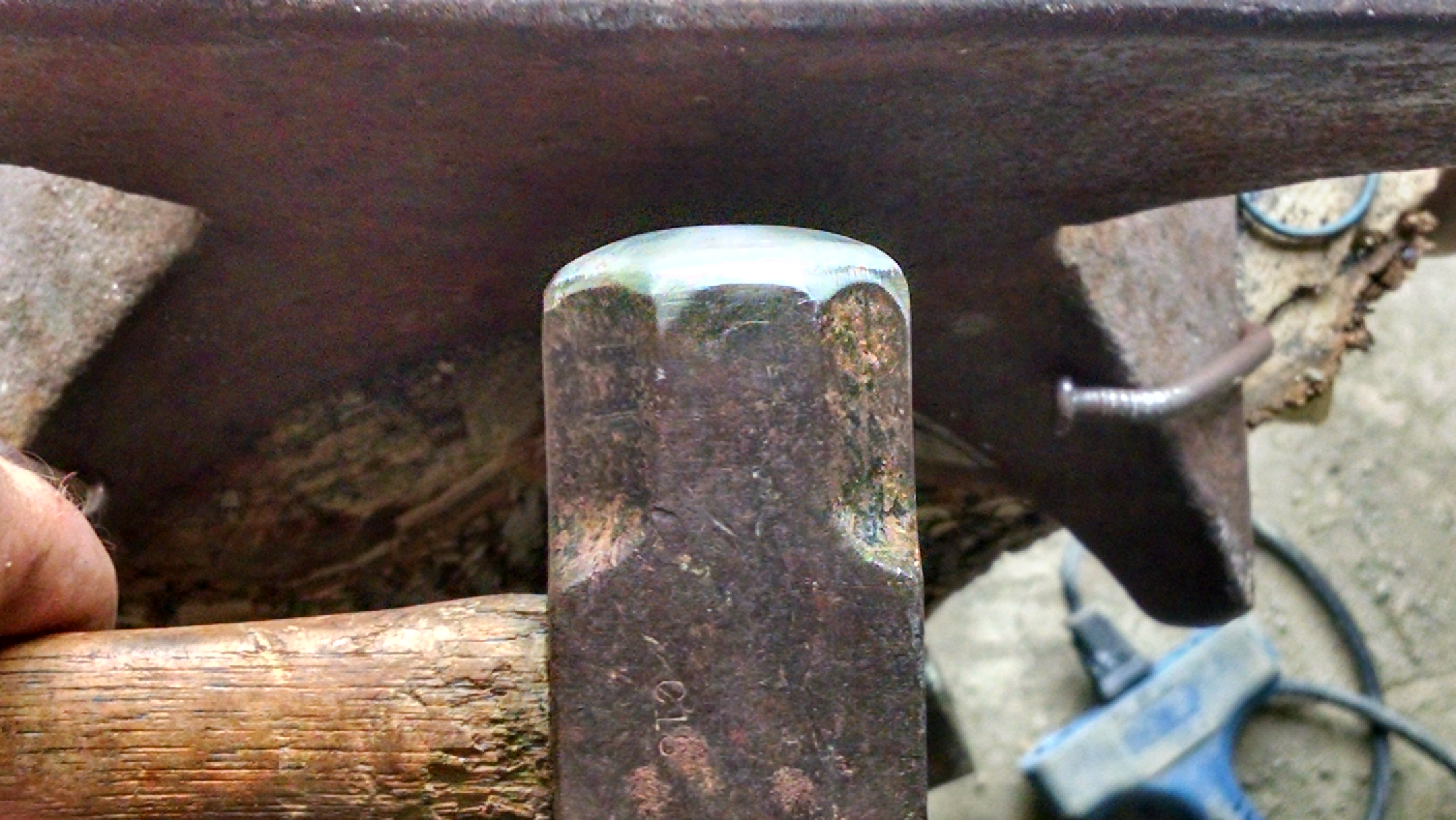

Smitse Posted September 11, 2016 Share Posted September 11, 2016 I recently started making hammers myself, i've made a rounding hammer but struggled grinding the round dye ( in don't have a belt sander only an angle grinder) Any tips? thanks!! Link to comment Share on other sites More sharing options...

John B Posted September 11, 2016 Share Posted September 11, 2016 On 9/11/2016 at 9:46 AM, Smitse said: I recently started making hammers myself, i've made a rounding hammer but struggled grinding the round dye ( in don't have a belt sander only an angle grinder) Any tips? thanks!! Hi Smitse and welcome to the site, if you didn't have a cupping tool to form your dome, you should have forged the rounding end and then finish with a hot file/farriers rasp, allow it to cool slowly to anneal/ stress relieve it and keep the metal relatively soft, so that you can then finish file, and polish to give your required smooth finish, When satisfied, heat treat and then a final finishing polish and buff. If you are going to use your angle grinder you will ned a bit of patience and various grit wheels rough out first with a coarse grit to your desired profile, then a finer grit and finish with emery cloth in increasing grades until your reach your goal. Have fun plenty of tips here on finishing and polishing. Link to comment Share on other sites More sharing options...
Smitse Posted September 11, 2016 Author Share Posted September 11, 2016 Thank you very much! the thing i struggled with was that it shouldn't be a half round "ball" but it should have different radii... but i kept getting a flat spot in the middle i don't know how to get it out in the picture you don't see a half round ball but neither a flat spot. how would i remove the flat spot???? Link to comment Share on other sites More sharing options...
desmato Posted September 20, 2016 Share Posted September 20, 2016 First, that is a NICE hammer, and for a 14 year old to have forged it proves that age means nothing. GREAT WORK ! Joe, Alec, Daniel are all GREAT young-ish smiths that are keeping the faith and carrying on the tradition. I think we need to add "Smitse" to that list. As for the hammer, I use a flap disc on my 4-1/2" angle grinder to profile my rounding "dies". I find the center then with a compass, draw circles on the face and work the wheel in those starting from the edge to create the primary steps so, the outer circle would have the most material removed and at the steepest angle, then move in to the next etc. After I have that all done, I work in multiple directions across the face. draw lines across top like the face of a clock and work the disc across in those directions to take the steps out. Really hard to explain what I mean but I hope you get the idea. Todd Link to comment Share on other sites More sharing options...

JHCC Posted September 20, 2016 Share Posted September 20, 2016 6 hours ago, Smitse said: I was planning on getting a 4 pound hammer and practice to make the round face on there. ( I needed a 4 pound rounding hammer) Good idea. Here's my own 3 pounder, reground to rounding: Link to comment Share on other sites More sharing options...

JHCC Posted September 20, 2016 Share Posted September 20, 2016 Todd's directions are very good, and a flap disc is definitely the way to go. A hard disc will grind flat facets, but a flap disc will naturally tend to round over the edges, especially as you press harder. Link to comment Share on other sites More sharing options...

JHCC Posted September 20, 2016 Share Posted September 20, 2016 Also, make sure you've ground to the profile you want before you move on to a finer grit. Link to comment Share on other sites More sharing options...
