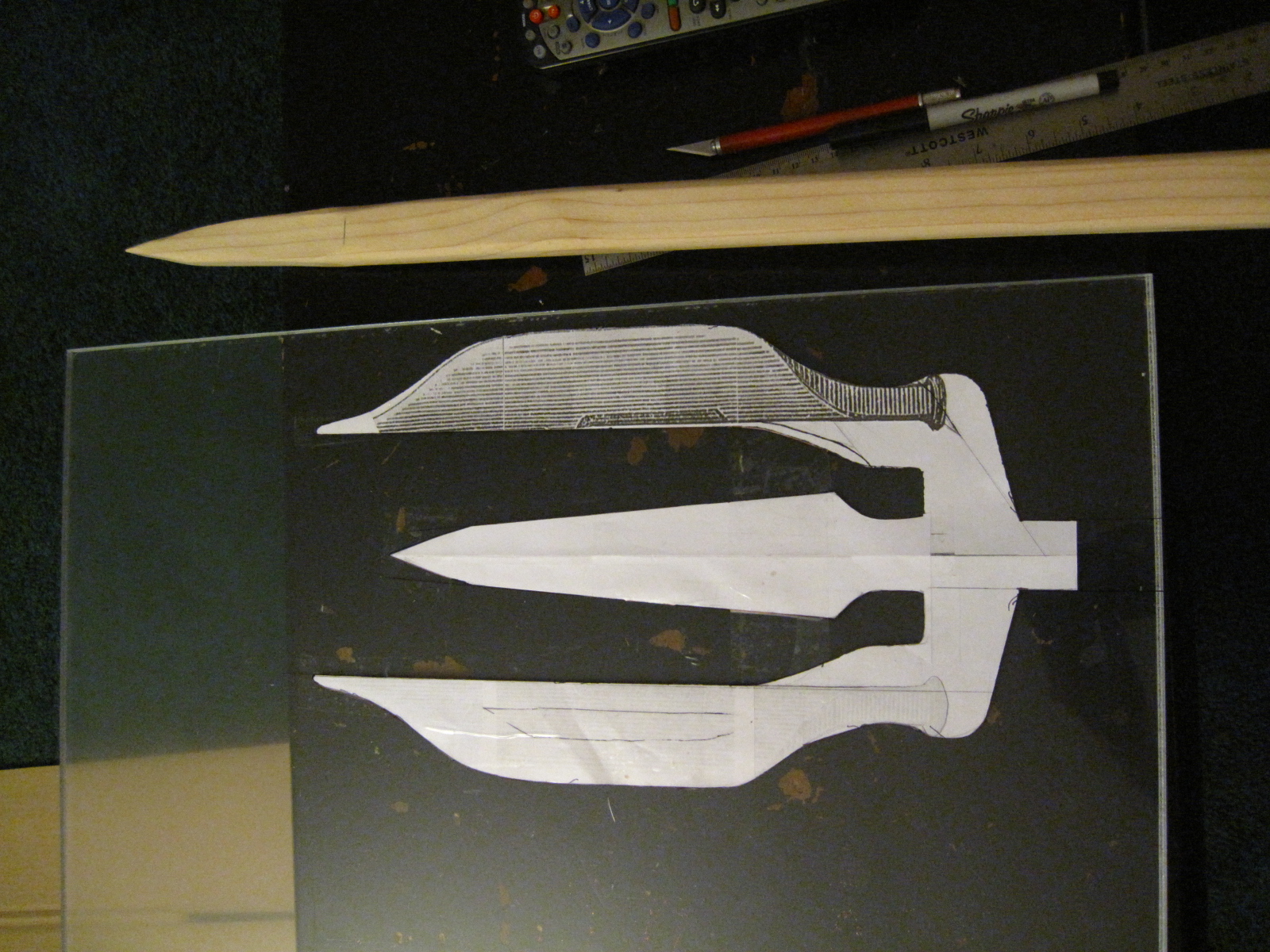

I'm trying to make a quench tank for tridents and it's posing to be a problem. The weapon is 3 tines in a flat configuration. I thought about a big round piece of pipe in the 12" to 16" but there is so much useless space of cold oil to heat up. So I moved on to trying to find a 14" x 3" piece of rectangular tubing that is 4' feet tall. In order to get that piece steel yard wants me to buy a 20' long piece for massive $$$ amount of money. I may have to weld the tank up from angle iron and flat plate, which is a huge project obviously. I looked at some wide U-channel that was 15" wide and the height was 3.5" so if I welded it together I'd get at 15" wide by 7" tall tank.. TOO BIG!
So my question is should I just weld up a custom tank and is 3" wide enough or is it too wide for a trident.  I'd be at 168sq inches of volume. Previous user told me I should be around 5 gallons in my quench. Is that right? There are 231 cubic inches in a gallon so does that mean this tank is not even a gallon or is my math way off. If anyone can help steer me to the perfect tank for this application that would be helpful.
Also since I'm probably going to have to scratch build this is it more advantageous to use stainless or aluminum than steel?
this image is what the proportions roughly look like.

I couldn't see the image you posted, but it sounds like you might be going overkill on this thing.  All you need is something that will hold oil to the depth and width (plus a little) you want to harden the tines and possibly part of the shaft.  Just off the top of my head, you might be able to get a large muffler with close to the right dimensions.  Obviously you'd have to cut one end off, take out the internal stuff, and block the exhaust port on the remaining end, but that should be a much cheaper option if you can find one large enough and you should be able to tack weld it to something for a base.
How much do you really need to quench?  I would think the barbs and a bit back and the rest of it would be *better* normalized---so a quench trough rather than a tank.  Piece of pipe with a bit taken off the top to provide a slot. Weld on square end caps so it sits stable on the floor.
