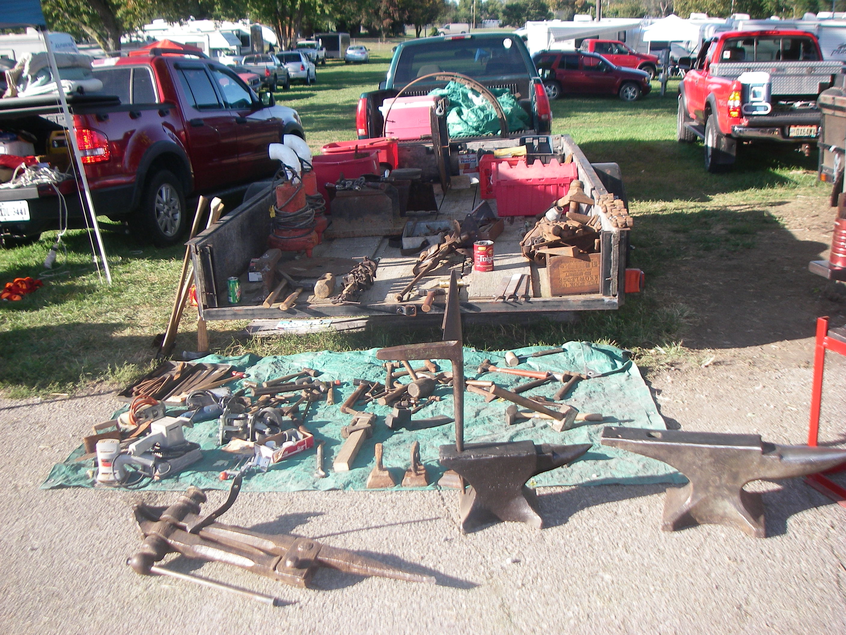

Quad-State Blacksmiths Round-Up, last full weekend in September in Troy Ohio, USA; largest annual Blacksmithing conference in the USA if not the world and full of people selling or trading stuff as once you've paid entry anyone can sell as well as attend the multiple demo's going on   I'm driving about 1500 (each way!) miles to attend

shapeless red felt hat with horns and on Friday, weather permitting, lederhosen and an aloha shirt...other than that Glasses, middle aged, portly, bearded---just doesn't narrow it down much  Oh Yes during the official event my Nametag saying Thomas Powers is a dead giveaway...
