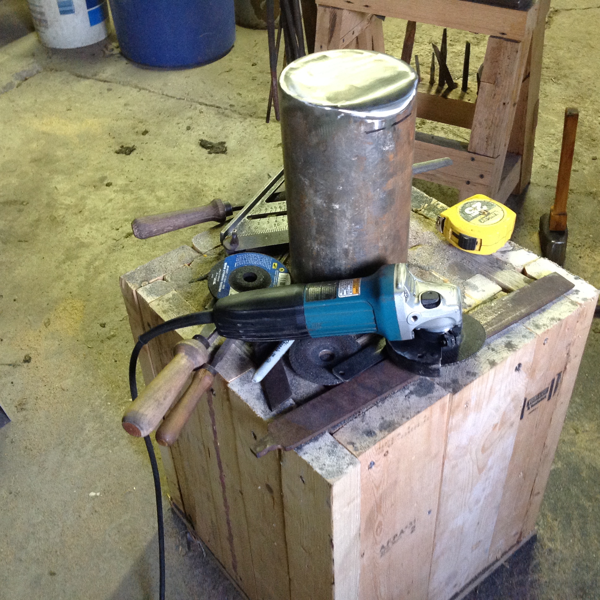

August 11, 20169 yr The more I use my post anvil the more I like it. I'm not saying I'm not looking for a London pattern anvil but it would have to be a deal!!! Don't sell those bucket pins short. An hour with the grinder and your ready for the hammer and some hot iron. It's been an economical way for me to start.
