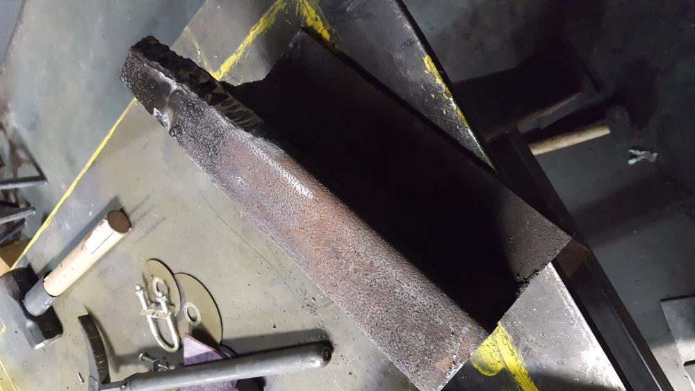

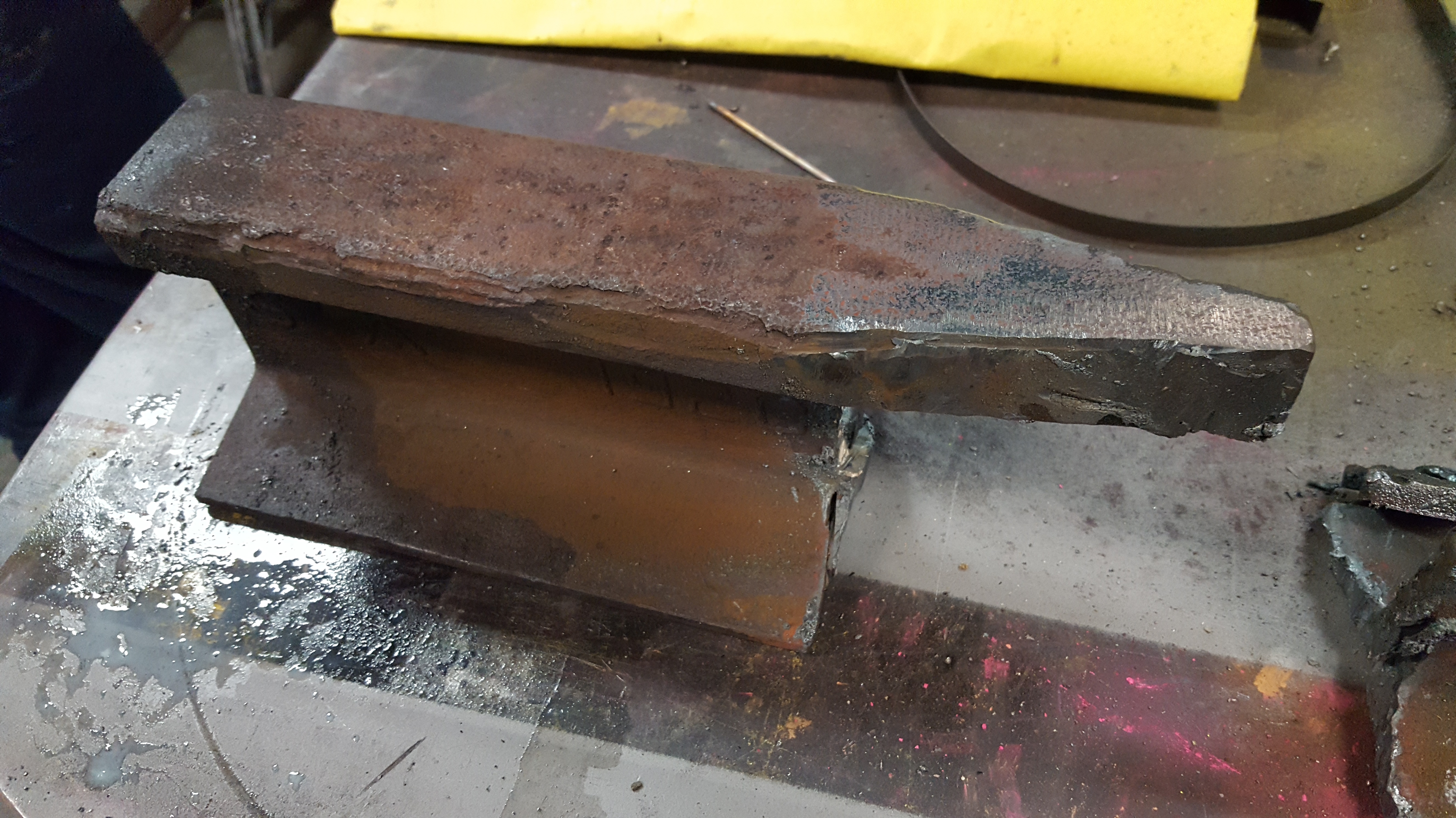

  4. I live in Morristown. After getting a piece of it cut into two smaller anvils with different horn sizes I think I'm not going to weld anything on top of it. After reading a lot about turning the rail straight up on its side I stumbled across an image of an anvil cut out of a piece of rail, welded to the top of a rail on its side. That's my next attempt. For now I'm going to use what I have. I'm learning as I go. Thank you for the advice! I was able to get the rail for free and cut at work for nothing. I know eventually I'll get a real anvil but I hope this will help me get started.
  5. So I'm sure this is gonna cause quite a stir, but please be gentle, I'm new to blacksmithing. I can't afford to buy an anvil right now, but I was able to obtain, legally, several pieces of railroad rail. As shown in the pictures I'm planning on cutting one piece in half to make two anvils as an experiment. I've read about people using a leaf spring and welding it on top for the flat and hardened surface, then throwing it in a fire to slowly heat up and then dropping in water to harden. I guess my question is, I also obtained a piece of steel they use to attach the rail to the tie. It has square holes already in it, and it the length of my anvil from the horn to the end of the face. Can I use this in place of the leaf spring? Later on I plan on cutting another piece in half and welding the two pieces together to form a wider anvil, with a piece of hardened steal welded on top. I forgot to mention I plan on using one of the square holes hanging off the back side of the anvil as a hardy hole. That way I don't have to drill any holes into the rail itself.
