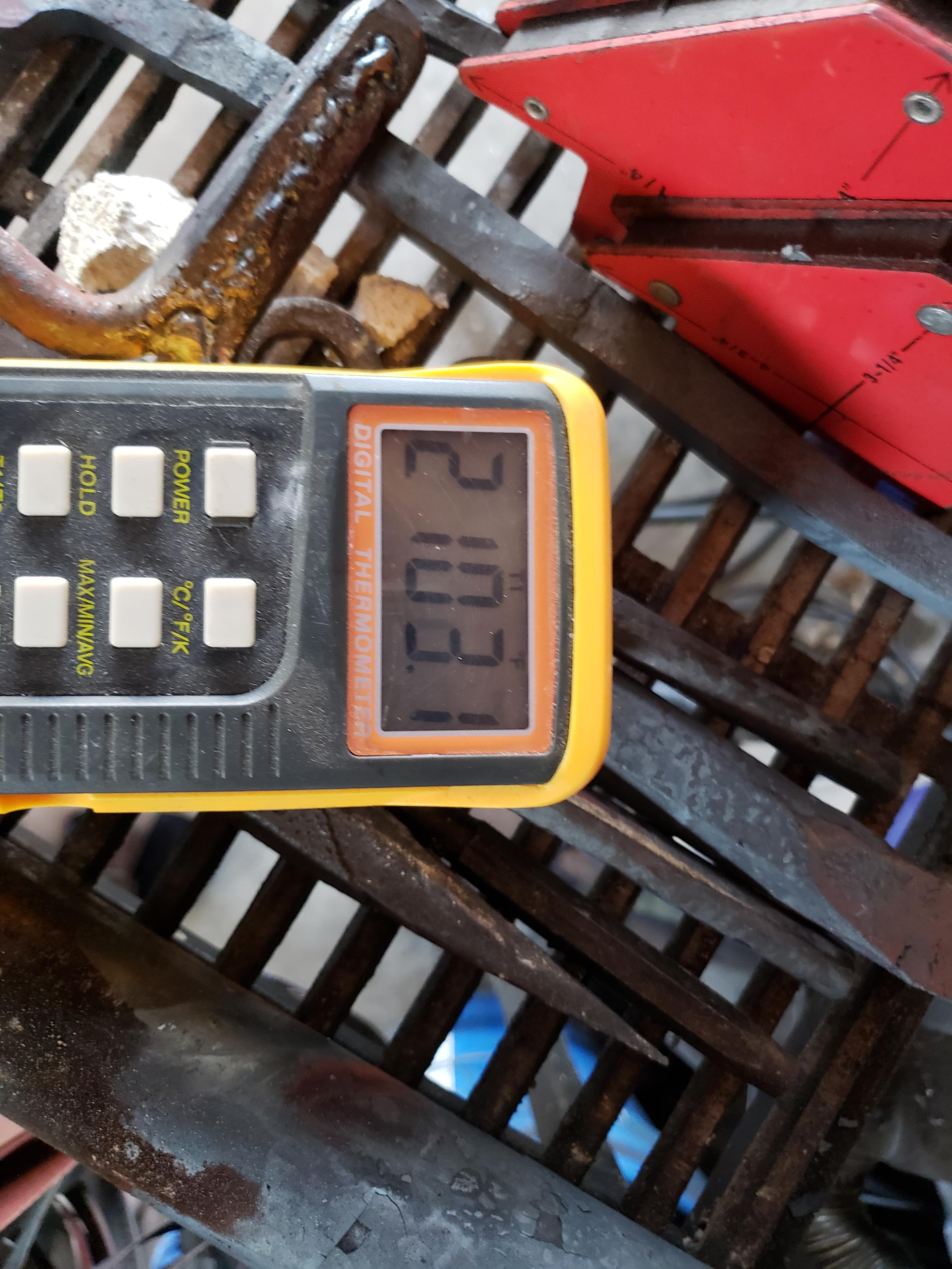

VainEnd84 Posted November 18, 2018 Share Posted November 18, 2018 At Mikey’s request I am posting a build of my forge. This is iteration 1.5, I built the original a while ago and was not getting the type of performance was expecting and indeed hoping for. I will start with a supplies list and then get into some of the specifics as well as some photos and video of it running. The body of the forge is an auxiliary compressor tank, 9.5" diameter and 16” long. I cut a roughly D shaped opening in either end, and left the flap attached to on of the ends, originally this was supposed to support the stock, but I found that is served much better as a place to have a firebrick to close off the back. I then decided to add an extendable front stock support. The body is tack welded to a section of sheet metal which sits on the forge stand. The body is lined with 2 layers of 2600F rated 1” ceramic blanket, which has been rigidized and coated with ~1\4” of castable refractory, that is similar in composition to plistix. The floor of the forge has ~1\2” of a bubble alumina castable refractory, and the whole interior was then coated with a kiln wash, the kiln wash was supposed to add an additional hard facing layer as well as be resistant to flux, but it froze overnight after applying it and the layer crackled, so it has some small protective ability against physical damage it doesn’t do much else unfortunately. The burners are two ½” T-burners built (finally) to Frosty's specific specifications. ¾” run with a ½” branch. And a .23 mig tip that has been trimmed down, the mig tips are mounted in a drilled and tapped flare fitting with some pipe dope in the threads to prevent leaks. The flare fittings are screwed in the top of the pipe T which has been drilled and tapped to the same thread pitch as the threads on the exterior of the flare fitting, I used a steel washer as a spacer between the flare fitting and the pipe T as the threads on the flare fitting don’t bottom out and when screwed into the T would wobble. The flare fittings are then connected to gas rated ¼ turn ball valves which are connected to a common supply point by some very ugly if functional plumbing. I have a 0-30psi adjustable regulator at my tank. The burners are mounted to the forge using some 1 ¾” pipe that have two conduit locking nuts (one inside the forge shell and one outside) to hold it in place. I formed a nozzle on the interior of the forge using a wooden form(turned by a friend of mine) to hold the castable in the correct shape. While writing this the temperature here has dropped to -16C so when I fired it up for the purpose of taking some pictures and video, I wasn’t getting great performance as my tank started icing up pretty quickly. This is a video of the forge running, the first half is at 8 or 10 psi, and the second half is at 1.5psi https://youtu.be/j1j43lz2sEE Next are some photos of it running at about 3-4 minutes intervals, as well as photos of the thermocouple showing the temperature reached. The last photo shows the forge running at 1.5psi and the temperature it holds with in a 5F range. Overall, I am quite happy with this forge, it does have hot spots as it heats up but the even out fairly well as the forge runs. I couldn't get it up to its max temp, or atleast the max temp I've run it at due to the xxxx winter here. Here I have attached a photo of what it did to the jackhammer but that sat in the forge for about 15 min running at 12psi on a warm day. Quote Link to comment Share on other sites More sharing options...
VainEnd84 Posted November 18, 2018 Share Posted November 18, 2018 Another thing to note, is that the mixing tubes that are currently installed are overly long, I haven't had time to shorten them yet. Quote Link to comment Share on other sites More sharing options...
Mikey98118 Posted November 18, 2018 Author Share Posted November 18, 2018 Thanks for posting your forge; I especially like how hot it gets with the two 1/2" T"" burners. Quote Link to comment Share on other sites More sharing options...
Frosty Posted November 18, 2018 Share Posted November 18, 2018 On 10/28/2018 at 4:20 PM, Mikey98118 said: And how did you decide what was good for you? It burns off 1/2" stock before I get bored waiting. I usually turn it down though, I don't drive with my foot to the floor either but it's good to know it's there if I need it. Good one Thomas but the northern lights only get one vote just like the other voices. Frosty The Lucky. Quote Link to comment Share on other sites More sharing options...
