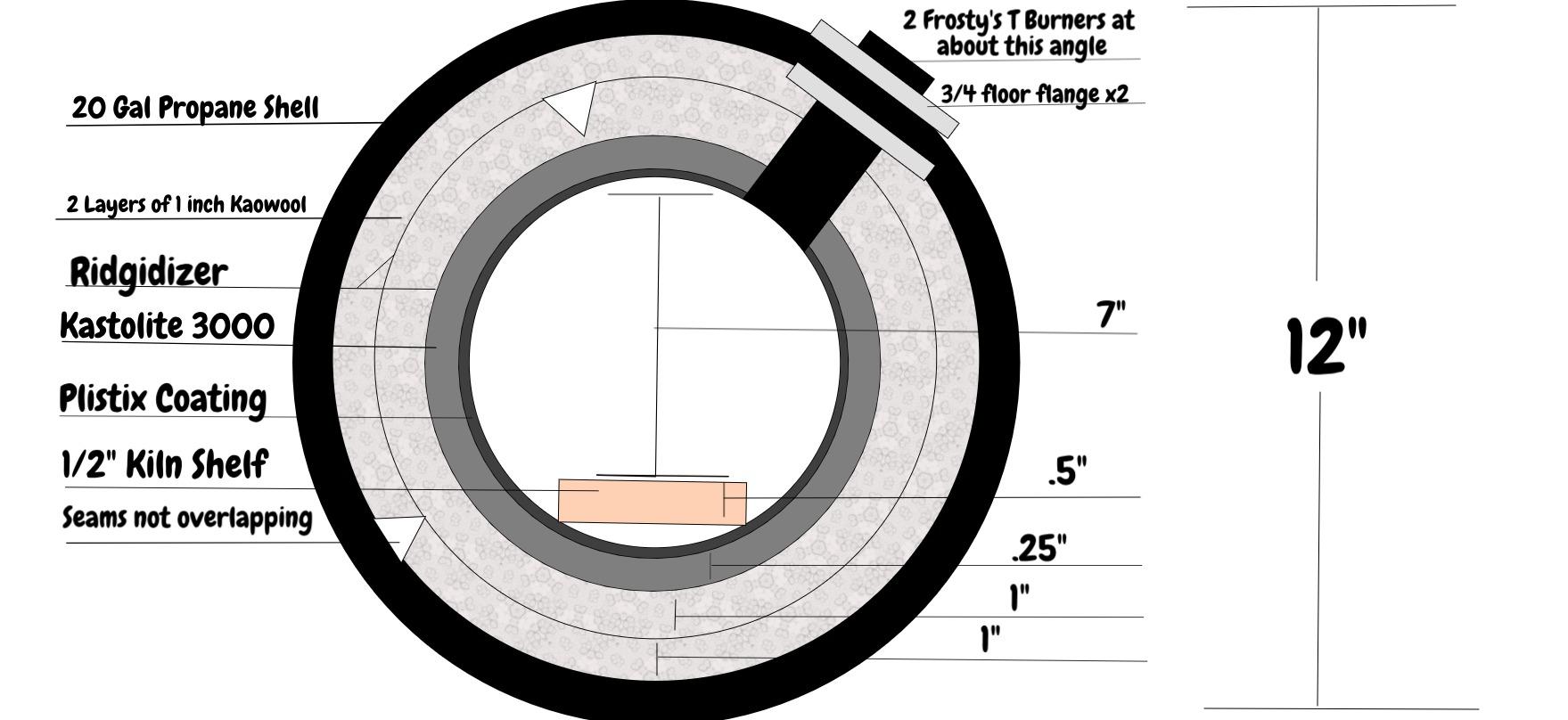

Thursigar Posted November 29, 2018 Share Posted November 29, 2018 I've been reading this topic, burners 101, wayne's website, and Zoellers website trying to wrap my head around building a forge. I think I get the general concepts, but am unsure of the some of the details. My skills arent as good as b1llvance, but I did do a sketch of the design I have in my head for a 20 propane tank forge. Here are my questions: 1. Is 1/4" castable refractory a good measure? I've seen everything from 1/8" to 2 inches. My understanding is the prupose of the refractory is to protect the ceramic blanket, add durability, have a good surface to apply IR reflective, and make it thin so its not too much of a heat sink. 2. Welding isn't an option for me. So when I cut the top off the top off to be able to insulate, will a hinge bolted on work? Or will any holes in the frame cause issues? Same with bolting legs on? I considered just bolting down two iron angles and placing it between them. 3. Once again since welding isnt an option, will 3/4' floor flanges secure a frosty T burner? 4. Should I incluse the .5 kiln shelf into the equation for space-burner ratio? I assume no but my shelves wont be a snug fit either. 4. Notice any other flaws how I am picturing this design in my head? Thanks for all of your help. And Mikey, I LOVE the well-written tidbits! Quote Link to comment Share on other sites More sharing options...
b1llvance Posted November 29, 2018 Share Posted November 29, 2018 Thank you all for the feedback. Daguy- I had read your thread before and watched the slo-mo videos. It's a great build, and thank you for sharing. The biggest reason I was looking for a different burner placement was I didn't like the idea of the face of the burner heating so much and the heat creeping back into the plenum. I know Frosty solved that problem by increasing pressure, and in all reality I most likely wouldn't be using the forge for long enough periods for it to be an issue, I was just trying to build in a structural fix. Mikey- Thanks for all of the replies and information. Originally I wasn't worried too much about flux debris, as I'm so new to this I didn't figure I'd be doing much forge welding, but I should probably assume at some point I'm going to want to give it a go. It took me a while to get the hang time/complete combustion/swirl right in my mind so I appreciate you sticking with me on it! Thursigar- Your sketch looks great. The labels are way better than the way I wrote it all out to explain it. I'm sure the other guys will chime in here but I know I've read Mikey say he's never had issues with pop rivets and bolts whereas welds can sometimes be problematic. Quote Link to comment Share on other sites More sharing options...
Thursigar Posted November 29, 2018 Share Posted November 29, 2018 I would edit my original post, but I am struggling to see if that is possible...I've obviously misnumbered my questions. 6. Anywho, I know that the burner isnt suppose to go INTO the forge itself, but I guess I made an assumption about exactly where it ends. I know you can create a "flare"-like effect using the kastolite, but how far into the kaowool or kastolite should it be inserted since there is potentially 2 inches of material? Im thinking perhaps my plans were off and I should move it back to just past the first layer of kaowool (to protect the shell) so that it has a chance to flare out? 7. I've read lots of items regarding burner angles, and how its suppose to hit a durable surface (which is why Im using a kiln shelf). I am currently aiming for the outer edge of the shelf as not to create a hotspot on it. But I've now read that other people LIKE the hot spot effect to better target areas of a peice of metal for bending etc. I think that makes more sense? 4 hours ago, b1llvance said: Thursigar- Your sketch looks great. The labels are way better than the way I wrote it all out to explain it. I'm sure the other guys will chime in here but I know I've read Mikey say he's never had issues with pop rivets and bolts whereas welds can sometimes be problematic. You are too kind. Thank you for Mikey's thoughts on bolts behind the kaowool. Quote Link to comment Share on other sites More sharing options...
Irondragon Forge ClayWorks Posted November 29, 2018 Share Posted November 29, 2018 Your diagram looks good to me. I would go with 1/2 inch of Kastolite. Of course as my wife says about my over building things, 2 nails are good so I use 4. BTW the edit feature is only active for a half an hour. Quote Link to comment Share on other sites More sharing options...
