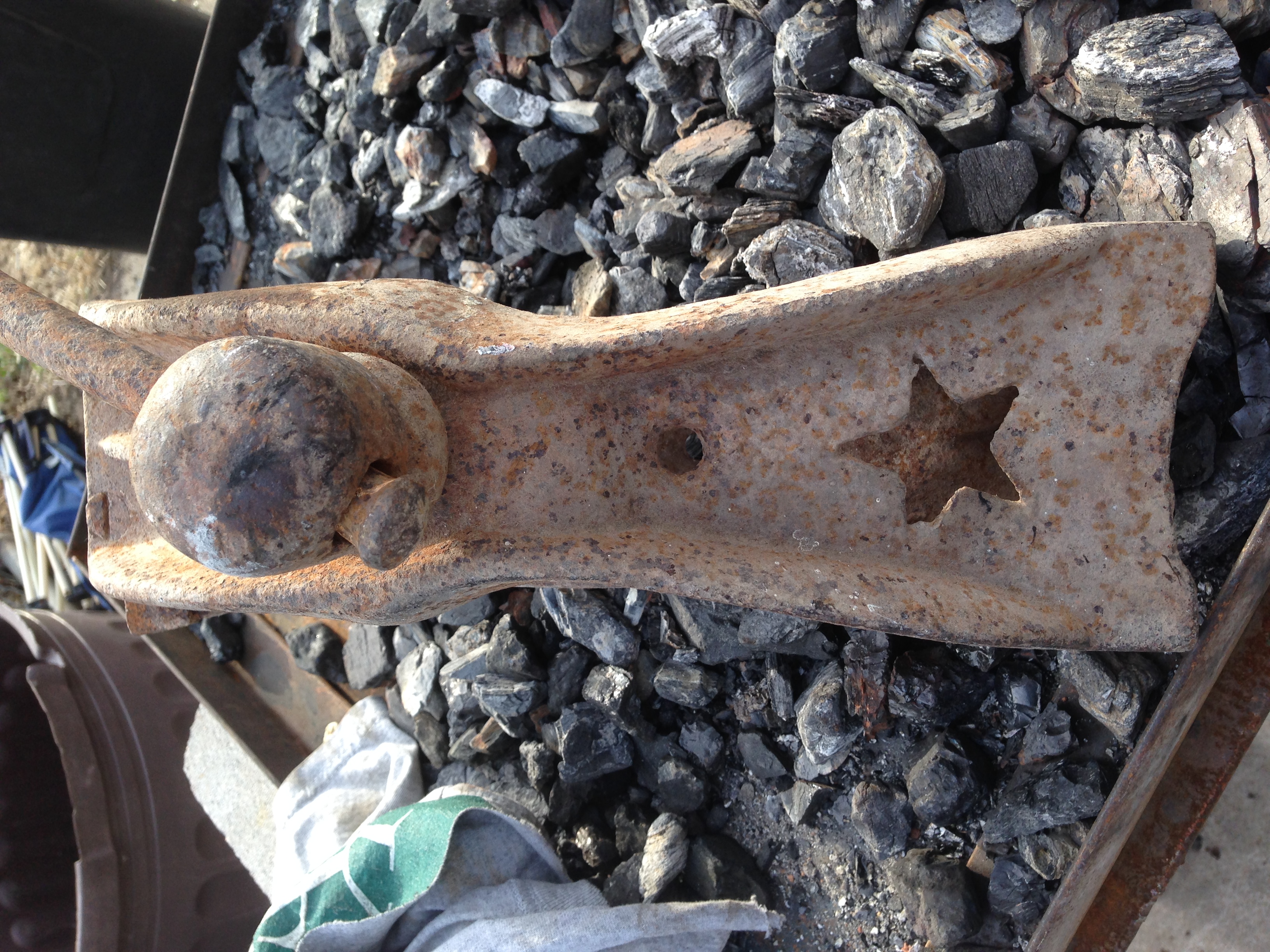

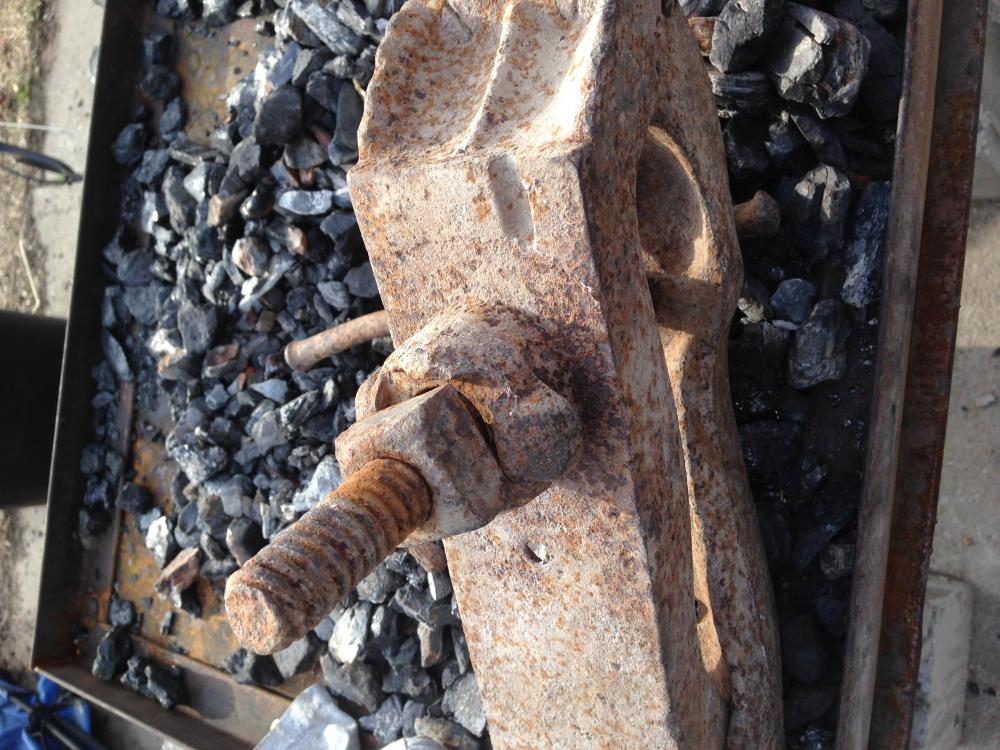

51 Papy Posted April 10, 2016 Share Posted April 10, 2016 Can someone tell what this is and/or what parts are missing. This is a vise as those sure look like vice jaws. But not sure from there. Picked up at a hundred year old barn. This was all the pieces. papy Quote Link to comment Share on other sites More sharing options...
BIGGUNDOCTOR Posted April 10, 2016 Share Posted April 10, 2016 It appears that on the back there is a tee shaped tab that would slip into a slot to hold it in position. Was there anything else in the barn that had a tee slot that this would have slid into? Could have also been a hole that it was put into then rotated 90° The hole makes more sense than the slot because it would mean less issues with clearing the screw since it would all be inline with each other. Quote Link to comment Share on other sites More sharing options...
matto Posted April 10, 2016 Share Posted April 10, 2016 Looks like another version of a cole vise. Just missing the mounting bracket Quote Link to comment Share on other sites More sharing options...
51 Papy Posted April 10, 2016 Author Share Posted April 10, 2016 That was all I could find. I thought it was a post vise when I saw it but then when we unburied it not so much. I'll google Cole Vise and see. Thanks for the help. Papy Quote Link to comment Share on other sites More sharing options...
Gray iron Posted April 10, 2016 Share Posted April 10, 2016 I think that vise attached to a hollow cast anvil . W. E. Canedy pat. No 184,504 1876 or pat no. 426,362 1890 Rochester Mn. There is a picture of one of this style in Postsmans Anvils in America on page 402. I think several companies made this vise based on this design. I had one that had a tapered bracket that attached to a workbench, it was made in Iowa. Most of the hollow anvils broke . Hope this helps. Quote Link to comment Share on other sites More sharing options...
51 Papy Posted April 11, 2016 Author Share Posted April 11, 2016 Gray Iron I did a patent search and the 426,360 1890 patent picture sure looks close. Being an old tool hound I want to rebuild this vise. As this is a hobbie not a business time is not an issue. I have plate and a welder (and a master welder that's a buddy). You said most of them broke. What would you use to make the piece that connects the jaw to the bench mount. I was thinking two pieces with the right size hole and then welded together. Looks like this piece would need to be 1/2" thick. Am I chasing a ghost or could I have a functioning vise for light work? Lord knows I don't "Need" another vise but you can always "Use" another vise. Thank you for the information. All I could find was Cole and BC Goble vise pictures. Papy Quote Link to comment Share on other sites More sharing options...
Gray iron Posted April 11, 2016 Share Posted April 11, 2016 Papy , I think your vise mounted to the anvil by rotating the vise through a hole with notches cut to accept the lugs in front of that square nut. You may have to experiment with the bracket thickness in order to get it to cam in tight. The one I had was a little different ,the sides were tapered and the vise dropped down into the bracket. The anvils show up on E-Bay now and then but are usually in rough shape with broken mounts . But you might get lucky and find a good one. That star cut out might be a clue to who manufactured yours. Also look for patent dates or numbers on the inside of the castings. I gave mine away a few years ago and don't have the patent number or manufacturer any more. Yours looks complete except for the coil spring that slips over the screw. Good luck, hope you can make it work. Papy , Forgot to mention that the groove near the top jaw was for a pin that locked the vise once it was rotated in place. You could mill or file one in your bracket. You should be able to fabricate a 90 degree bracket that would work. Quote Link to comment Share on other sites More sharing options...
