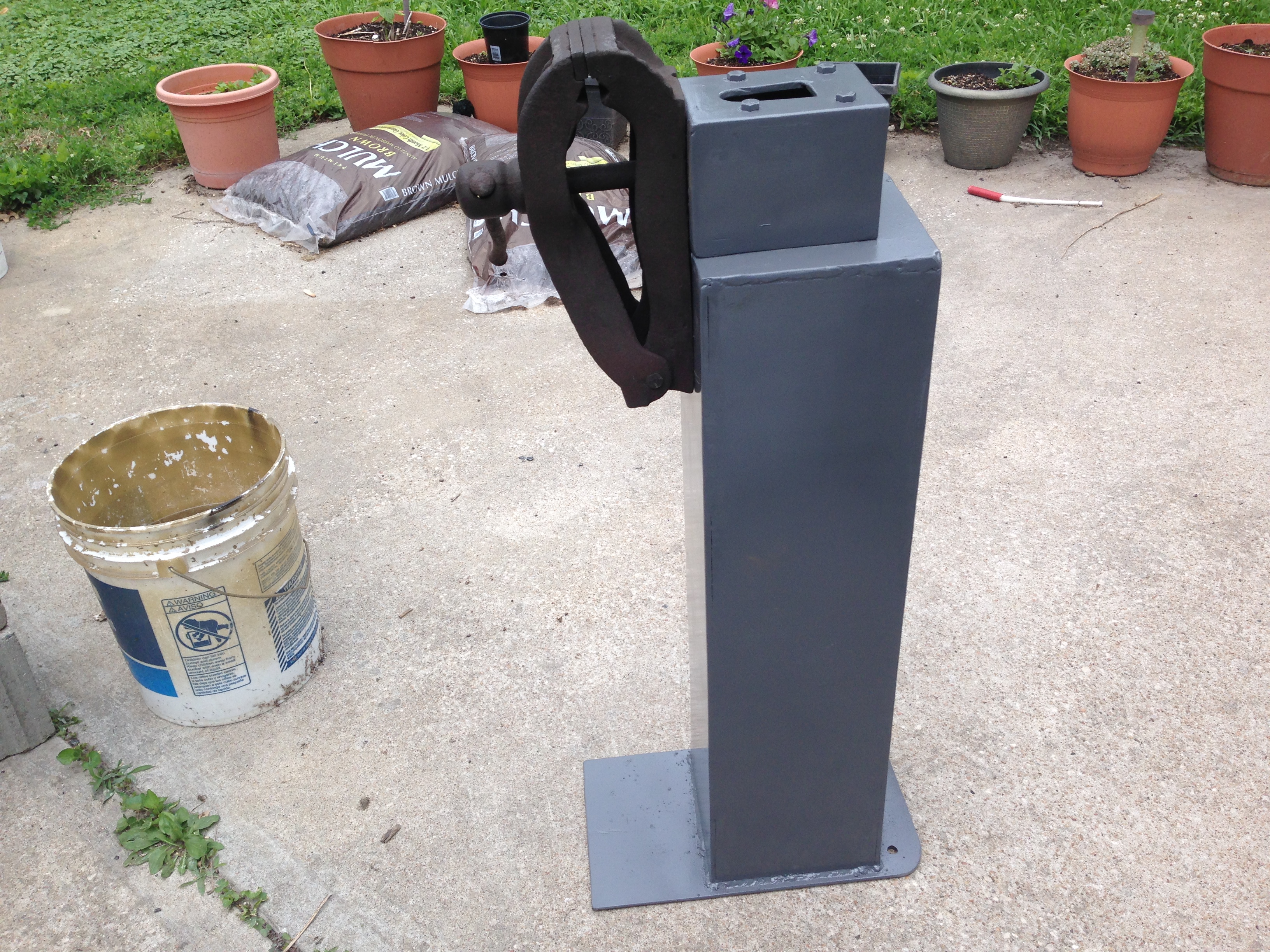

51 Papy Posted April 28, 2016 Author Share Posted April 28, 2016 What is the "proper" height for a vise? Starting the anvil base and stand. I know this is a wide open question just looking for some guidance on the floor to top of jaw measurement. Seems like it should be taller then the anvil but that's a guess. Thanks Papy Quote Link to comment Share on other sites More sharing options...
John McPherson Posted April 28, 2016 Share Posted April 28, 2016 Quote Link to comment Share on other sites More sharing options...
51 Papy Posted April 28, 2016 Author Share Posted April 28, 2016 Thanks John. That's what I was looking for. Should have seen the BS when I googled it. papy Quote Link to comment Share on other sites More sharing options...
ThomasPowers Posted April 29, 2016 Share Posted April 29, 2016 Ok now show the pictures of the right height for hammering; and the ones for the right height for using a 8" tall ball stake; and .... Or to put it succinctly: the proper height depends on what you are using it for---which was not mentioned. I do most of my filing in a machinist vise and not in any of my postvises. (and it mounts on the hand cranked table of my large drill press so I can move it up and down to get it just right for the item I'm filing.) Usually the heavier the hammering or the more tools you will be using in the vise the lower it needs to be. So if you will be forging renaissance armour on stakes, go low! Quote Link to comment Share on other sites More sharing options...
51 Papy Posted April 29, 2016 Author Share Posted April 29, 2016 Thomas I knew that the question would more than one answer. From John's diagram my bench vise is perfect so, better or worse, I think I will lower the one I'm working on 4 to 6 inches to allow for hitting and bending. Figure I can raise it up if needed. Thanks for the input, nice tip on the drill press table. Going to try that. Papy Quote Link to comment Share on other sites More sharing options...
ThomasPowers Posted April 29, 2016 Share Posted April 29, 2016 I don't do any hammering on the machinist vise on the drill press table and I have a stout drill press. (2 HP oldschool Dayton motor on it). I have noticed that my 6" postvises tend to be shorter than some of my 4" ones. Perhaps they were "designed" for heavier work from the gitgo. (And yes I am overly fussy about "simple" answers to questions that are wide spanning...I can't even just say what height I use as the 11? I own differ amongst themselves) Quote Link to comment Share on other sites More sharing options...
51 Papy Posted April 30, 2016 Author Share Posted April 30, 2016 Thomas The bench or machinist vise is an old Reed mounted to top of the bench (1/4" plate). I don't hit it (much). This one will be the one that will be used that's why I think I'm going to lower it some. I have a small swivel base vise to go on the press and that one will never get beat on. The old girl is to pretty. Thanks Papy Quote Link to comment Share on other sites More sharing options...
51 Papy Posted May 14, 2016 Author Share Posted May 14, 2016 Going for a test run today. If all works out I'll take it inside fill it with sand and bolt it down. Quote Link to comment Share on other sites More sharing options...
