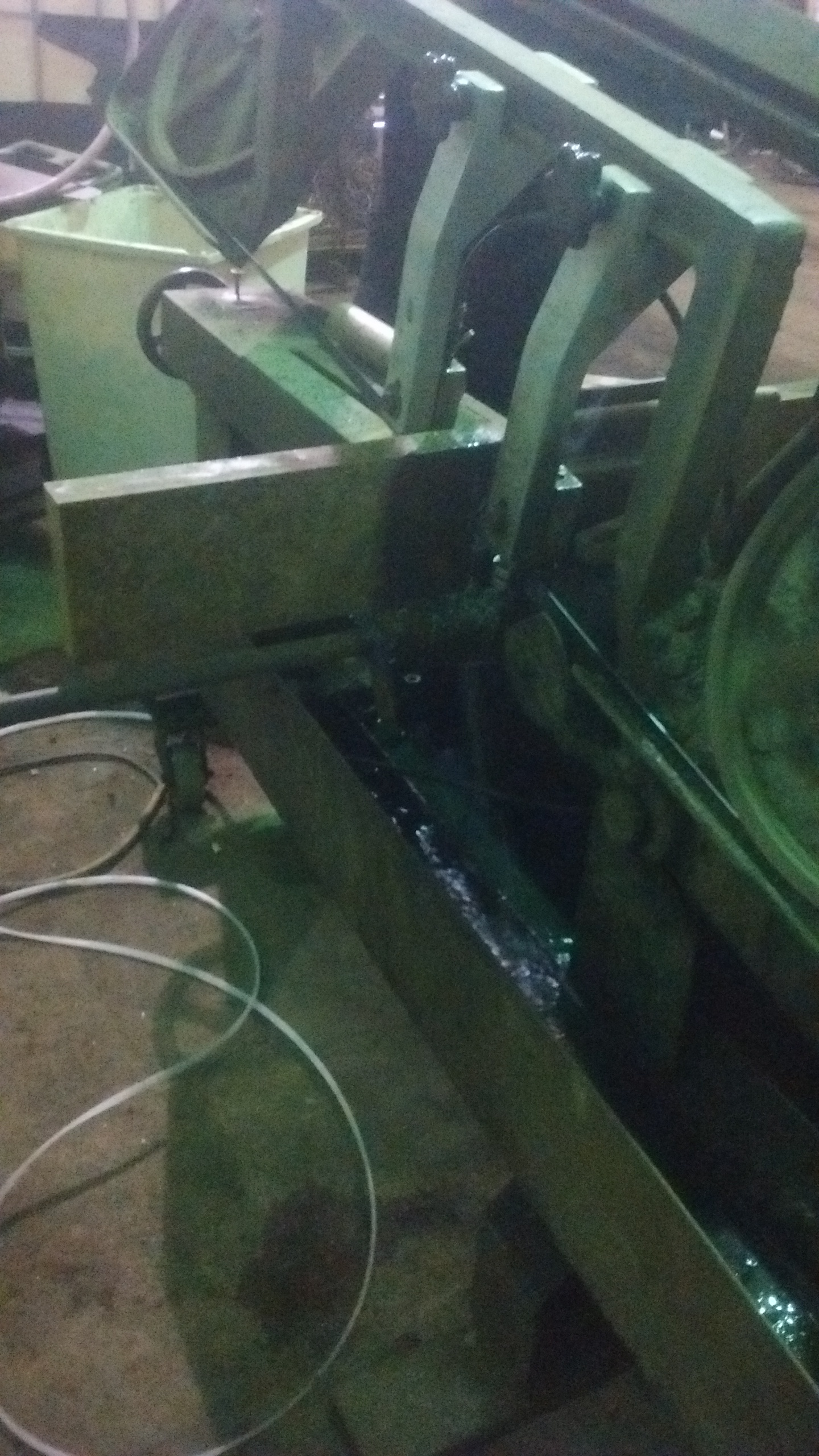

Just got a 2" x6" x16" block of s7 for a striking anvil. It's in its early fetal stages right now, but I'll try and keep photo updates of the fabrication progress.
