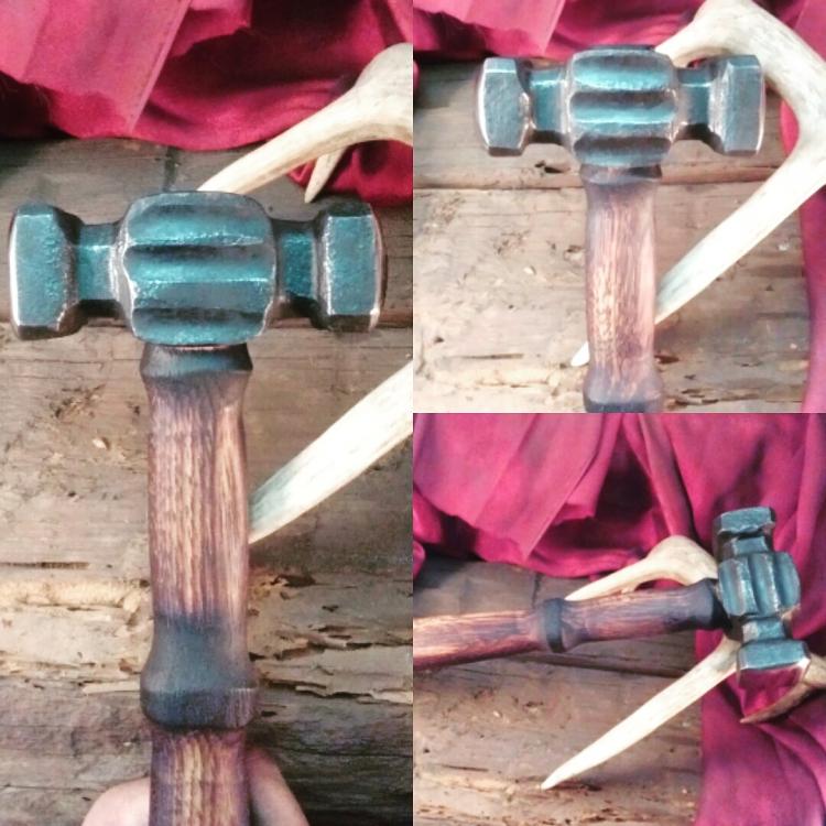

4140 rounding hammer with isolated fullers on the cheeks hung on a hand drawn and sanded American hickory handle, burnt and finished with a BLO, turpentine and beeswax mixture. I don't usually make 2 lb hammers since they don't seem to sell as quickly. I just wanted to take it easy on this one lol.
Cool hammer; very dramatic. The shape of the handle strikes me as a bit odd, though, and I wonder if the swelling is placed to far down to allow the occasional choking up on the handle. Does that make sense?
I'd use it any day...just in case, ya know, it's too light for the manly men up your way and you wanna ship it to a poor Southern Gal!   :D
JHCC the swelling spot in the handle is great.  I have been using one of crazy Ivan's hammers for about a week now and love the bulge.  I fit the handle to what I like and cleaned up the bulge some so it fit inbetween my fingers comfortably.  It is a great reference point for me to know where the hammer is during forging with out having to look.  It has no effect on my ability to chock up on the handle. It really acts like a gear and cog.  Your hand is the gear the swell is the cog.  Pete puts a nice not to big button on the bottom of his handles too.  Again helps with the knowing where your hammer is in your hand with out looking at the hammer.  And the piece of mind that it should not sail out of your hand in a full swing.image.jpg.474a0a7e3f7808d2a0a301b68e4b21

That makes a lot of sense, matto; thanks.
What is the purpose of fullering the head? Is it for looks, balance or both?  I do like it, and if I had the money and experience to use it I would  buy one. The handle looks like it is easy to hang on to when your hands get sweaty.
Thanks for the replies. Matto pretty much cleared up the wonkey looking handle design. As odd as it may look to the eye it it a real treat in the hand.

Bud, the fullers help in a few ways. One is that I like the hammers I make to be kind of stalkey to start out with so the fullering gives the hammer "reach" for using the edges without the handle getting in the way. Same time, the center of gravity is as close to the handle eye as possible so that off axis blows do not transfer to your wrist with the hammer head torquing. Make sense? My hammers do not go out the door without being perfectly balanced in the center of the mass because I think the over all feel of the hammer is greatly benefited by its center of gravity. I've had far less joint pain since I started making and using my own hammers, but that's partially because I suit them to what I've found that I need over all these years. So far I have had nobody who uses my hammers tell me otherwise so I'll keep it up :D

I use a draw knife and a 1.5" contact wheel on the belt grinder. Sometimes I preshape them on the wood lathe. Depends on how I feel going about it. The wood lathe gives me an oversized round blank to work with which I draw down and sand to oval by hand. Helps to keep things consistent.
I start with 6/4 hickory slabs for them.
Here is what my handle looks like after I fit it to my hand.image.jpeg.85b77ac8e5c2a1cb4a24e9f0fd4ab

Dave I'm with you but a little hoof rasp and sand paper go along way in making a handle fit your hand.  I have had this hammer for a week now and have almost 70 hrs using it.  If I did not make it fit my hand I would probably have half the hours do to fatigue.
or I would of started with it and then quite using it because the handle was to big or hurt my arm or hand.
When you care as much about the handle feel as you do the aesthetic and balance of the hammer head, I figure it's worth the extra effort. I always said a poor handle can make an expensive hammer worse than a $3 hammer.
I like the fact that Pete takes as much time developing the handle as he does the head of the hammer.  They are one of a kind hammers to use!
