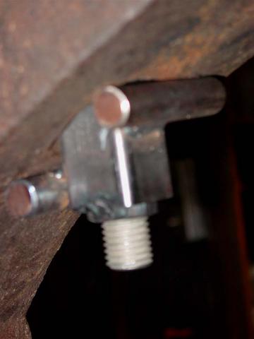

Here are a few ways to secure a tool in the hardy hole. Sleeve to square a bolt and nut to the face, slots and tapered wedges, and hot fitted to the specific anvil with wide shoulders to spread the stress.

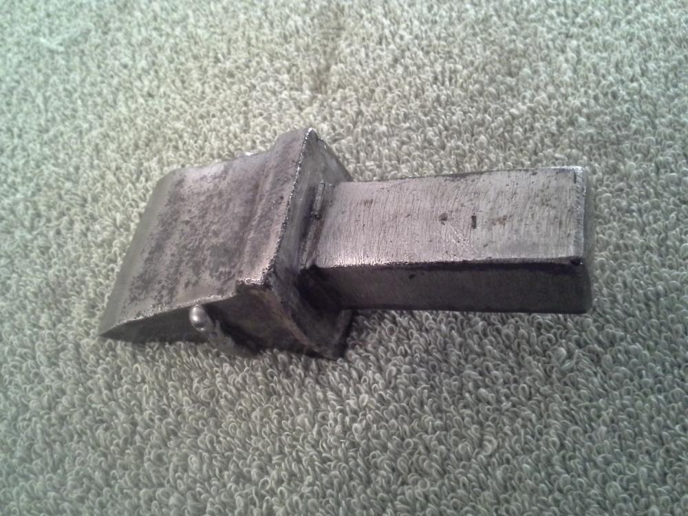

Here is a pic of the bolster/flange style.
My preference is definitely to have the tool sitting on the anvil face. I feel that this is the best way to transmit the force of the blow to the anvil. It also defines the position of the tool. A tool that is wedged has no well defined position. The shank will prevent any lateral movement. If it is made as a tube forced into the hole it will also prevent any rocking movement. As I wrote, the edge of my hotcut will not move more than a small fraction of a mm and it has a rock bottom connection with the anvil but I can lift it out using thumb amd fore finger. I want to have the tightest possible fit that does not jam and the tube method gives me that.
I have seen video clips where the hardy tool is made from a conical piece that is forced into a hole. Obviously I have not tested the result but I can imagine that the shank has only rim contact with the hardy hole and that there is nothing to prevent the tool from rocking. Some of the tools were not made on the hole where they were intended to be used so the fit is unlikely to be what I want in a hardy tool.
If made properly they won't rock. Yes, there is a very small contact area in relation to a hardie and the anvil, but remember this is a cutter. Not a fuller or a swage.
