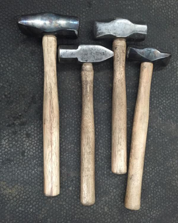

Forging Carver Posted February 15, 2016 Share Posted February 15, 2016 Hi, I have a hammer in which it has a chared handle and I am debating whether or not I want to remove the char or not. Have any of you removed the char on your chared handle? If so can you give me a picture of what the handle looks like once the char is removed? Thanks. Quote Link to comment Share on other sites More sharing options...

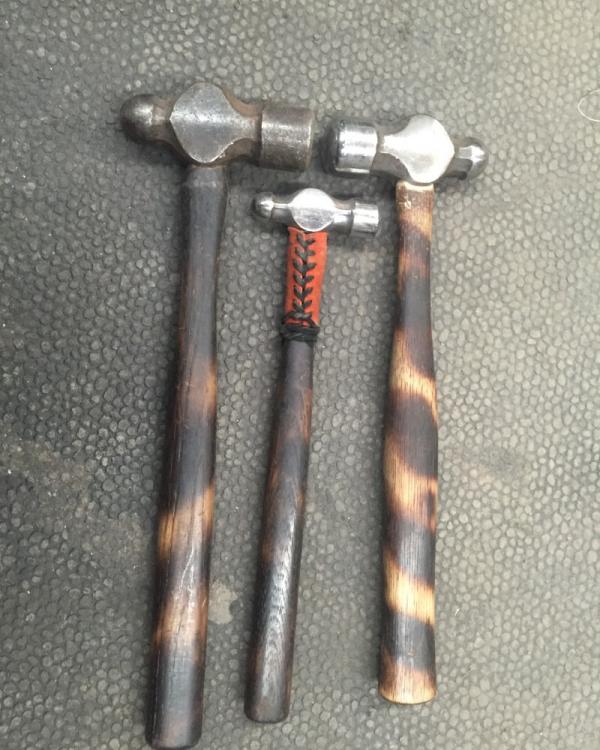

Daswulf Posted February 16, 2016 Share Posted February 16, 2016 I believe it's all personal preference on that. I've done some fully burnt, some with a twist patern like in the first picture and some I didn't touch that I got back, or made by RThibeau. On handles I burn I do it light then sand with a fine grit like 400 then while hot wipe em with beeswax, Turpentine, linseed oil mixture then hit em lightly on a buffing wheel but that's just personal preference. Seems to seal em up good. Mia there a reason other then looks you were concerned about it? Quote Link to comment Share on other sites More sharing options...

Forging Carver Posted February 17, 2016 Author Share Posted February 17, 2016 So I started to take off the char with some steel wool and 220 sandpaper. I ran out of 220, but I don't think the hammer looks too bad how it is now. I am debating whether or not to keep sanding it down or not. The stickiness is gone and the hammer is much smoother. Not to mention I like how it looks better now anyways. I have to remember at the handle will darken over the years of use. Tell me what you guys think I should do. Thanks. Heres the before and after. well The way it showed up is the after then before Quote Link to comment Share on other sites More sharing options...
