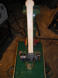

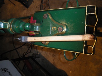

This one hired on with me as a 24oz +/- ball pein. The handle is from a plank of clear straight grain 5/4" hickory I buy from a local hardwood specialty guy. I'll explain why my handles are like this if you'd like.

A slab handle has a couple advantages though the most important to me is it indexes in your hand automatically. Just a little practice and the hammer will always be level in the left right axis. It's much easier to hold in a light grip and save you're appendages fatigue and damage.
I hold mine in what I call a modified fencer's grip, I allow the hammer to pivot between the second knuckle of my index finger and my thumb. Just at the moment of impact I close my grip snapping the hammer sharply then relax my grip. This adds another hinge point to my swing each hinge point is a force multiplier making a blow significantly more powerful for the same amount of effort on my part.
Relaxing my grip at the moment of impact allows the hammer to recoil without resistance. Sure it doesn't bounce and help lift my arm but my joints do NOT absorb the impact at all.
Those are the reasons I prefer a slab handle and the why. The one on the straight pein in the picture is tapered from the head to the end largely to make it less fatiguing and more secure. The taper is pretty unnoticeable when in use. . . UNTIL you get tired, distracted or. . . and loosen my grip during a swing. Faster than you can react if the handle slips your grip tightens. Pure reflex and I've never thrown a tapered slab handled hammer. Can't say that about my regular hammers though and as soon as an old handle breaks or just annoys me it's getting replaced  The knob on the end was a bit of overkill on the first one I was thinking if it slipped the knob would be a good stop but one of these has never slipped enough to tell. The knob has become a trademark sort of thing and it's part of the pattern I'm too lazy to remove.
One last bit that doesn't show is how the shaft is shaped. Sure breaking the corners in intuitive, don't have to tel you that. However doing demos is theater and one little thing I've done for years is spin the hammer on the back swing to change face to pein or back. It's always been a little razzle dazzle showmanship to impress the audience and a good laugh when I got it wrong. I had a brainstorm when I handled my first one and rounded the edge facing the pein so I don't have to look to know which way it's facing. Now when a spin ends with the wrong side facing the work I say, "Oops got it backwards!" and reverse it without looking. Just a bit of a showmanship gimmick, you betcha. B)
