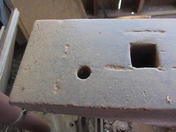

Mindy Posted October 31, 2015 Share Posted October 31, 2015 Looking for some advice. We are clearing out my Father's ranch and we have a 1940 Fisher Anvil on a stand. I would like to know what it's worth so I can list it for sale locally. I have a basic idea but want to make sure and thought this would be a good place to ask. It probably weighs about 200 lbs. Thanks for your help. Mindy Quote Link to comment Share on other sites More sharing options...

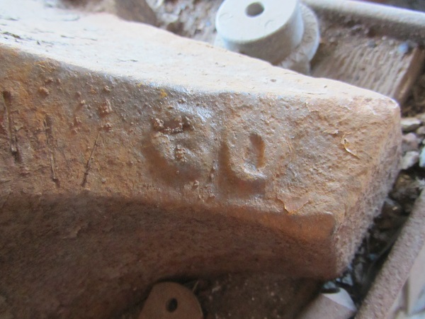

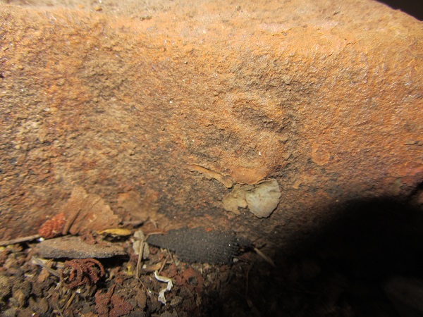

ThomasPowers Posted November 1, 2015 Share Posted November 1, 2015 Well just here in the United States it can be a factor of 2 in price; I don't know which of the 100+ countries participating on this site you are in... If that is a 20 on the top of the leg is should be around 200 pounds. If it's a 30 then 300 pounds... Looks to be in quite decent shape---unless that's a crack in the heel, then it's a major flaw; especially on a Fisher. Fisher's are particularly good anvils for city or suburbia use as they are a quiet anvil and don't ring when you hit them. Quote Link to comment Share on other sites More sharing options...

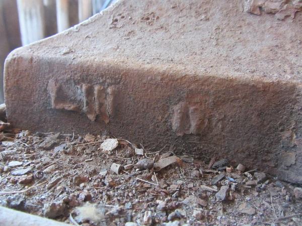

njanvilman Posted November 1, 2015 Share Posted November 1, 2015 If that is a 30, it is a 300 lb. 20 would indicate 200. If it is too hard to make it out: 300 lb Fisher has a face width of 5 1/4" and a face length of 19 3/4". A 200 lb Fisher has a face width of 4 3/4" and length of 17 1/4". This will give you and easy way to determine its weight.You can also go for a wider audience than a local one with a major on-line auction site, if you participate.That anvil, if sound, and it a appears so, should bring $3 to $5 lb. You are a seller, not a buyer, so what other people have managed to buy anvils for has absolutely no bearing on you price you ask or what you sell it for. Quote Link to comment Share on other sites More sharing options...

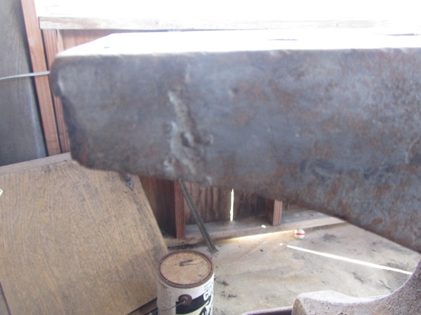

Mindy Posted November 1, 2015 Author Share Posted November 1, 2015 Would you please tell me in which picture you possibly see a crack so I know where to look when I go down to the workshop today? I don't see anything that looks like a crack in the pictures. Maybe I will take some additional pictures today.Thank all of you so much for responding. Now, anybody want to buy some tractors, trucks, drill presses and every other tool known to man? (Just kidding) We have our hands full here trying to clear our Dad's "good stuff." LOLMindy Quote Link to comment Share on other sites More sharing options...
njanvilman Posted November 1, 2015 Share Posted November 1, 2015 I think the above poster is referring to the first picture, about 1 1/2" in from the heel end. It has what appears to be a vertical line on the side. I think is is just a paint line or something else, but not a crack. Quote Link to comment Share on other sites More sharing options...

ThomasPowers Posted November 1, 2015 Share Posted November 1, 2015 First picture on the heel there is a light line vertical seeming to have a dark line at the top. Probably nothing but I have seen a *lot* of anvils sold as perfect in blurry pictures that in fact had issues. Whatever you do DON'T PAINT it---I drop the price I'm willing to pay by US$100 for a painted anvil. If you want to make it look pretty wire brush it and give it a coat of boiled linseed oil or wax (treewax, johnsons's paste wax, etc). Quote Link to comment Share on other sites More sharing options...

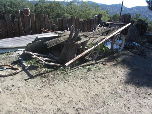

Mindy Posted November 1, 2015 Author Share Posted November 1, 2015 Thanks for the referral to Travel Town. I also have some cart thing that someone just told me is a railroad luggage rack/cart. I'll have to unload the various ropes and chains from it and take some pictures. I'll see what it's worth (maybe) and/or donate it to the museum, if they want it. I just noticed that I need to advertise a lot of this rusty stuff with the word "steampunk" in the ads ;-) Quote Link to comment Share on other sites More sharing options...
Mindy Posted November 1, 2015 Author Share Posted November 1, 2015 Here are 2 pictures of the railroad luggage cart.Also, here are two more pictures of that area of the Anvil that might have looked like a crack. It is not a crack. Quote Link to comment Share on other sites More sharing options...
njanvilman Posted November 1, 2015 Share Posted November 1, 2015 Just to keep you fully informed, those marks on the face and the side were caused by someone using an oxy-acetylene cutting torch over the anvil. The super-heated slag and oxygen jet eroded/burned out some of the steel faceplate, and on the side. As long as there are not more of these in the center work area of the face, it is not going to affect it function. But it does take away some of its value. With this damage, $3/lb is probably going to be the upper end. (Note to all: I am not interested in this anvil. I am on the other coast, 3000 miles away.) I am sure a smith in the west will be glad to get this Fisher. Quote Link to comment Share on other sites More sharing options...
Mindy Posted November 1, 2015 Author Share Posted November 1, 2015 Thank you for that information. It makes perfect sense because it came from my Dad's friend when he closed up his welding shop. Quote Link to comment Share on other sites More sharing options...
