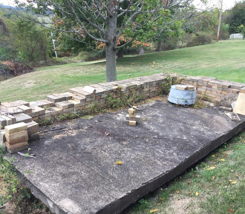

I've been looking for some fire brick on the cheap and a friend of mine said his mom had some. Well she has a lot and wants to get rid of all of them.  I finally got sent a few pictures.
Is .50 cents a brick a good price for used fire brick? I believe it was used for a pottery kiln.
I could probably wheel and deal on a bulk price but that's where we are at right now.

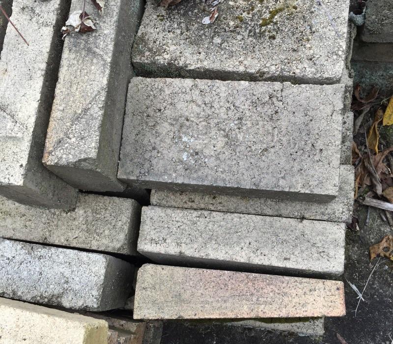

I'd maybe use them to build a BBQ or outdoor fireplace without better info on the pricks. If they're "contact" fire brick then their temp rating should be plenty but those look more like exterior or structure brick.

judging by the picture, looks like they have been sitting out a while. Probably have been.

A few of them in the pics seem to have spiderweb cracking and might not hold up long at all.  With the freeze/thaw cycle of PA....  I'd wonder about any of them.
Two layers of that fire brick, though, would make a dandy table for a coal forge.  The clinker, scale and ash would quickly build up and fill the voids, helping to hold any cracked bricks together.  I wouldn't worry about a "fire pot" with a brick table; I'd simply build up a moveable fence with more bricks so I could shape the fire how I liked.  A 3" pipe nipple and end cap would serve to bring the air up through the two layers of brick....

  It's a tough call. Think I need to check these out in person. Have a talk with her and get her story and let her know some of the concerns. Maybe just see if she wants to deal more. Worst case I build an outdoor bbq. :P  sure there are some good ones in there.
Lightly tapping each prospective brick with a small hammer will tell you a lot about its structural integrity. A sharp "clink clink" means that the brick is probably sound. A dull "clunk clunk" means that it is probably cracked.
