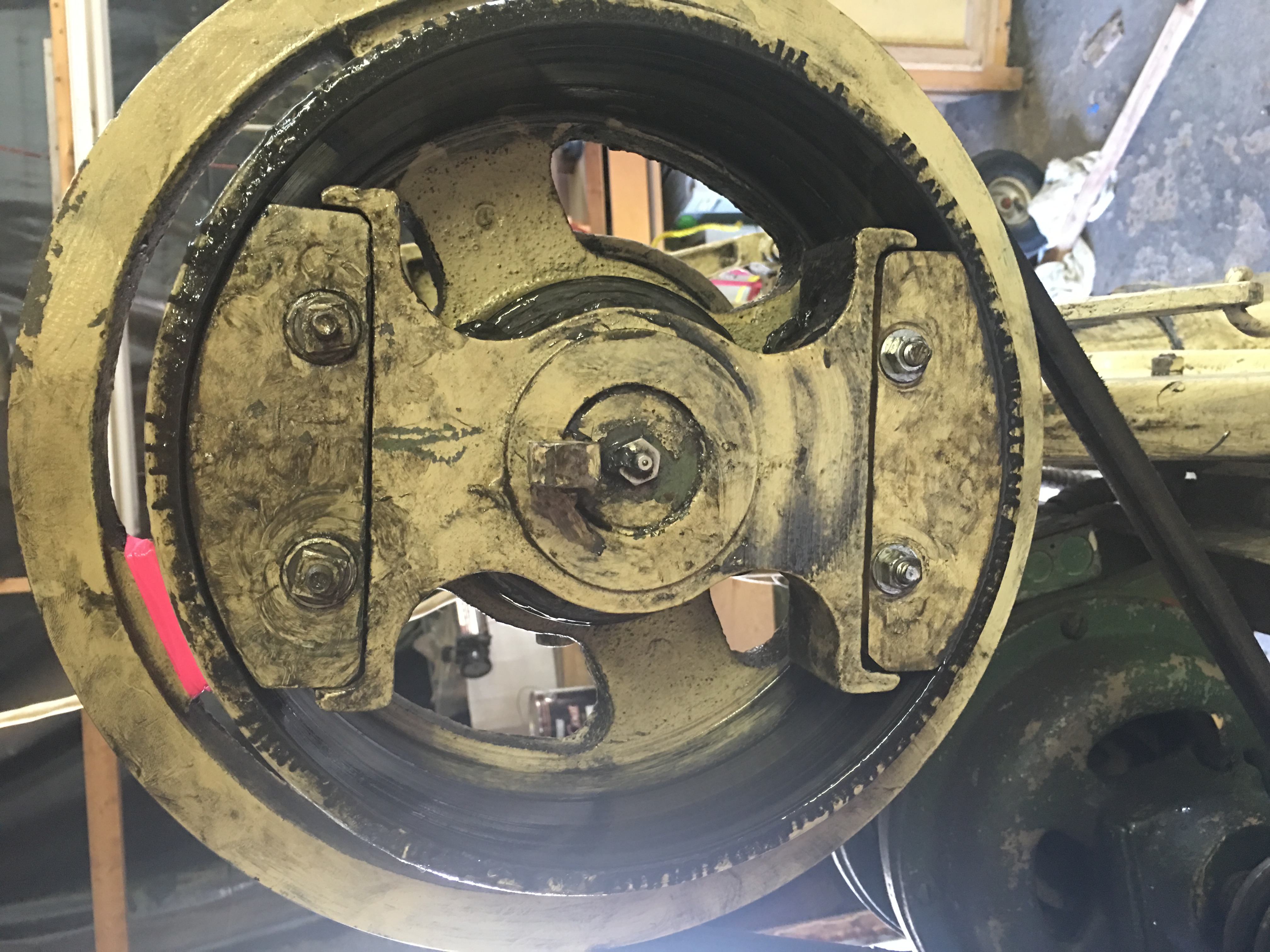

  4. Hoping for some advice on tuning a LG 50# hammer ( new style) I just received. Hadn't been run in a few years and clutch pulley was nearly stuck with old grease and would not release. after replacing alemite fittings finally pumped enough grease to somewhat free it. The original 3 phase motor is rated at 900 rpm so it looks like at best I can get 180 bpm with current pulleys. The ram was sticking at TDC until I loosened the top gib somewhat but it still seems to have friction there to change rotation where it is not smooth. The clutch does not grab as well as I think it should but still tries to run-on when I release pedal. I can stop rotation by hand so it is not dragging too much. Seems not to be hitting very hard it wont demolish 3/4 walnut like 25# on youtube. Do the rams often need facing or scraping and should I remove ram and inspect? I am lubing with bar oil liberally and moly impregnated grease on front and back. I checked end play which is 25 thousandths. One more question, when I started to lift from mainshaft near rear pulley when installing unit and noticed some vertical play in shaft.. Best I can measure, it has 10 thou play upward after removing v- belts. The babbitt shims look pretty thick and wonder if I should remove one near the rear pulley. Any help appreciated.. Thx
