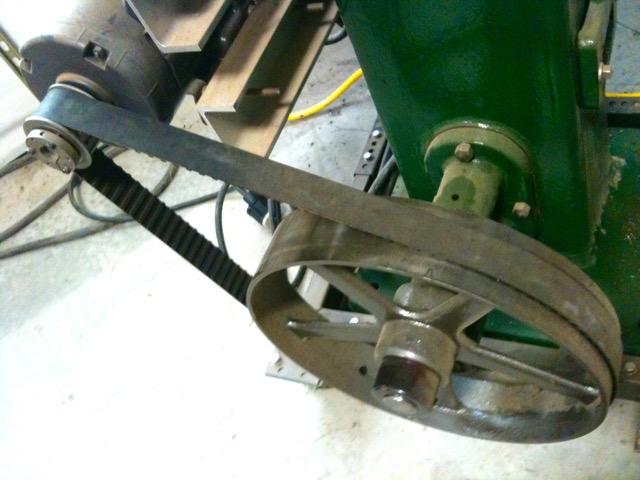

I noticed the V belt in place of the original flat belt.  Although it's a bit bigger investment, on the re-hab of a C. 1910 keyseater that was designed for a leather belt I used a wide flat cogged belt instead.  It requires a toothed pulley on the motor side but acts as a flat belt on the machine side.  Seems to work extremely well, perfect tracking, and looks a little bit more like it was originally intended to.
Just passing it on in case you're not happy with the current belt and think spending a few dollars is worth it.

Kozzy, I will keep it in mind in case it doesn't pull as well as I think it should.

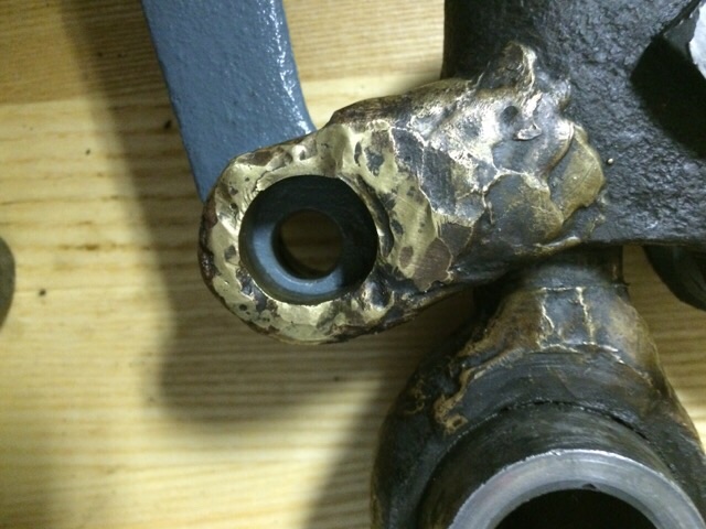

I just cleaned up the pitman and cross head. They had so much grease that I didn't discover they had both been broken and brazed at some time in their use life.
Anyone have a spare Mayers/Moloch cross head and/or pitman?
Notice the wearing of the bolt head on the cross Head?  I will have to check the Flywheel to see where it was rubbing.

The parts came in today, yay!
But, while the new parts are awesome, they don't seem to fit.  In fact, I can't drill them out to fit the crosshead because there wouldn't be much left to the upper ears of the arms!
sheesh!  Help?!?! Any ideas, anyone?
I'm thinking about drilling out the original crosshead pins to the size of the new ears of the upper arms and using them as sleeves for pins that do fit the new arms.
Bushings.
They make it easier to get oil to the bearing surfaces and excellent sacrificial wear surfaces so you never run into worn ears again. Buy a few extras so there are some on the shelf in case.
That isn't a real problem it's a normal adjustment for wear and tear, don't sweat it.
Frosty, you are a genius! Bushings!  Brilliant!
Looks like they need to be 3/4" OD, 1/2" ID and .4" long.
Ah, hardly genius it's years of experience keeping heavy use machinery functioning. Of course I'll graciously take credit for thinking of it for this application.  :)
Keep posting your problems with pics, I'm not the only one with experience doing this kind of stuff.
Ok, the ears of the arms are 3/4" thick.  The ears on the crosshead are only .71" apart.  I cannot grind the crosshead ears as they don't have a whole bunch of metal of them.  Being the crosshead ears have been brazed, that bothers me too, if I was to heat them up to bend them out a little.So, is it ok to remove some metal from the ears of the arms?

On one side, there is enough room.  It is only on one side where the ear isn't wide enough.
Jeremy,
I would love to fabricate a new crosshead, but I'm not a machinist. I don't have the measurements to give to anyone, either.
It is a good idea, though.
Thanks
I measured the pitman at the bottom.  It is .98" diameter.  Anyone know if that is the correct measurement for the Mayer 25lb?
Of course, if anyone has a spare crosshead for a Mayer/Moloch 25lb, I am interested.
