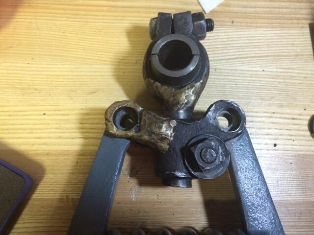

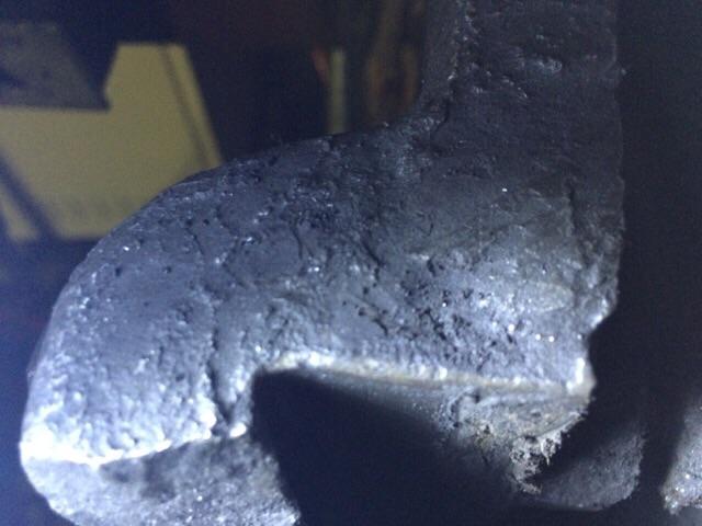

Frosty Posted August 24, 2015 Share Posted August 24, 2015 I don't understand what you mean by not enough room? Room for what, where?You don't need to be a machinist to make a cross head, it's just a little fabrication. Can you weld? And I don't mean run a "bead" I mean actually weld.Frosty The Lucky. Quote Link to comment Share on other sites More sharing options...

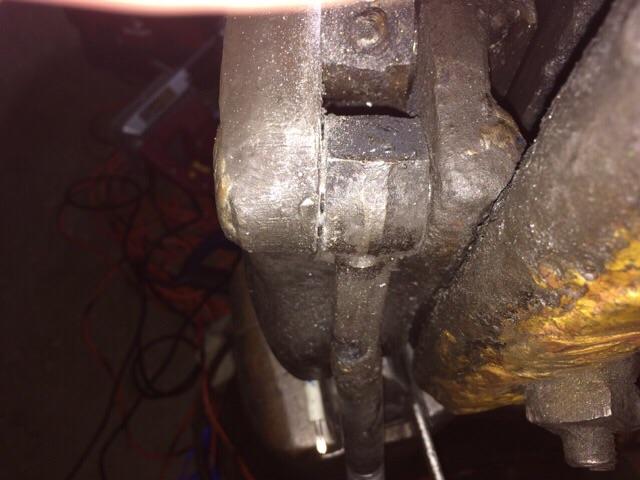

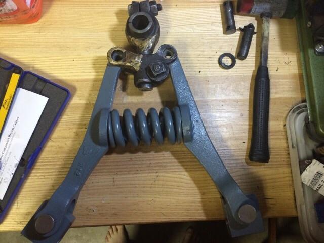

Augus7us Posted August 24, 2015 Share Posted August 24, 2015 (edited) Frosty if I understand him correctly it looks like the left arm will not slide into the crosshead. You can see in the last photo he posted one is in the other is not and I'm guessing that the one on the left will not slide into the ears on the crosshead. Larry correct me if I'm wrong here.I don't know that I would grind the arms because if you do get a proper cross head you may end up with play and have to shim brand new arms because of that. Edited August 24, 2015 by Augus7us Quote Link to comment Share on other sites More sharing options...
lloe01 Posted August 24, 2015 Author Share Posted August 24, 2015 (edited) Sorry, Frosty, just a casual welder.on one side of the crosshead, the ears of the crosshead, where the arm fits between them and you then put in a pin or a bolt, they are not wide enough for the arm to fit. On the other side, the arm fits and I still have about a tenth of an inch clearance.Augus7us,i emailed Roger with the pitman measurement, hoping he had some kind of crosshead that might fit it. Edited August 24, 2015 by lloe01 Quote Link to comment Share on other sites More sharing options...
Frosty Posted August 24, 2015 Share Posted August 24, 2015 My last 3 attempts to reply have been forbidden. ARGHHHH!!I'd just buy one even though I can fab one. I won't comment on the quality of a BRAZE that is humped up like the braze itself adds strength. I wouldn't even grind out the excess brazing to make clearance I'd just scrap it.Frosty The Lucky. Quote Link to comment Share on other sites More sharing options...
lloe01 Posted August 24, 2015 Author Share Posted August 24, 2015 Frosty, I am looking for another crosshead. I'm have emailed Roger to see if he might have anything I can use. If I had actual measurements I could get someone local to fabricate one.thanks :) Quote Link to comment Share on other sites More sharing options...
lloe01 Posted August 26, 2015 Author Share Posted August 26, 2015 Ok, I didn't have to take hardly any thing of the ear of the arm. Actually, all I did was remove the paint and smooth the ear so it wasn't rough. I then took a few thousandths off the inside of the ears of the crosshead and it fit great. Now I am waiting for the bronze bushings to insert into the ears of the arms. I also need to get the 1/2" pins for the ears of the arms. Quote Link to comment Share on other sites More sharing options...
Frosty Posted August 26, 2015 Share Posted August 26, 2015 I like your metaphor mixology. Be careful not to drop your arm ears on your toes on the floor.Okay, good news. Next time you run into a situation like this take a look, maybe a measurement and see if a little file work will do the trick.Frosty The Lucky. Quote Link to comment Share on other sites More sharing options...

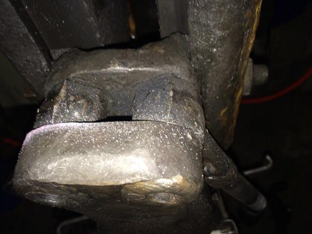

lloe01 Posted August 28, 2015 Author Share Posted August 28, 2015 Ordered my bushings again. Should be here Saturday.Meanwhile I tried to cutout the pins that are welded into the ram, connecting the toggle links to the ram.I tried a hacksaw, nothing. The blade did even bite So, I tried my sawzall and got the same result.....nothing.Finally, I got out my portable bandsaw and it wouldn't even bite the metal.Maybe I can get my torch and heat it and then try the bandsaw again.This hammer is fighting all the way! Quote Link to comment Share on other sites More sharing options...
Frosty Posted August 28, 2015 Share Posted August 28, 2015 In future, if one hacksaw blade won't cut don't ruin more blades trying other hack saws. Yes, a sawzall and metal bandsaw are EXACTLY the same saw blades in a different shape. Go buy an abrasive hack saw blade, they make them to cut almost anything. Heck, a Bimetal blade might do it, the teeth are carbides.If you can get to them you might have to grind the heads flush with the casting and dive them out with a FLAT ended punch. However, do NOT attempt this unless you can support the opposite side of each ear or you'll snap the casting more easily than you'd believe.If you have any doubts about how it's backed up do NOT try driving them out, it's not worth the risk.Frosty The Lucky. Quote Link to comment Share on other sites More sharing options...
lloe01 Posted August 28, 2015 Author Share Posted August 28, 2015 The big ring that was wrapped around the flywheel is blocking me from removing the ram or it would be on my work bench. I thought about grinding it. I figure it is not worth it and didn't want to weaken the ram ears. There sure are a lot of ears on this hammer!I still might be able to get that ram off when I can dedicate some more time to it. Quote Link to comment Share on other sites More sharing options...
Frosty Posted August 28, 2015 Share Posted August 28, 2015 The big ring around the flywheel? Are you talking about the crank plate? These things don't have flywheels. If the crank plate is in the way, take it off. They come off you know.How about unbolting the guides and taking the ram out. OR pull the dies and see if it'll drop down far enough to get to the pins or remove the hammer.These things were designed to be taken apart and sure guys with a "better" idea often really screw things up like welding bolts instead of just replacing them but still.Think of it like taking a house of cards apart without blowing it over. Sometimes the piece you want is actually second or third in line of what IS.Here's an idea, are there any pre-teens in the neighborhood? If yes, put the tools close by and tell them that under NO conditions may they remove those bolts! Then go have lunch the hammer should be pretty much nuts and bolts by time you finish a sandwich and second cup of coffee.Frosty The Lucky. Quote Link to comment Share on other sites More sharing options...
jeremy k Posted August 28, 2015 Share Posted August 28, 2015 Are the ram guides not adjustable? Take them off to remove the ram. You should not have to touch the crank plate at all to remove the ram. Quote Link to comment Share on other sites More sharing options...

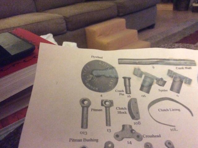

lloe01 Posted August 28, 2015 Author Share Posted August 28, 2015 (edited) The ram guides are brazed, but they don't look adjustable anyways, even at the top. As for flywheel, that is what it says on Little giant resources Parts diagram. Remember, this is a Mayer and not a Little Giant. Parts may be different. But, then again, whoever owned this hammer loved brazing. Edited August 28, 2015 by lloe01 Removed duplicate picture Quote Link to comment Share on other sites More sharing options...
Frosty Posted August 28, 2015 Share Posted August 28, 2015 Hmmm. I have "The Little Giant Powerhammer" by Kern and there is no mention of a flywheel anywhere in the original Mayer Brothers parts lists, etc. Okay, I take it back on the parts list print in the first couple pages it's called the crank plate with "flywheel" added perhaps because a lot of people are calling it that. It doesn't really matter we just have to know what each other guy is talking about.Did Mr. braze happy REALLY braze the ram guides on?! Some people shouldn't be allowed to work on anything more complicated than a chop stick!Frosty The Lucky. Quote Link to comment Share on other sites More sharing options...
lloe01 Posted August 28, 2015 Author Share Posted August 28, 2015 Crank plate sounds good I'm looking around the bolts near the ram guides and cannot see any seam. I will loosen the nuts and see what happens. I hope the ram guide does come apart. If not, it makes it really hard to repair it if something breaks.I will see what I can do this weekend.Thanks for all the ideas and help, guys! Quote Link to comment Share on other sites More sharing options...
lloe01 Posted August 28, 2015 Author Share Posted August 28, 2015 (edited) Frosty, that picture of the "flywheel" is on the www.littlegianthammer.com "resources" page. It is the parts diagram. Edited August 28, 2015 by lloe01 Changed the website name, thanks Kozzy :) Quote Link to comment Share on other sites More sharing options...
Kozzy Posted August 28, 2015 Share Posted August 28, 2015 Frosty, that picture of the "flywheel" is on the www.littlegiant.com "resources page. It is the parts diagram."littlegianthammer.com" Quote Link to comment Share on other sites More sharing options...
Frosty Posted August 28, 2015 Share Posted August 28, 2015 Frosty, that picture of the "flywheel" is on the www.littlegiant.com "resources page. It is the parts diagram.Yes, I found that one on the website too. Apparently "flywheel" has been added to the original part's list drawing. The same illustration is printed several times in the book. It's a living language, I'll adapt. Frosty The Lucky. Quote Link to comment Share on other sites More sharing options...
Will. K. Posted August 28, 2015 Share Posted August 28, 2015 (edited) I might be wrong but I think the ram guides are an integral part of the hammer frame casting and the bolts just pinch the two sides together. Check out the pictures of the 25# & 50# Wisconsin hammers at http://www.spaco.org/lgid.htm Edited August 28, 2015 by Will. K. Quote Link to comment Share on other sites More sharing options...
