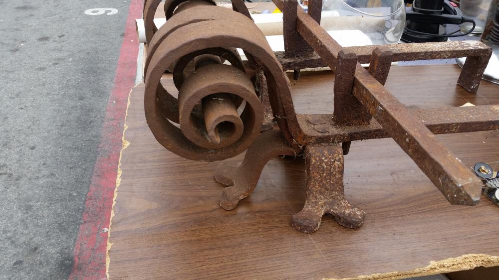

Saw these andirons at the flea market today . The guy first told me 1200 then was down to 500 today. He was talking about sandblasting to find a touch mark. I told him that would cut the price in half.
Here are some more pictures they are well made with traditional methods for sure

Those are serious (and yes, UGLY) andirons. The guy must have had a massive fireplace burning 6ft logs to warrant that mass of steel. The scrolls would have taken some bending. If his touchmark is in line with the robust construction, you wouldn't need a sand blaster to find it!
A skilful, traditional build ... but not pretty!  So you didn't bring 'em home??
Those should be attributable to a known maker, touchmark or not. The subtlety is gorgeous to my eye. Even a "good wire brushing" might be detrimental before attempting provenance. Craftsman period?
I agree with Ausfire it would take at least a 6' log to make it look good.  I have a 5' fireplace that I use 4' logs in and it would overpower that one.  Amazing work but beauty only a mother could love.   What  do those things weigh?
I did not bring them home, I had a spending cap a $200 for the day. I would estimate the weight at around 60 lbs each. They are about 3  feet long and a foot tall at the scroll.

Those have enough rust on them I'd derust with electrolysis or phosphoric acid. I've brushed rust when it's gone so far as to flake and it disfigures the remaining iron/steel. If it's an antique to BE an antique then stabilizing the rust is about all you want to do with it.

I was guessing Arts and Crafts period too and particularly in the 1920's (maybe as late as the '30's).  I do NOT call that a traditional build with the legs riveted on rather than forge welded. I also agree that they were probably built for a large show fireplace in a lodge and did not see much use...

I'm interested in how the "forked fishtail" scrolls are the same size stock as the apparent parent bar. I'm presuming there is a weld in there. I love to look at old andirons, no two sets seem to be made in quite the same way!
There mat be a forge weld in there but I really did not see it. Or they started out with larger stock and forged it down to what apears to be "Parent stock"
The last picture does look like a possible forge weld
IDK, something on them doesn't look right to me.  Perhaps its that the scrolls are rusted differently, or the odd riveting, lack of obvious touch mark or...something.  I'd say not antique, and not hand forged.
I keep coming back and scrolling through the pics. I'd say they're definitely hand made though he used a scrolling jig for sure. The scroll finials are reverse tapered and scrolled in a bit of a helix.
The more I think about it the more the rivets would make it easy to knock down to ship. Assembling it wouldn't be difficult nor require a smith to do. My grandmother knew how to buck rivets, it's only a "mystery today because they don't teach hand skills in school.
