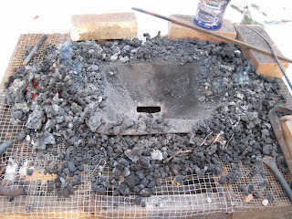

First of all, after I first bought my Champion 400 blower and Whirlwind Firepot, I knew I needed a place to put them, so that I could forge efficiently.

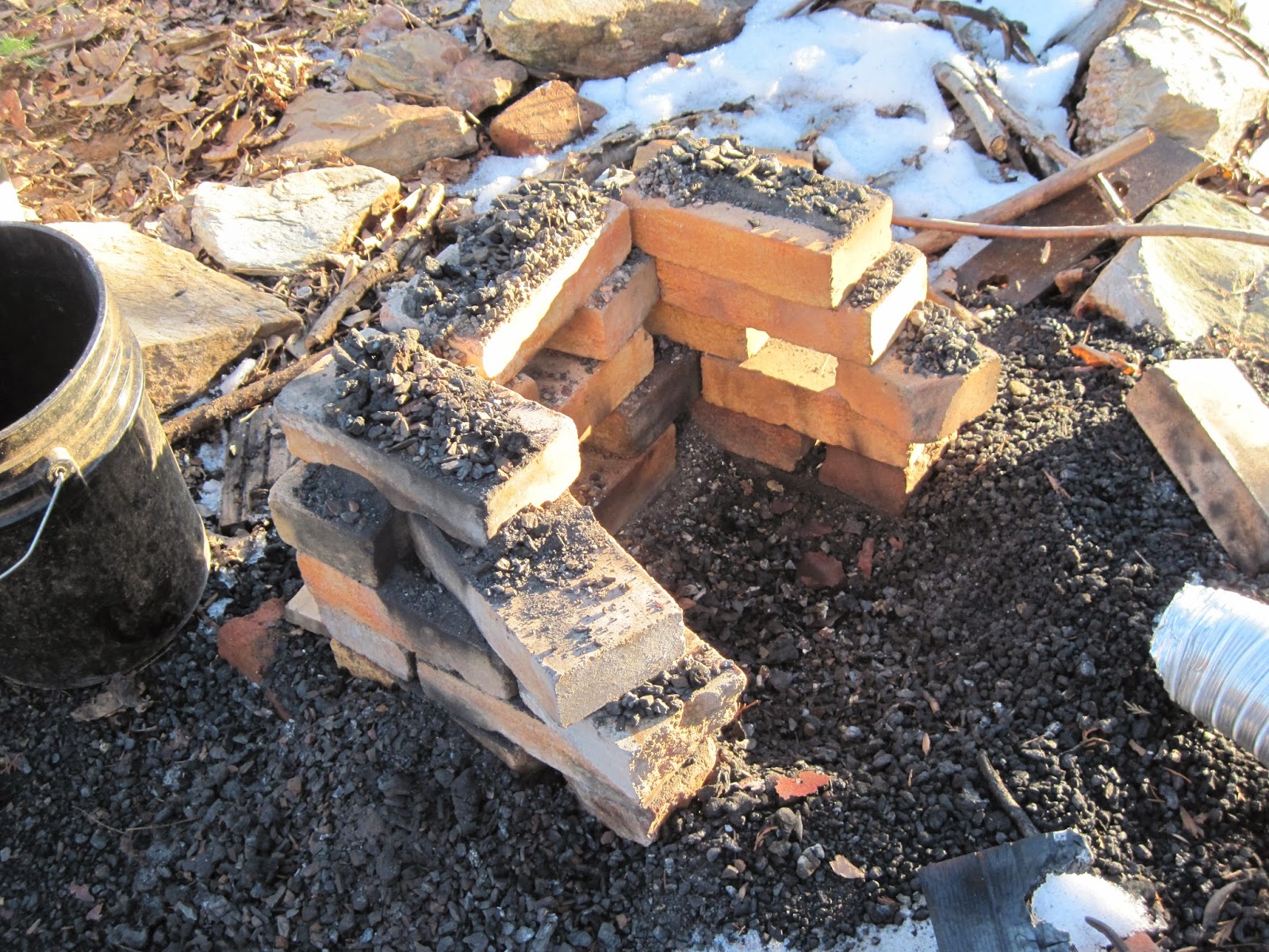

This was my original set up. I did work like this for about 6 or 7 months, which was a real drag. The fuel always fell out of the heap, as you can see from the bricks surrounding the pot.

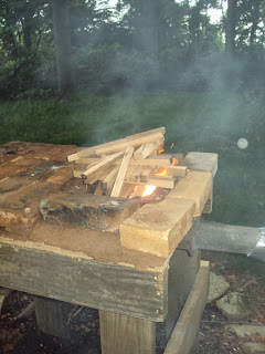

We have smoke! Ignition! Fire!
So, this forge caught fire. The plyboard was only an inch away from a hot firepot, and so it reached critical temperatures.... Back to the drawing board!
I knew that I was not going back to this rubble pile of a forge. It was just plain inconvenient!

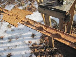

So, I measured, and began to cut the fence posts!
The fence posts spanned the wood, now devoid of the plywood. Note the T shape of the fence posts: I had to cut a notch to accommodate the posts in each piece of wood.

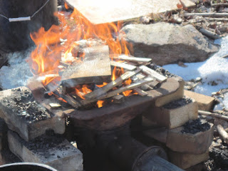

A test fitting of my firepot! This is the general idea of my wooden forge. There is between 8 and 12 inches from the wood to the firepot in any direction.

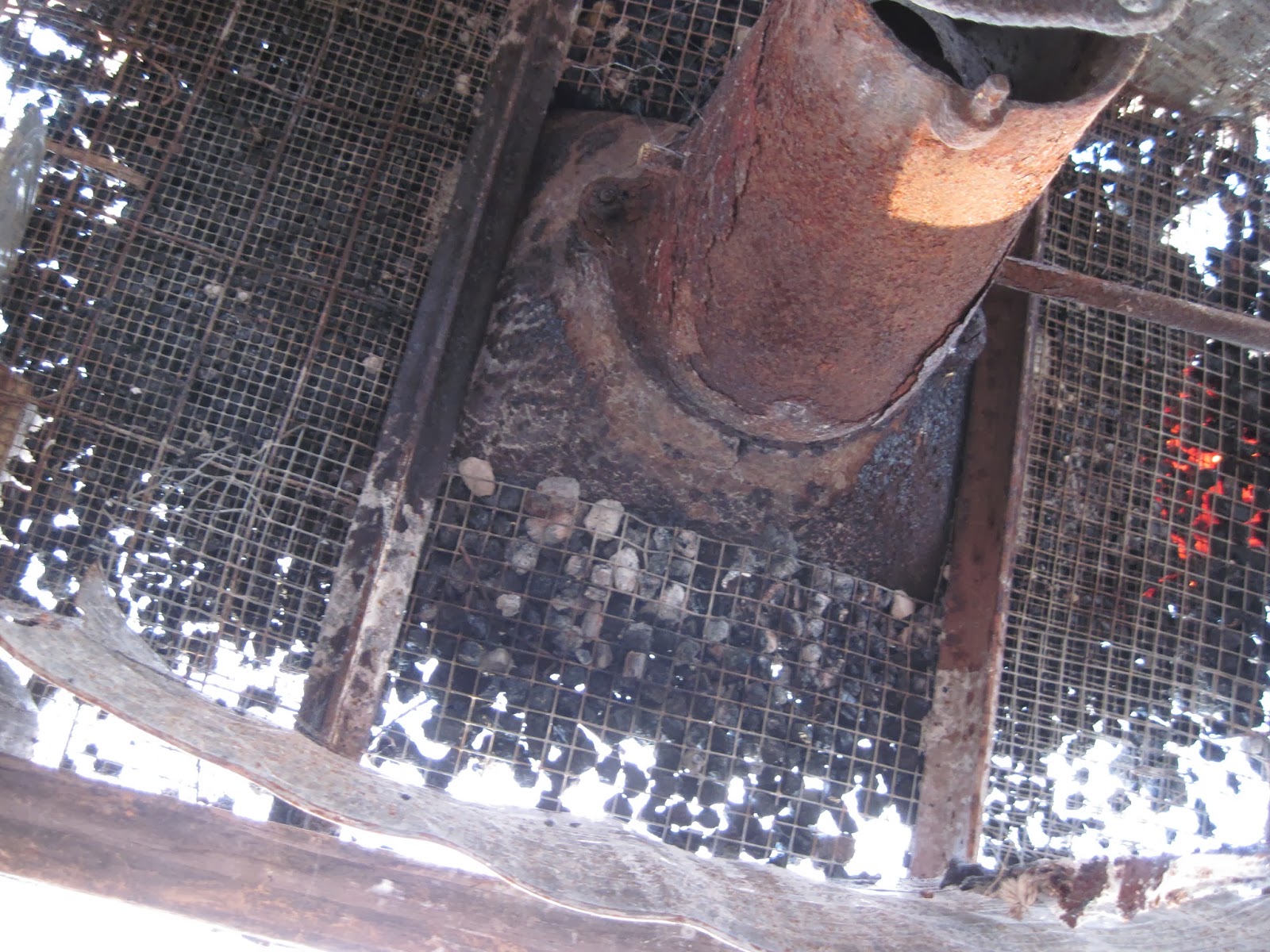

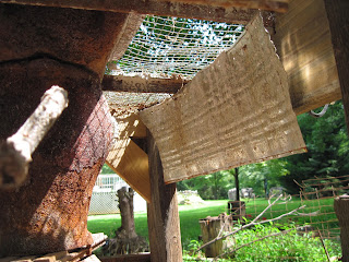

This is the underside. I added cut open steel food cans as deflectors to reflect the heat back from the wood. This added layer of insurance is great, it works like a charm.
It is tied with wire to the mesh up top.
The forge, finished for now, and with a bright fire licking coal smoke off those smooth black rocks.
The fire bricks are movable and temporary. I am not quite done modifying the forge; I would like a steel top rather than the wire mesh, but that will come whenever I can find a filing cabinet or a washing machine shell...

A view of the ash dump, held there by wire. Slightly primitive, but its what I've got.
A view of the underside after I raked away the coals.

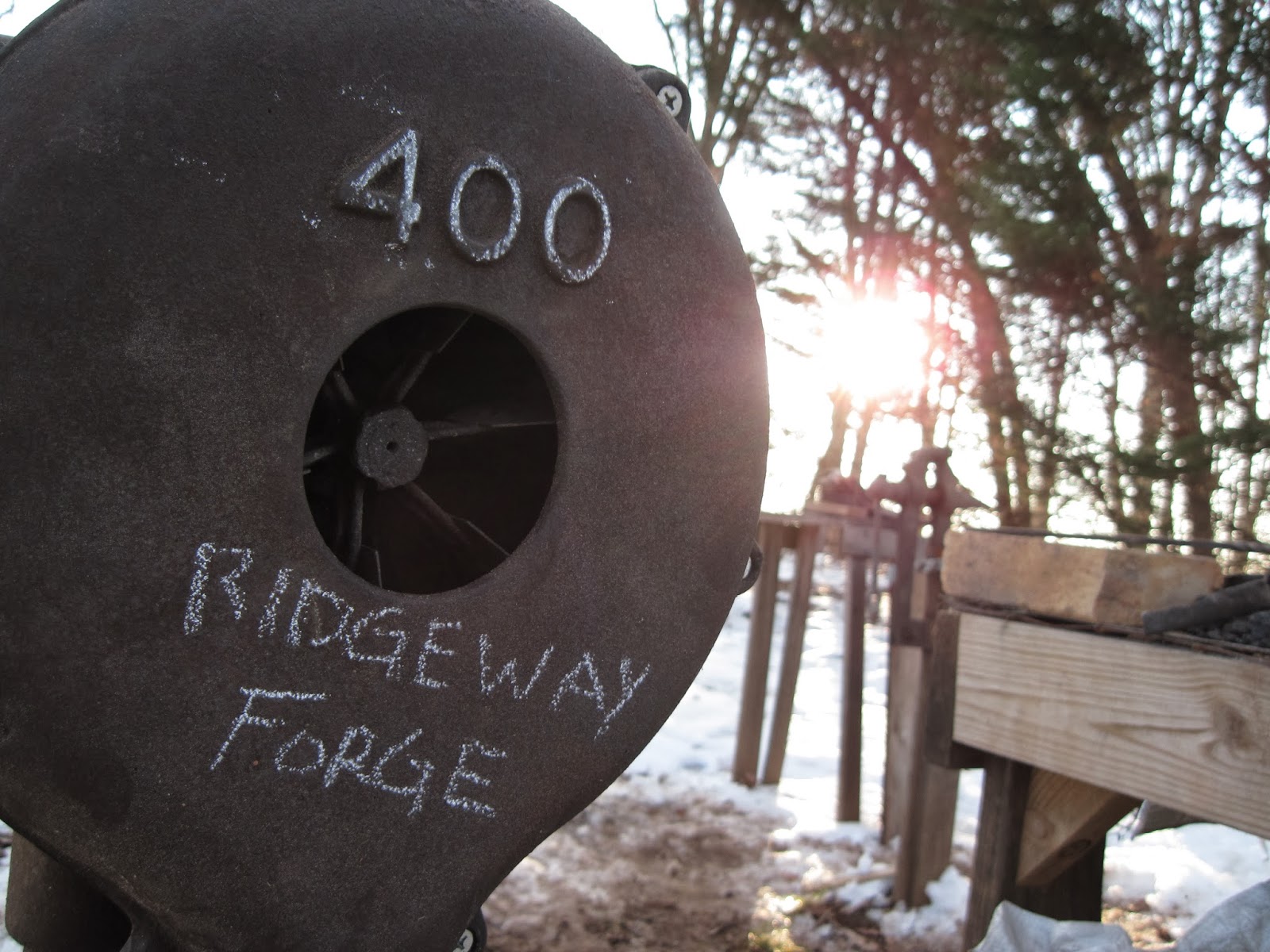

The blower, the thing that makes it hotttttt!!!
This is how I have my blower mounted:
I have the feet cut off and the tube goes straight int the stump, which has holes drilled to accommodate the piping.

I do have some picket fenceposts, but when I decided to go that route, I ate up a hacksaw blade trying to get through. I guess they are hardened steel, or some kind of rebar-like material. Although, it just occurred to me (I don't know why it didn't before...) that I could heat up the bars and hot cut them to the size. Now I feel foolish!

My only concern would be losing valuable coal through the wire mesh. I agree that another layer or two of wire and some clay or firebricks on top as your table would solve that problem. Since I save and use coal fines they would fall through the mesh.

you're right about the coal falling through. A preliminary movement of the firebricks deepened my firepot, and gave me a much better work surface. I salvaged some 1/8" springs from a couch that I dumped, and am going to try to use that to support the firebricks. I may end up using some other stock as well, and we'll see how it works! Thanks for your input, and the roof over my forge is going to come one day!!!
