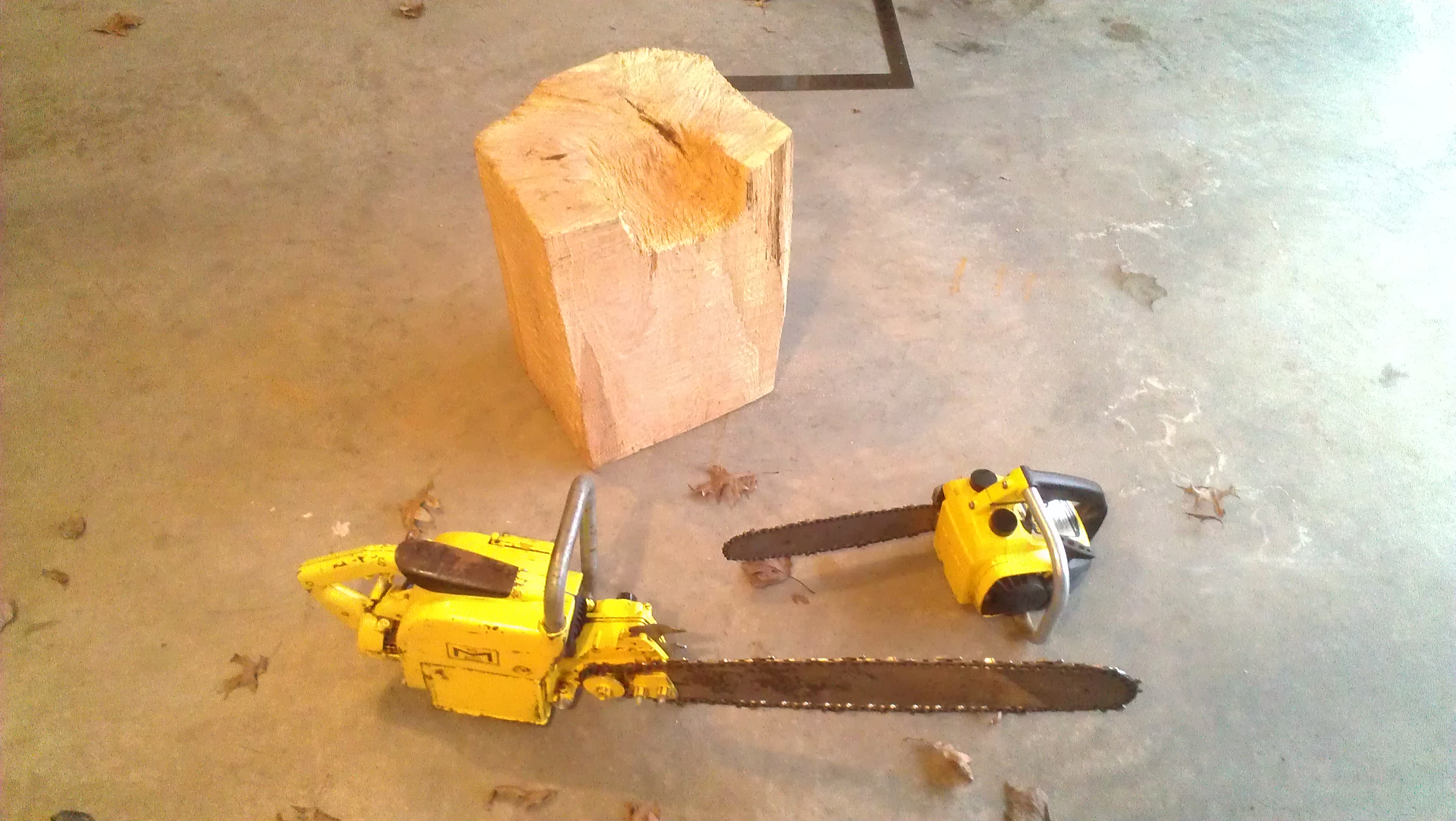

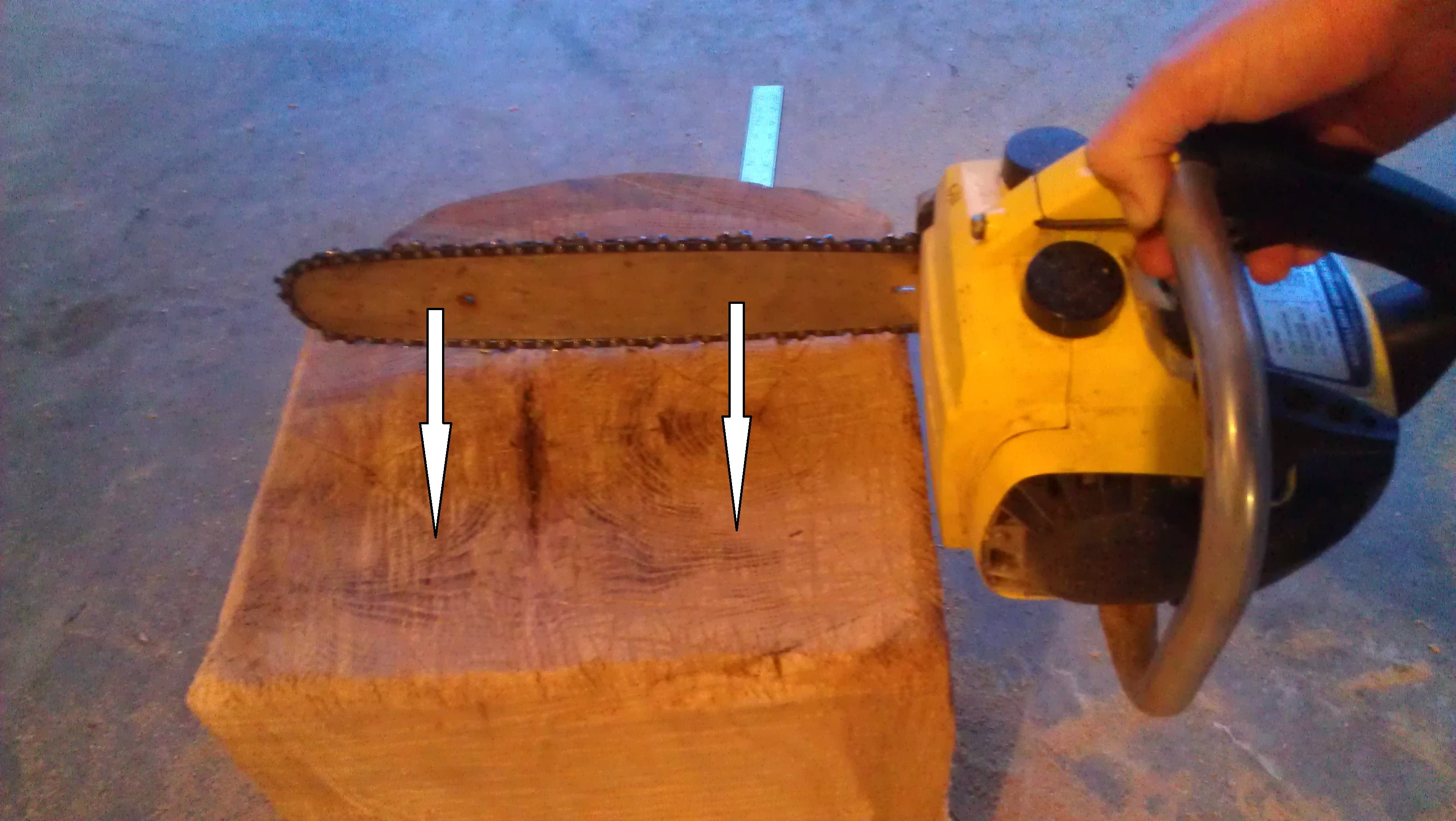

stromam Posted February 19, 2013 Share Posted February 19, 2013 Here is the stump build for the anvil I made in another thread: http://www.iforgeiron.com/topic/31084-my-first-anvil-build-looking-for-advice/ It's not quite done, but I was able to get most of it done in a couple weeknights with the help of some awesome, old chainsaws i inherited from my Grandfather. Here is approximately what it will look like. On the near side I carved a foot hole so I can stand really close and try to save my already bad back. And the far side was left uncut so I can drill some holes for tool holders. These are the two saws I used and the only two power tools used to make the stump. The big boy is a late 1950s McCulloch 35A, which needed a minor rebuild and was used to chop the three sides. The smaller one is a McCulloch Mini Mac and I used that for all the detail work. Here is a closeup of my foot hole design, it also shows how I carved three "legs" into the base. With those legs, the stump sits perfectly flat on the ground, no rocking whatsoever. Its pretty stout. Sweet litterbox in the background, huh? I have seen a few posts of people using routers mounted on sleighs to flatten their anvil stumps, I went with the less sophisticated route, it also only took about 30 minutes start to finish and it is almost perfectly flat. Here is basically how I did it: First cut the base to a tripod so it sits flat on the ground, make sure it is where you want it because after you level the face, any adjustments to the feet will throw off the level. Next get a straight edge or level and lay it across the face at various places/angles. In each placement mark the pivot point of the straight edge. That is the high spot. I just put a squiggle with a sharpie to mark all the high spots. Knock down all the high spots until the face is flat. Then proceed to leveling (you can do this the same time as the flattening step). I lay the chainsaw down as flat as I can and slide it across the face as depicted below, using very quick passes, maybe 2-3 seconds to skim across the whole thing. This brings down one side or the other, but keeps the whole thing flat. It takes a lot of passes, but at 3 seconds a piece you can do 20 passes in a minute (which is enough to take off probably 1/4-1/2 inch across the whole face). Repeat the whole process until you get it as flat and as level as you want. No building frames, sleds, etc. Just start up the chainsaw and have a straight edge and sharpie on hand. I'll post some more pictures as I finish the last details. The key to working with a chainsaw for shaping, which I'm sure everyone would learn very quickly is never to stop moving the chainsaw, if you do it bites in and cuts a deep slot. Don't even use the weight of the chainsaw, maybe only 1/4-1/2 the weight, it is amazing how quickly it will skim the surface down if you aren't careful. One question, anyone have recommendations for preserving the wood? It is still pretty wet and I don't want to let it crack too badly. I was thinking about just coating the whole thing with boiled linseed oil or a nice wood stain. Link to comment Share on other sites More sharing options...

stromam Posted February 20, 2013 Author Share Posted February 20, 2013 My anvil ended up about 1-1/2 inch short of reaching my knuckles. I tried it out a bit last night and had a hard time holding my stock level with the face without bending over. I have basically 4 options at this point. 1. I can leave it and learn to use it. 2. I can try to find another stump (maybe bigger diameter too) which would also give me the opportunity to correct some of the mistakes I made on this one. 3. I can make a spacer between the anvil and the stump either out of another stump or 2x4s or a piece of steel or something, then silicone it in place. 4. I can make a platform out of 2x4s to set the anvil/stump on top of. That would allow me to either use it at knuckle height, a couple inches lower for heavy hitting, or I could raise the platform and use it a couple inches higher for more detailed work. Thoughts/recommendations? Link to comment Share on other sites More sharing options...
aessinus Posted February 20, 2013 Share Posted February 20, 2013 get another stump & save this one for the 1-1/2 inch taller anvil you're sure to wind up with. Link to comment Share on other sites More sharing options...
PaulKrzysz Posted February 20, 2013 Share Posted February 20, 2013 Just cut a 2x4 into pieces and lay them flat on the stump and parallel to one another. Once you have them cut screw them to the stump. What is great is that the 2x4's are really 1 1/2''x 3 /12'' or something similar, perfect for you. Buy one 2x4 (about $2 where I live) and you have your solution. Link to comment Share on other sites More sharing options...
VaughnT Posted February 20, 2013 Share Posted February 20, 2013 The stump has three legs touching the ground so take three small sections of 2x4 and screw them into the bottom of the feet. This will raise your anvil without any real trouble, but it also gives you that ever-so-nice sacrificial bit that's going to rot out the soonest because it's in contact with the ground. Or, you could use a pressure-treated 2x4 lumber so that the shoes last a good long time. You definitely don't want to be leaning over as your working. As a fellow member of the bad back club, I can testify as to just how unpleasant the experience quickly becomes! Putting 2x4 risers under the stump will also allow you to get your feet under it regardless of where you're positioned at the anvil. As for coating the stump, I prefer to used boiled linseed oil that has been thinned down with acetone or mineral spirits. As has been mentioned earlier, uncut BLO is too thick to get into the pores of the wood and just sits on top. But if you thin it down 3:1 or 4:1, it's as runny as water and can get into the wood. Acetone evaporates a lot faster than mineral spirits. My favorite technique for a large chunk of wood like that is to set it into one of those cheap tin dishes they use at potluck dinners (formed tinfoil is all they are). Set the wood in that, raised a bit off the floor, then add a bunch of BLO. Then add a bunch of thinner. The end grain of the stump really sucks up the moisture if it's dry, but having that dish under it allows you to paint the BLO over the entire stump without messing up the floor. Anything that runs down just gets caught in the reservoir to be used again. Great looking anvil and stump. You've certainly proven yourself to be a handy fellow. Link to comment Share on other sites More sharing options...
