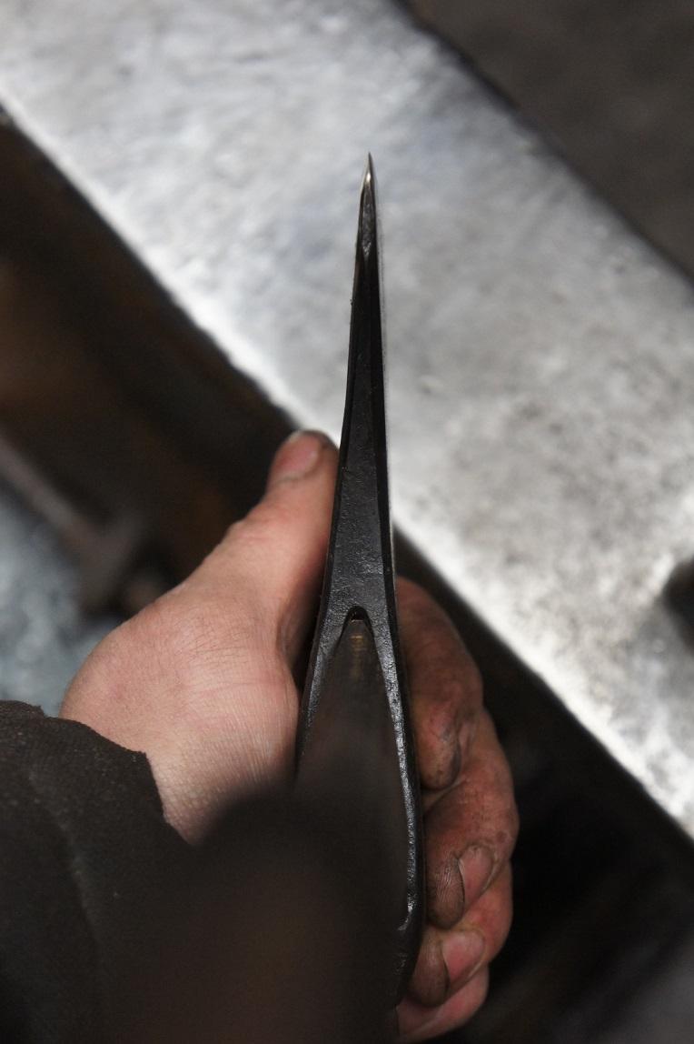

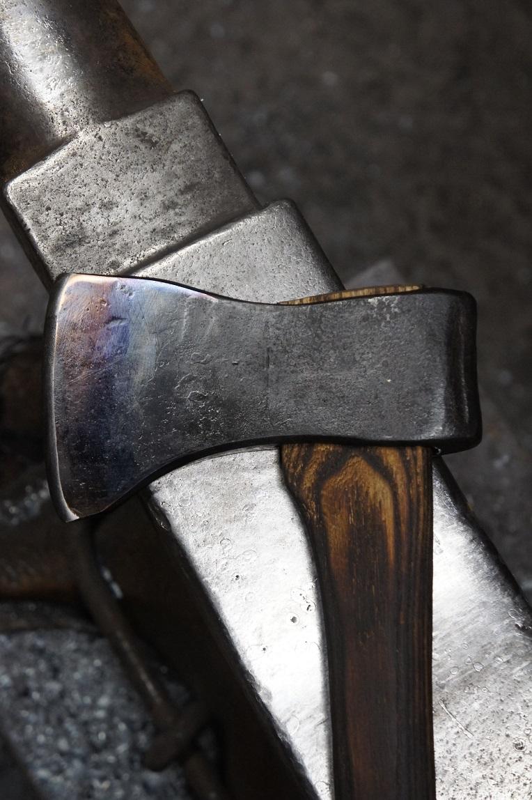

I can't necessarily say I'm hooked, but it was fun. After I heard you could bring your own axe I figured I should make one in case I go back. There are quite a few folks over there who are very into their axes and making them might be a marketable skill in that circle. I went with more of a forward swept toe this time. Sort of like your bowtie axe, minus the central ridge you added in. I figure since the point of these axes is to stick -- and more often than not it's the top half of the blade that sinks in -- keeping the material up there might help. Not sure if that logic will hold, but I guess we'll find out. Latticino, he taught you, you taught me and so the line continues. It does work quite well to clean up that area.

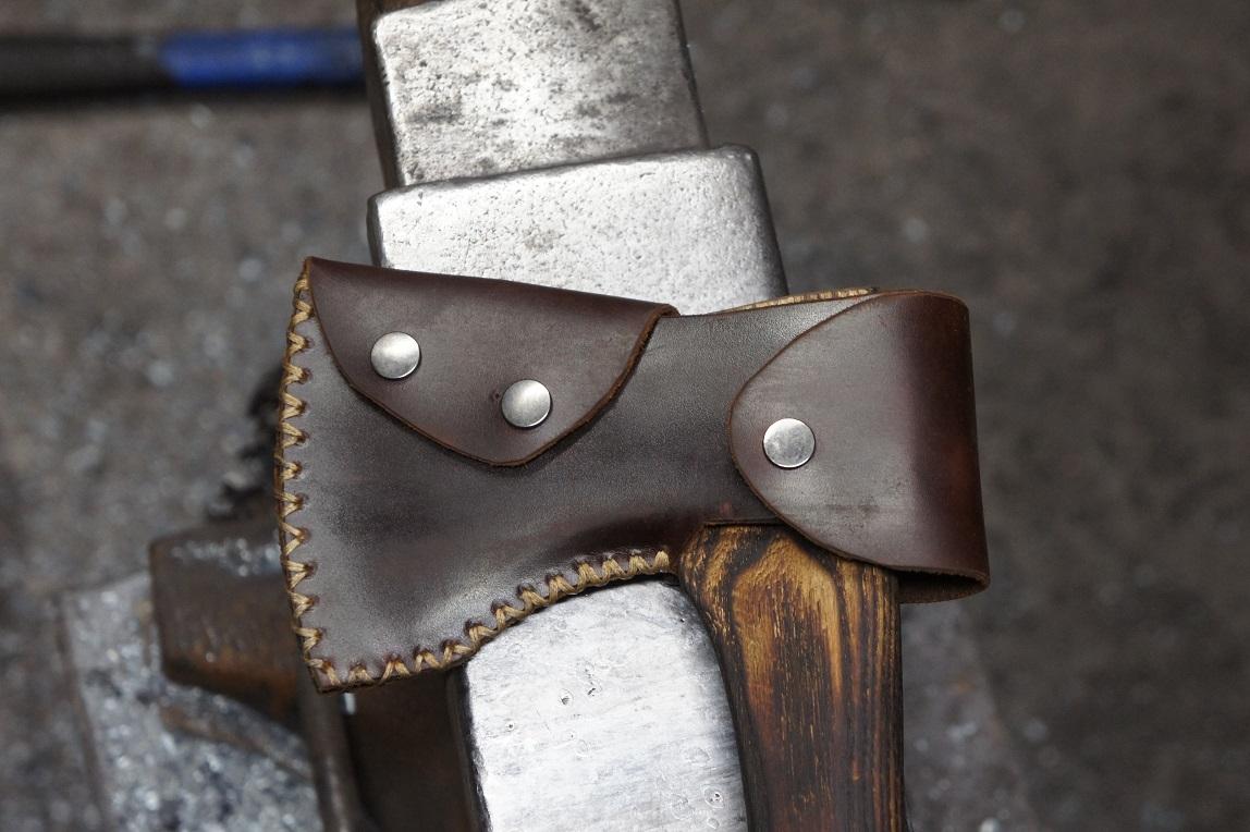

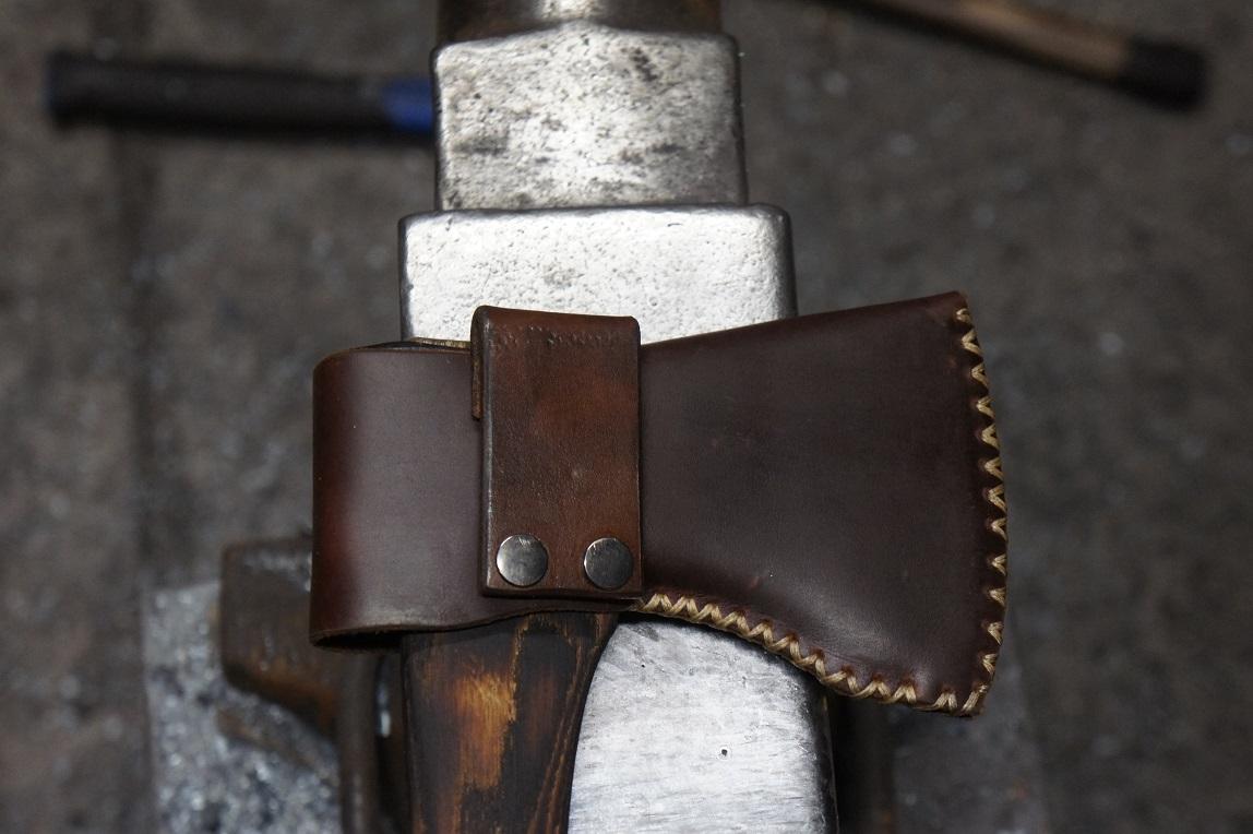

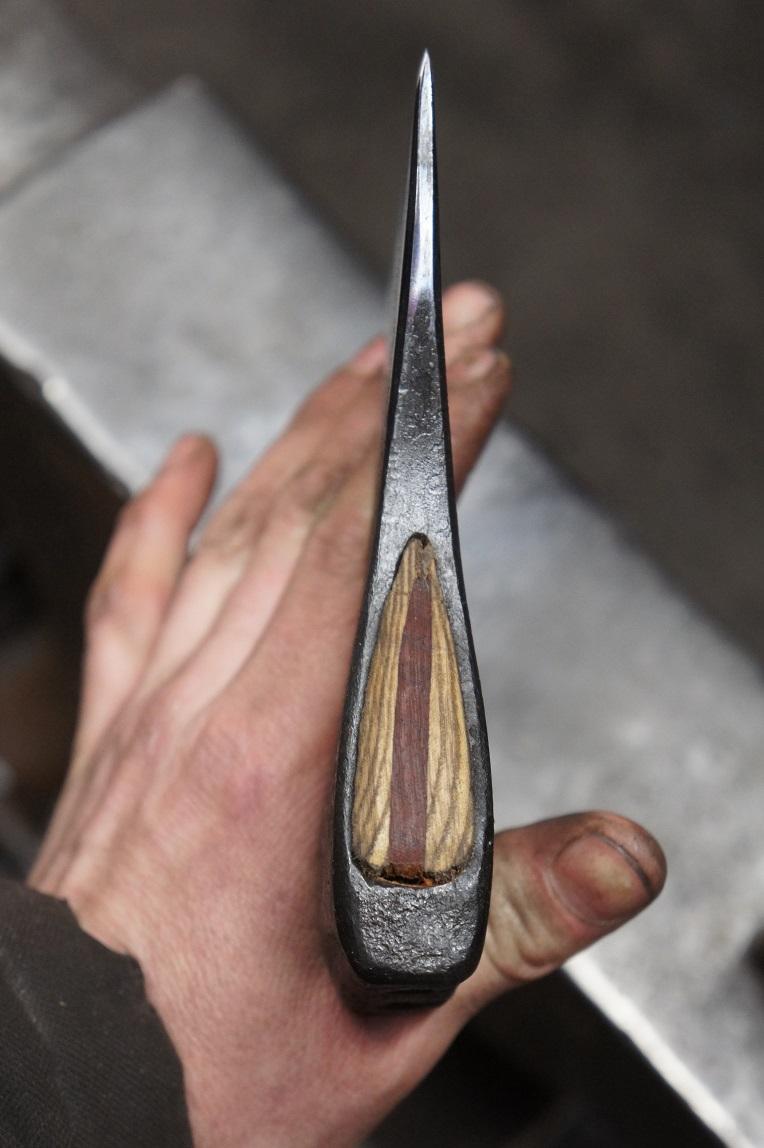

I went to one of those axe throwing bars a little while back and after talking to the employee working our lane I decided to make a throwing axe per the World Axe Throwing League specs. The head weighs 1lb 9oz, blade width 3.5", overall length ~14". Wrapped and welded, mild steel body HC steel bit. Tempered at 475F, then differentially tempered for the colors Naturally it needs a case with a belt loop. And last, but not least, eye pics for Jennifer. I had to use Latticino's round chisel trick (mentioned on page 10) on this one. It works a treat!

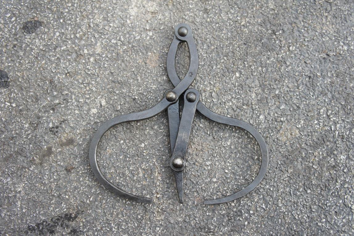

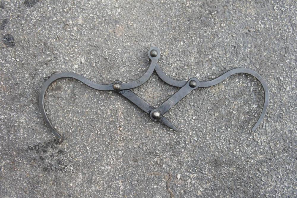

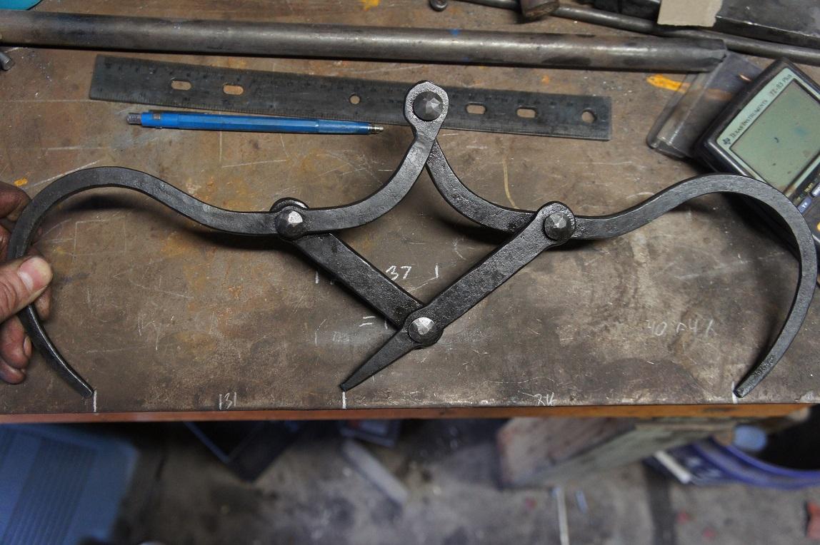

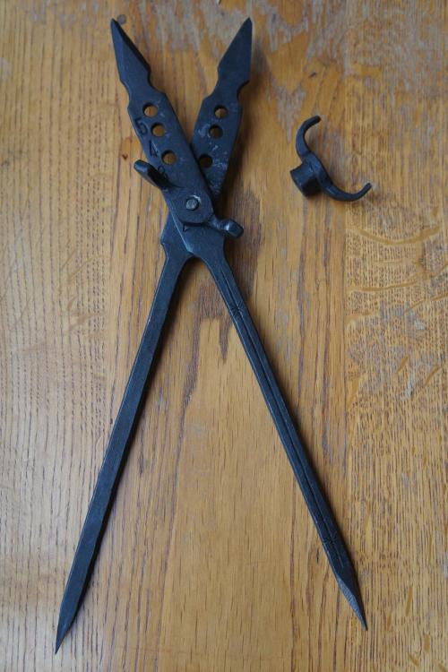

Not quite as fancy as yours John, but here's a set of home brewed dividers. They're limited to 2, 3, 4 and 5 to 1. -

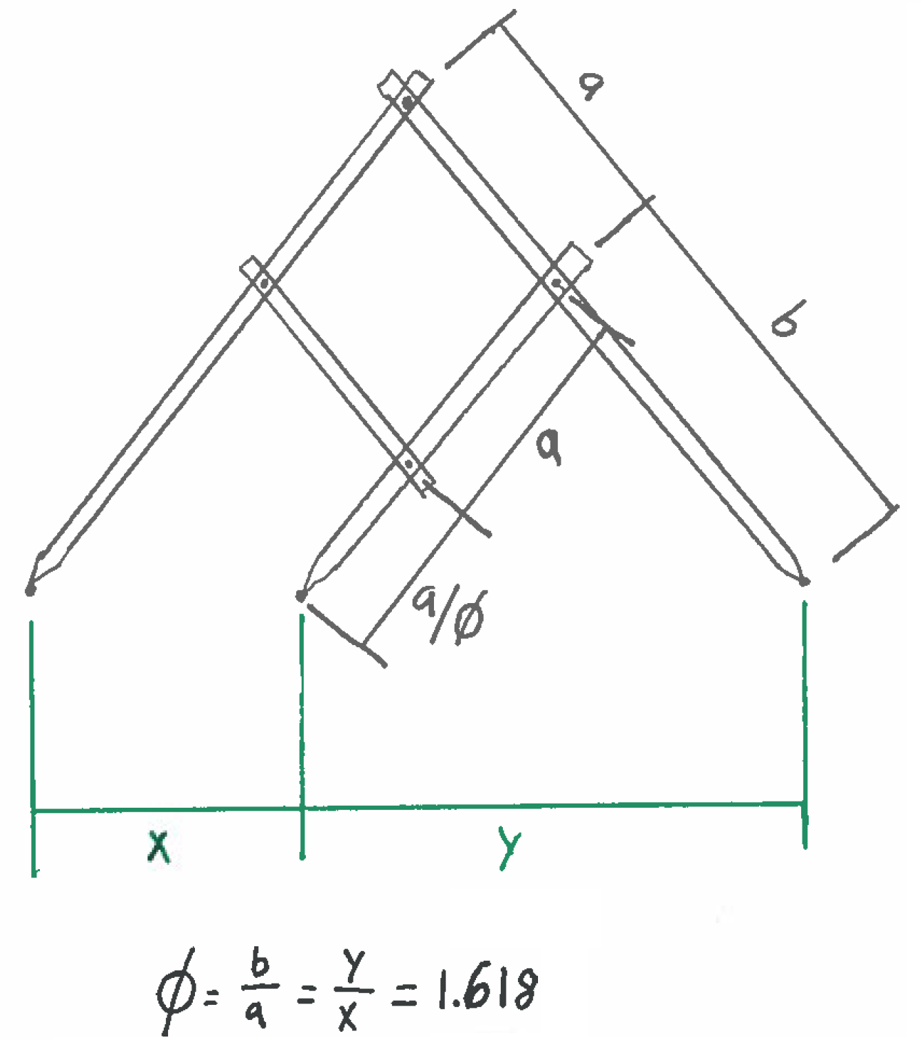

I'm guessing you meant 34 not 44. i.e. 34/21 = 1.619 Now I have Lateralus stuck in my head. -

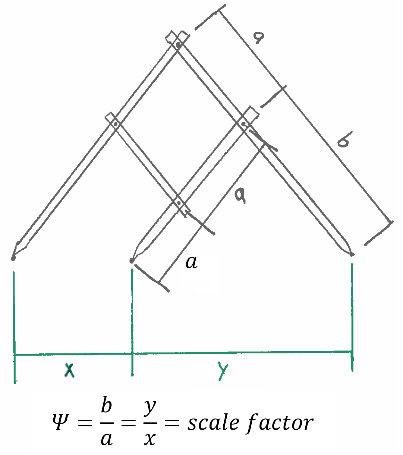

For folks who aren't confident that they can forge this style a pair of golden means calipers, they can be made with flat stock and minimal forging. The measurements given in Josh's picture 7th from the bottom are all you really need and can serve as a reference. They can also be changed as long as you follow the proper ratio. I made a doodle that may help. The ratio can be changed to something else (1:2 for example) as follows: Granted you could also make a set of X shaped proportional dividers if you want to divide into 3rds, quarters, etc. with the same tool... but that's less fun. -

I was thinking of changing the ratio to 1:2 and adjusting the long side to the length of the stock then using the short side to find the center. -

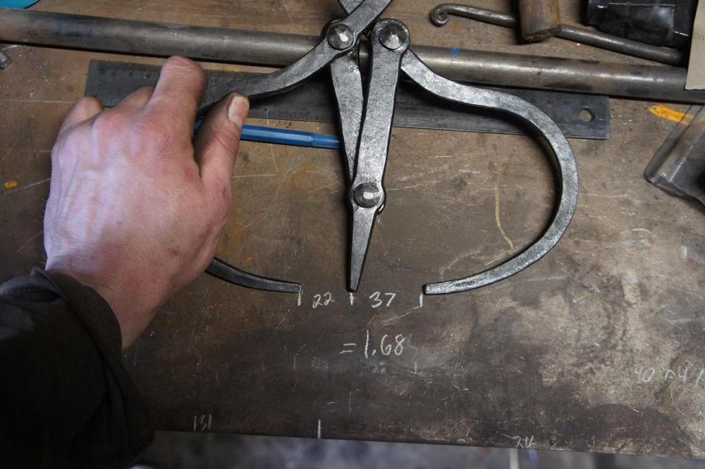

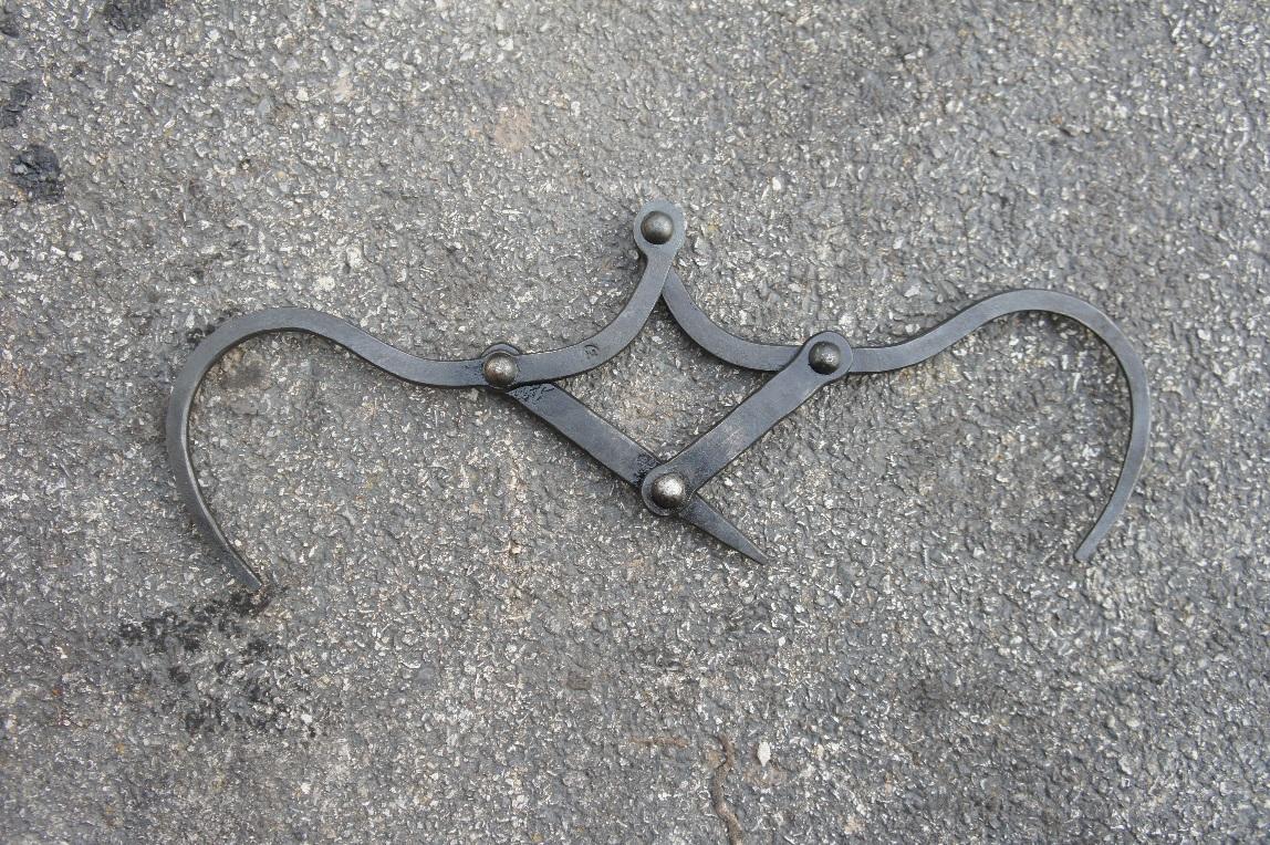

A fun piece. Thanks for sharing Josh. I need to work the rivets a little more to get the full ROM.. Close enough, though slightly off. At fully closed I get a ratio of 1.68. At "fully open", 1.64. I can probably file the tips to clean them up and get a better line. These are as forged.
