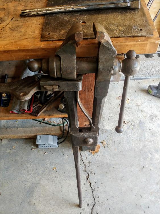

  4. Acquired my first post vice. Found it at our beloved Avon Flea Market. It looks like the foot may have been cut, but aside from that it's in excellent condition. The screw is in beautiful condition, the still a little bit of tooth on the jaw surfaces, the spring is springy, and there are no bends on the handle to indicate abuse. It's a smaller vise but I'm thrilled to have it and excited to get it mounted soon. Can finally stop abusing my bench vise. On one of the jaws I can make out the words in variable degrees of wear in this order: Columbian Cleveland Original Trenton 1903 35 Is 1903 the year it was manufactured, or does that indicate something else?
