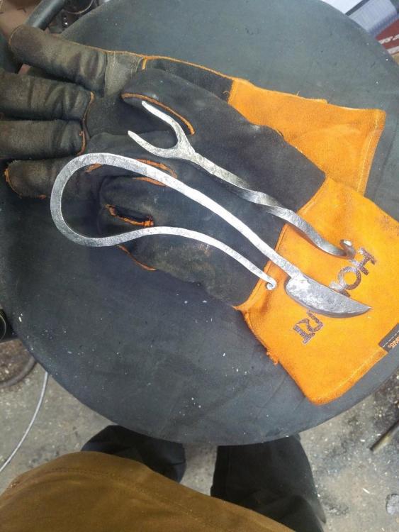

  2. Forged a fork and a knife. I wish I had done the knife a bit longer and wider, but I'm pretty content with how it turned out otherwise.
