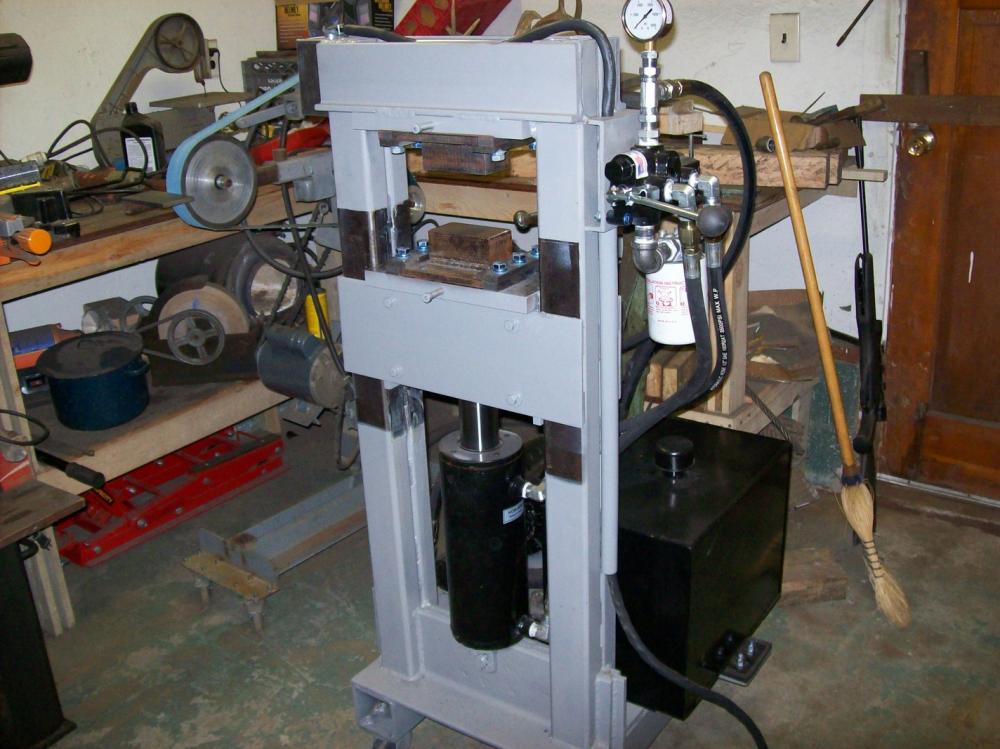

  10. whodoamb replied to whodoamb's topic in Presses
    Cylinder is from International Hydraulics. They sell splitter parts and dump bed parts general hydraulics,The most compact 5 inch X 8 inch I could find. Search on google should get you to there site.

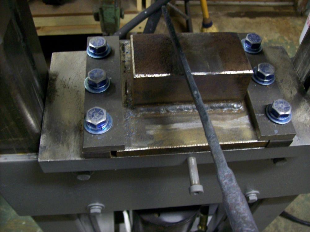

  11. whodoamb replied to whodoamb's topic in Presses
    Bolts in front are shoulder bolts for a toggle latch. Just need to get some the proper length. See pic of first billet started as 9 layers,5 - 1084, 4 double layers of 15n20, Currently at 81 layers,one more draw to 243 then on to a knife! 1084 from Aldo, 15n20 from free bandsaw blades from day job,see pic.
  12. whodoamb replied to whodoamb's topic in Presses
    No there is 1/4 inch space between cylinder and mount. You have to realize that the pin is hardened so it ether has to break the pin or stretch the hole. Nether has happened yet thought I have only gotten to use it once, see photo 3/4 inch straightened coil spring.
  13. whodoamb replied to whodoamb's topic in Presses
    I thought the same thing about the flanges on the cylinder,but it has a column load rating of 58,900 lb. The little tab's are 2 inch by 3/8 1045 per spec's for cylinder. Bolts for guide plates are 3/8 grade 8. Bottom mounting and top slide mount are 1 1/2 thick. Uprights are 2 by 3 by 1/4 doubled to make a 4 by 3, Bottom mount 6 by 1/2 plate sandwiched between 2 - 6 by 4 by 1/2 angle 13 - 3/4 inch plug welds per angle.
  14. whodoamb posted a topic in Presses
    Not new here but my first post.Just finished Sunday haven't had time to see how well it work,s yet!
