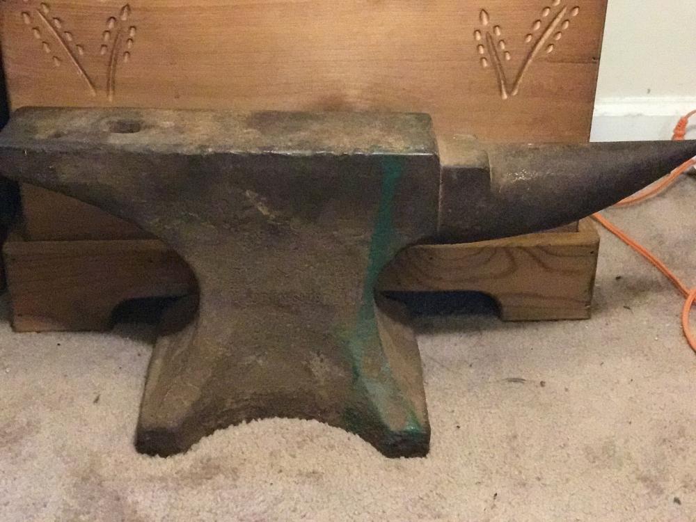

Afterhourcrafts Posted May 28, 2017 Share Posted May 28, 2017 So it's a solingen swedish steel anvils that weighs 94lb. I know it's over 80 years old but I can't find any references on it. Can anyone recognize it? Quote Link to comment Share on other sites More sharing options...
Frosty Posted May 28, 2017 Share Posted May 28, 2017 Welcome aboard Afterhours, glad to have you. If you'll put your general location in the header you might be surprised how many of the Iforge gang live within visiting distance. I didn't have any luck looking either, Solingen is the registered trademark of a town in Germany and all the references I found including anvil in the terms came back to guys asking for an ID on different fora including Iforge. I hope knowing it's history isn't too big an issue for you, my experience says if it's a cast Swedish steel anvil it's top shelf with a few quality control exceptions. She's a beauty. Frosty The Lucky. Quote Link to comment Share on other sites More sharing options...

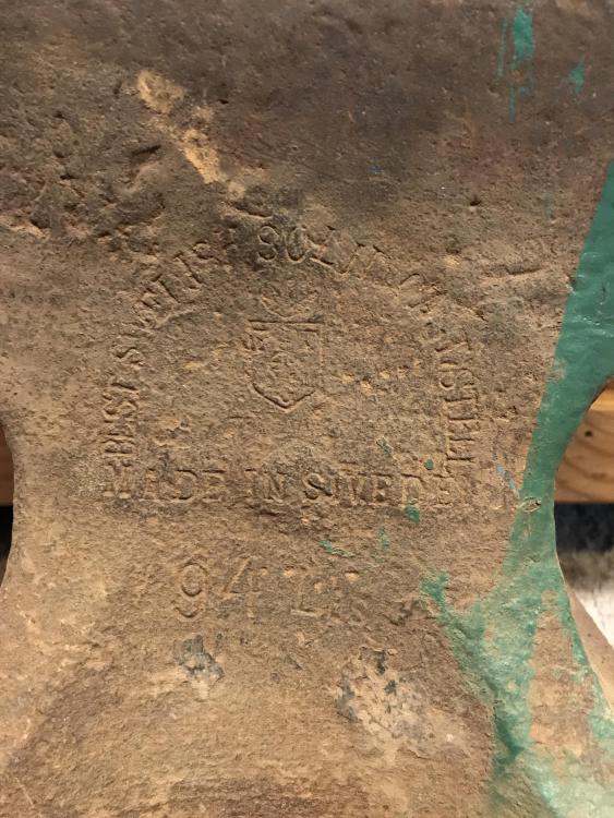

whodoamb Posted May 28, 2017 Share Posted May 28, 2017 I think what it say's is Best Swedish Solid Cast Steel makers stamp in the middle Quote Link to comment Share on other sites More sharing options...
ThomasPowers Posted May 28, 2017 Share Posted May 28, 2017 Says Made in Sweden how do you get Solingen a town in Germany???? Quote Link to comment Share on other sites More sharing options...
Black Frog Posted May 28, 2017 Share Posted May 28, 2017 Soderfors anvil. That is an older style stamp. Quote Link to comment Share on other sites More sharing options...
Frosty Posted May 28, 2017 Share Posted May 28, 2017 6 hours ago, ThomasPowers said: Says Made in Sweden how do you get Solingen a town in Germany???? I can't read the anvil very well so I was going by what the OP said was there and Googled Solingen, anvils, Swedish cast steel, etc. Tried lots of combinations of the terms. The town in Germany was the ONLY Solingen that came up in the first 100 hits or so. I didn't know how a cast Swedish anvil and a town in Germany tied in either. I wasn't clear enough in calling no joy and heck just confused my own darned self. I've done that twice today. <sigh> Frosty The Lucky. Quote Link to comment Share on other sites More sharing options...
Marc1 Posted May 28, 2017 Share Posted May 28, 2017 Solingen was famous for it's steel and was a blacksmith hob for a very long time. Quote Link to comment Share on other sites More sharing options...
ThomasPowers Posted May 28, 2017 Share Posted May 28, 2017 Sweden was famous for it's iron and steel for centuries too; (oregrounds iron for blister steel making you know) The question is the OP said Solingen for the an anvil marked Sweden in several places---how did he get the idea Solingen was involved? Shoot I've been to Solingen and went to the Deutsches Klingenmuseum there. What we need is a clear tracing of the shield on the side to start trying to match with a manufacturer. Quote Link to comment Share on other sites More sharing options...
