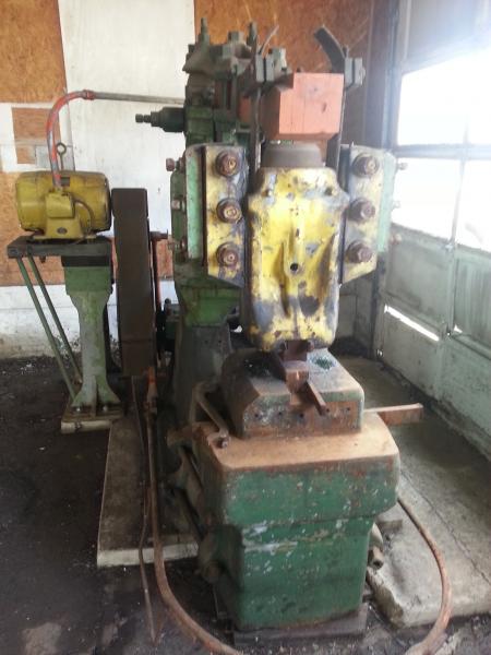

  12. My 300 lb Bradley has aram thar weighs 460# and I know of another one just like it so I do think this was common for them but I know they changed over the years too because I have a spare ram for that 300 # hammer and it only weighs 325# sans die.
