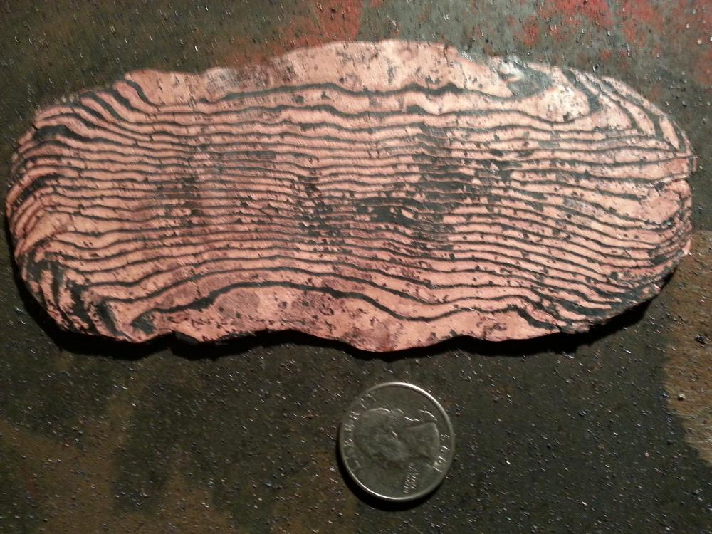

I have both the Ferguson and Midgett books and they are both very good. Ferguson's work is all based on bonding in an inert atmosphere with pressure applied during heating. He even made special dies to contain the work piece on all sides while pressure was applied. It is a very interesting technique, but not practical for most folks. My customer is doing the bonding and sends me billets ready to forge. He is using a technique much like what is described in Midgett's book with bonding temps around 1800 F. His process is extremely effective provided all the surface are clean. I agree I don't think I'm melting the layers. I think I'm just a few degrees cooler than that. At the point in the process where this is happening, a billet with 88 layers originally 2" thick has been forged to a thickness of 0.375. Assuming the starting stock is uniform in thickness (which I don't know for sure), the layer thickness after forging to 0.375" is only 0.0042". At this point, the billet is patterned via machining and sent back to me for further forging to 0.220" thick. It is during this second forging step that problem is happening. I'm wondering if the combination of temperature, time at temperature and very thin layer thickness are all working together to cause this problem. It is not showing up in other billet sizes or billets in which the starting layer thickness is greater.
To see finished products made from what I've forged look up William Henry Studios. Most of the Mokume they use is supplied by Mike Sakmar, who is my customer. You can also look at his website for images of stuff we've done. Some of the coolest work I've done is to forge large billets that are milled into cell phones. Do a google search for "mokume cell phones" and you'll find lots of images of those. I've forged something on the order of 150 billets just for that product. As far as eutectic formations, that is a function of composition and temperature, not really time at temperature. A eutectic is the one unique composition that has the lowest melting point. The classic example of this is with copper and silver. Not all alloy systems form eutectics. I'm working with copper, red brass and nickel silver. The constituents of those are copper, zinc, nickel and tin. Copper and nickel do not have a eutectic. The copper/zinc and copper/tin do but those alloys are already combined in the red brass and nickel silver so they will melt rather than form a eutectic. The melting temps of the alloys are as follows: Copper-1984 F Red Brass-1832 F Nickel Silver-1870 F Diffusion could be accounting for what is happening and this is very much a time and temperature dependent phenomenon. The billets in question are laminated with all 3 of the alloys listed above and the copper/red brass layers are the ones that seem to be washing out. I find this a bit odd since most of the time overheating of this material will result in actual melting of the brass and it will squeeze out or even splatter if you hit the billet when it is this hot. I've had a few billets where this has happened and if you catch it without hitting and let it cool you can still successfully forge it. Interestingly, I've not had feedback that these billets had the washed out appearance. That makes me think I'm dealing will something that is very time dependent within a particular temperature range. I'm really interested to see the microstruture as that should give me a pretty good insight into what is happening. If I'm getting too hot, I could have both the copper and brass layer melting and mixing together, but I would think that that much melting would have been notceable during forging. For those interested, feel free to PM me or start a new thread with any questions on mokume. I'll do what I can to answer.
I'm pretty confident it's not a material issue. I've heard of the same thing happening in some damascus billets. Over the last few years I've probably forged something on the order of 4000-5000 lbs of mokume, always supplied to me pre-fused so it is possible it a material issue. My customer, who supplies me the billets for forging to his sizes, is going to send me a piece of what he's seeing and I'll do some metallography on it to confirm the root cause of the problem. I wanted to do a new forge anyway so this is good opportunity for that, even if the problem I'm trying to solve is not temperature related.
As you may know, most of my forge work over the last few years has been production forging of Mokume. Lately, I've had trouble with over heating. The billets are not melting, but the brass and copper layers are diffusing into each other and resulting in billets that should have 3 colors only having two. My plan to fix this is to build a new forge, which I've been planning on anyway. The dimensions inside will be 20" wide, 24" long and probably something around 12" high. Roof and walls will be 4" thick kaowool. Floor is hard splits over 2.5" soft fire brick. I'm thinking of a 4 burner arrangement with two on each wall, off set so that the burners don't blow right at their counterparts on the opposite wall. The burners be mounted fairly high in the wall because I don't want them blowing on the work and making hot spots. I'm currently using a 2 burner arrangement made from 2" pipe with a couple of smaller pipes nested in the flame end of the burners. System is forced air/propane. It works OK, but with both burners on one wall, you don't have good uniformity. You can get it if you're running hot as when forging steel, but most of what I do needs to be done at around 1800 F. My thought is to scale down this burner design and go with 4, but I'd like to get the input of others on this. I'm also planning to incorporate at least 2 thermocouples into the forge. I'd like them to be permanently fixed in the walls. With that arrangement, they would need to be able to withstand the temps for forging steel since it do that on occasion. Any recommendations on specific units I should look at and places to purchase same? Thanks. Patrick
