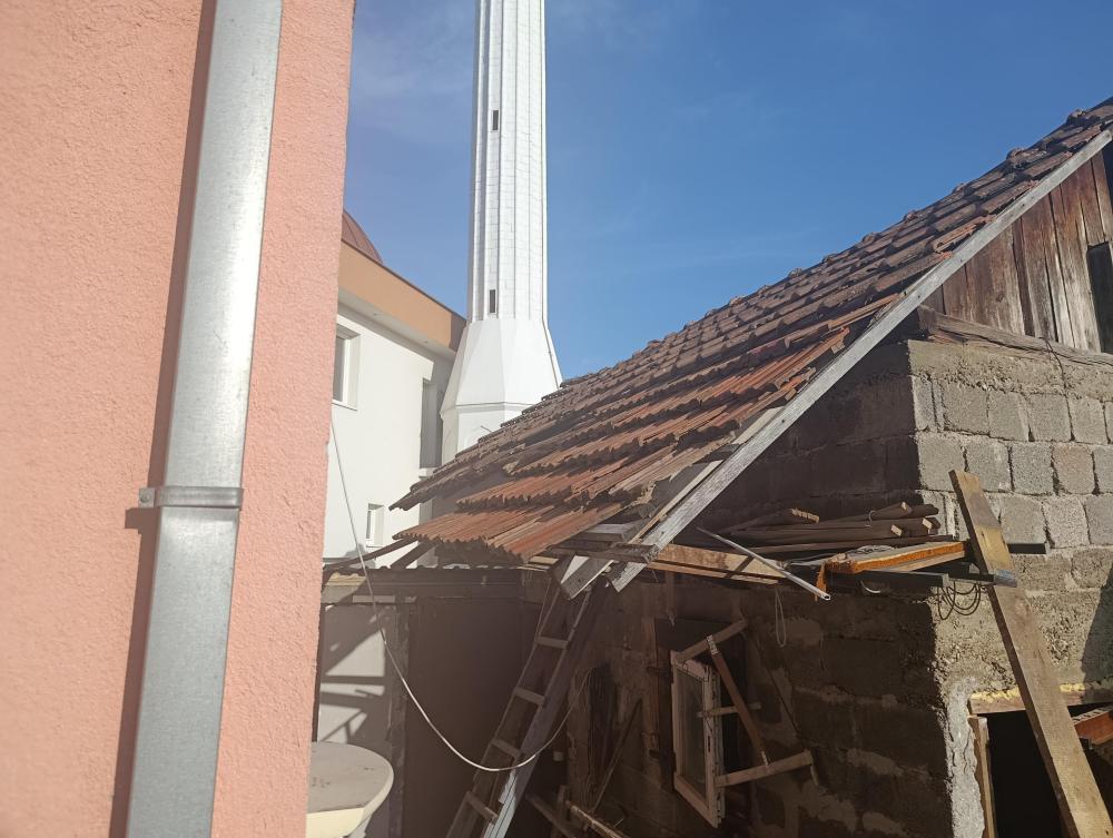

  9. Yes it is , I now need to put roof over it it would be 2 by 3 1/2 beams . I thought to put 4by4 but I won't. Then need to go 2.5 by 3 sticks and ove it goes "roofing material" Wich look like it was build as brick. Classic European roofing style The space Between long stick must be measured according roofing dimensions. To make same distance between roofing material jig from wood is made. We measure from hook of tiles to bottom of tiles . Hooks are not seen in images but they are under plate , and they serve purpose so material hook to long sticks and it hold it.

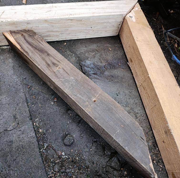

  15. Another one was made today . Had one oak scrap part and used it as disgonal

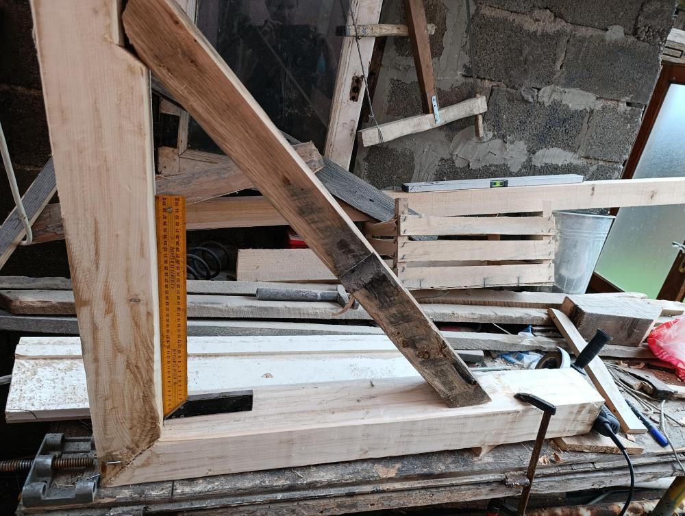

  17. Her is my progres on building awning for my shop. I plan to make it woodworking more efriendly because of rain and I today build one gallows bracket . Plan is to copy this system on other building First screws were used to hold beam at place then down 7 cm nails were used to nailed from side about 2.5 inches. Then I used 4 inches nails to nail this construction together. Cuts were made at angles too . 45 degree and bracket was made using layout from L shape where it went diagonaly. Hold excellent , need to make another one. Timber used for construction is 4x5 . Length is to accomodate my space above door and under roof about 30 inches long beam And I made some decorations on it It will be mounted using those long threaded rods that will go through wall and from other side another wood plank to act as washer and metal washer too
