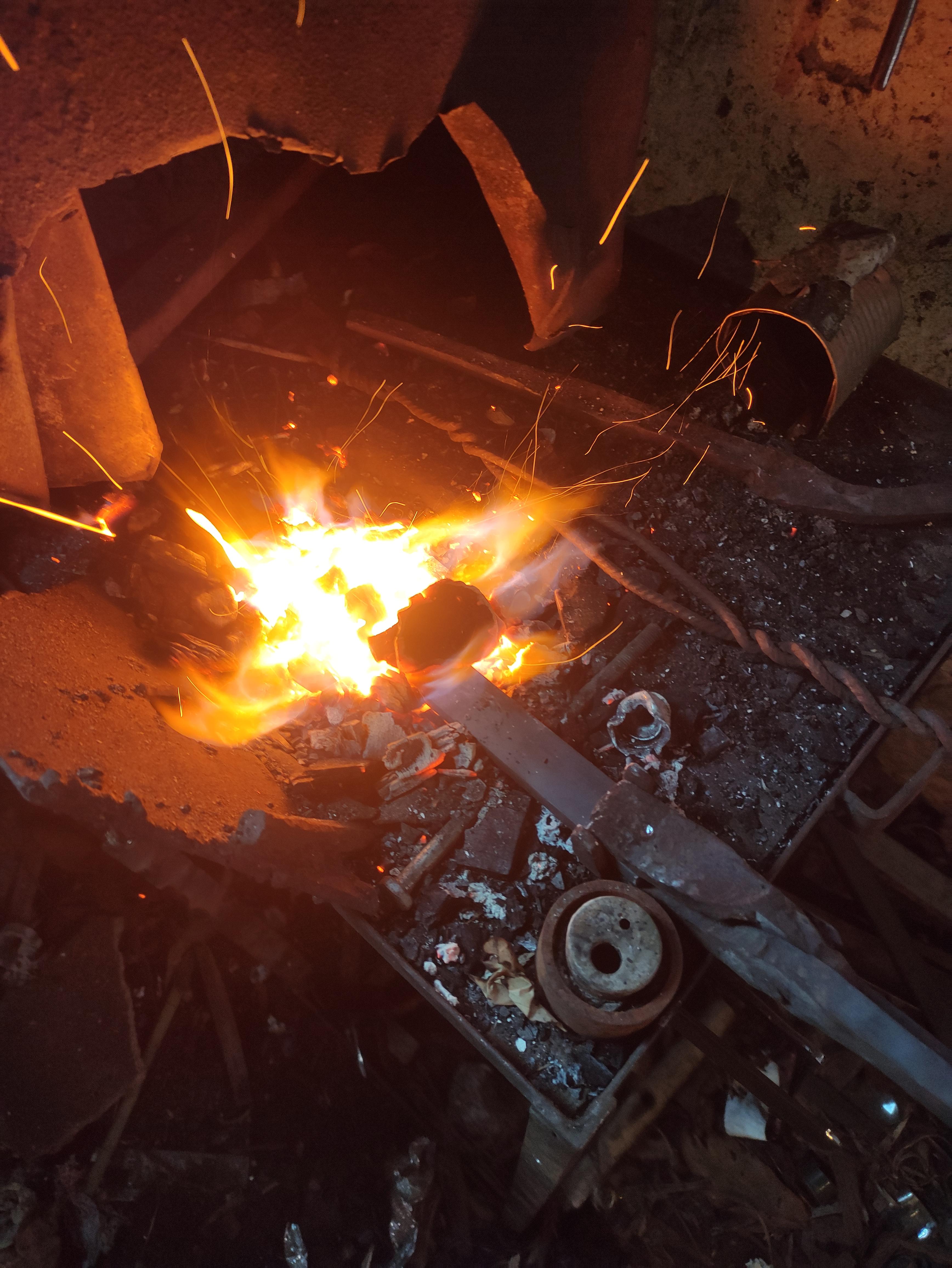

  1. Well same topic it's look like frosty had right about forge welding two carbon steels , I tryed to forge weld mild steel and leaf spring (which is high carbon steel I presume ) . Had some sparks but I don't think I turned it too much. I have feeling that I forge welded one part and other just got squished to leaf spring part I cheated a bit with tacking using stick welding , cause darn thing was flipping on me couple of times

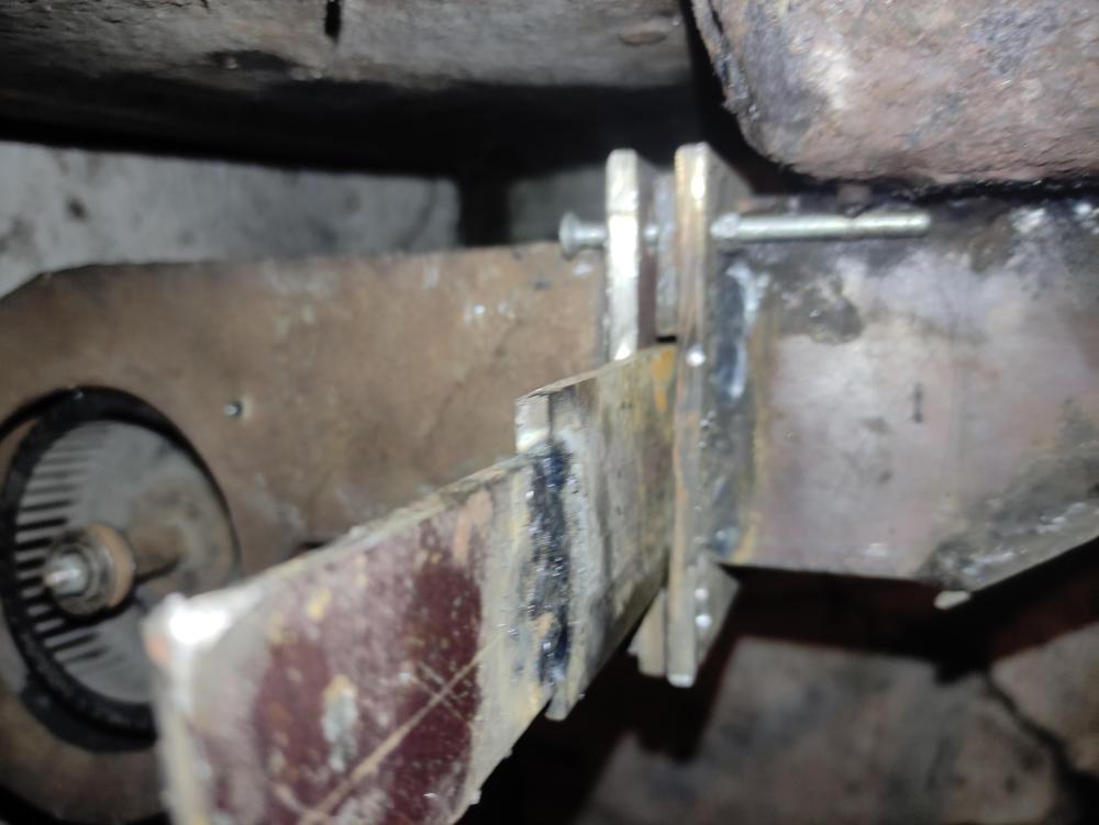

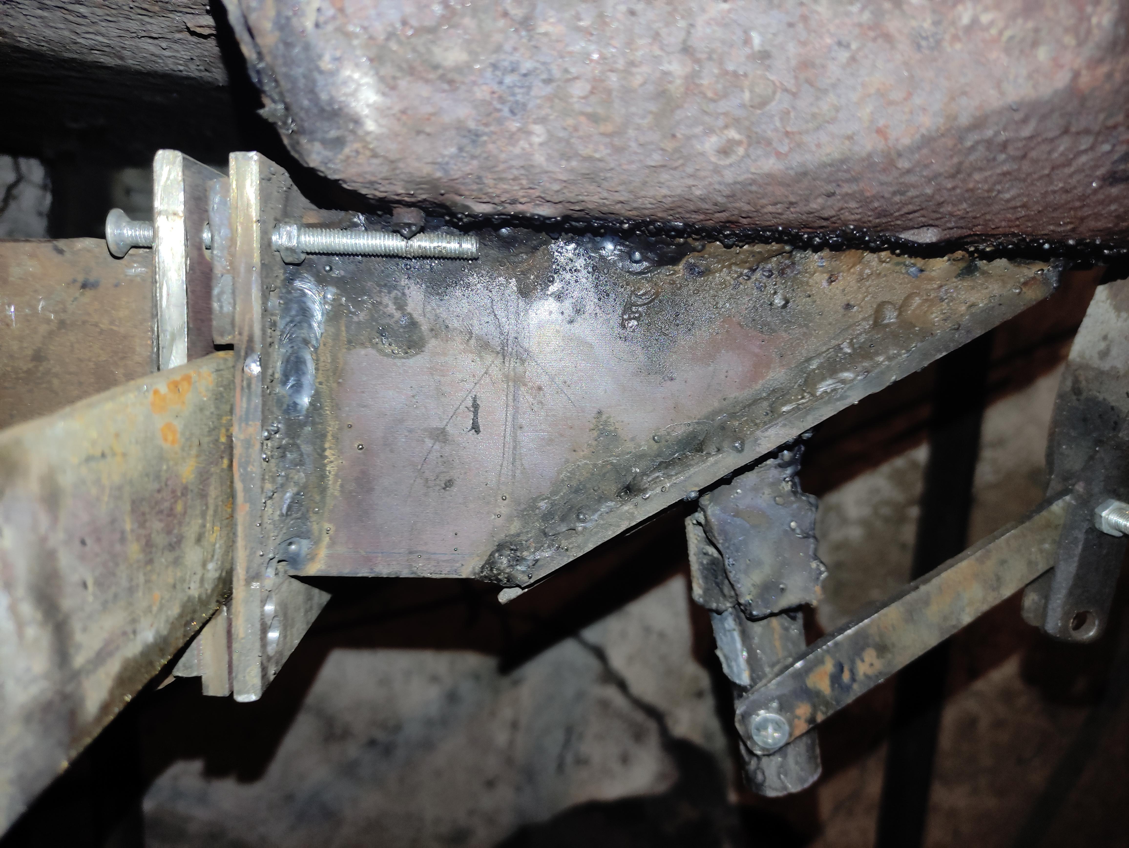

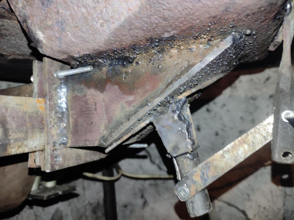

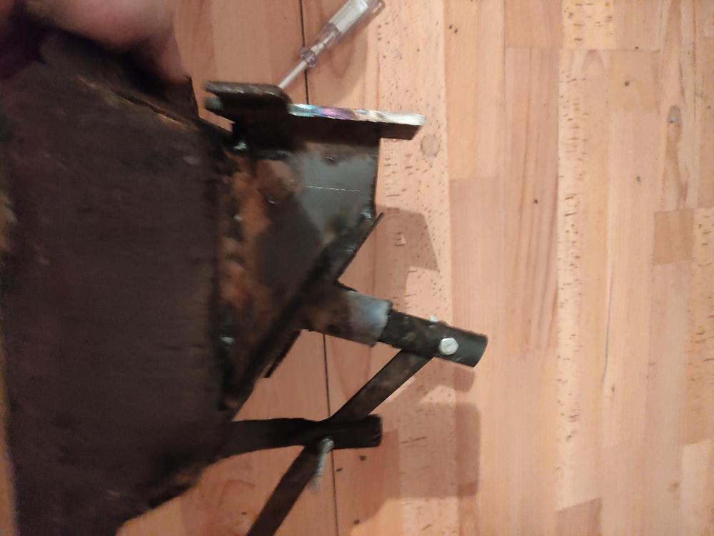

  17. Ash dump and air gate handle made , pretty much it can work normaly now

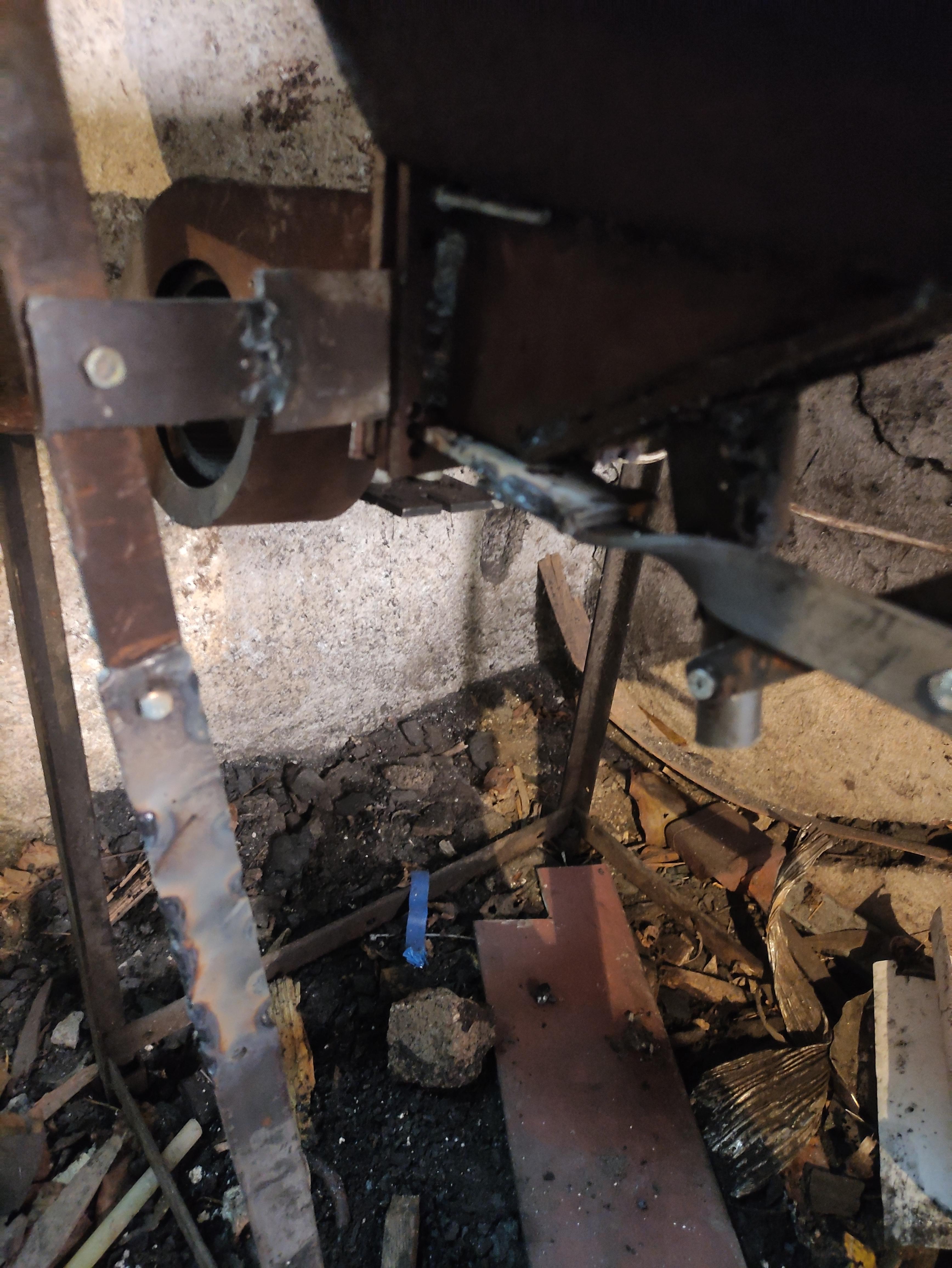

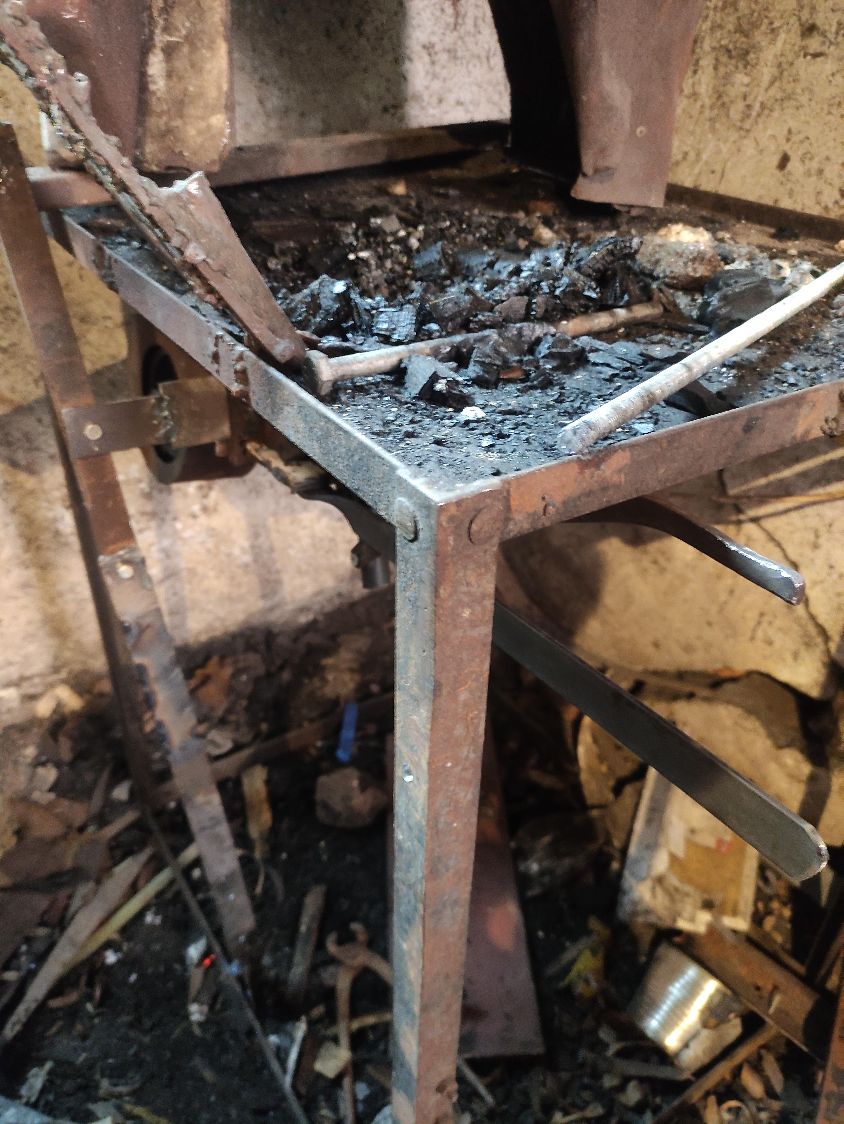

  18. This forge is what I paid for 2 years a go condition was if you want to buy anvil you have to buy forge so I bought it , everything was ok, but wanted to install valve for better air control and it was leaking a bit so I changed old thin shit metal chanel tuyere with thicker plate , had lots of work with electricity too. Thought that fan died but it look like it was ok, just I forgot to connect wire from capacitator to motor. It's German style forge where you get rid of clinkers while pushing in this lever, when you push this lever down rod goes up , ann you have less air to forge , when you push lever up , ball goes down , you have more air to forge And I made now bigger this part which push clinker and allow air to go Here is how it looked before Now it is like this
  19. Well I make new chanel for forge and dumper and clinker breaker but ruined blower for some reason it don't work.
