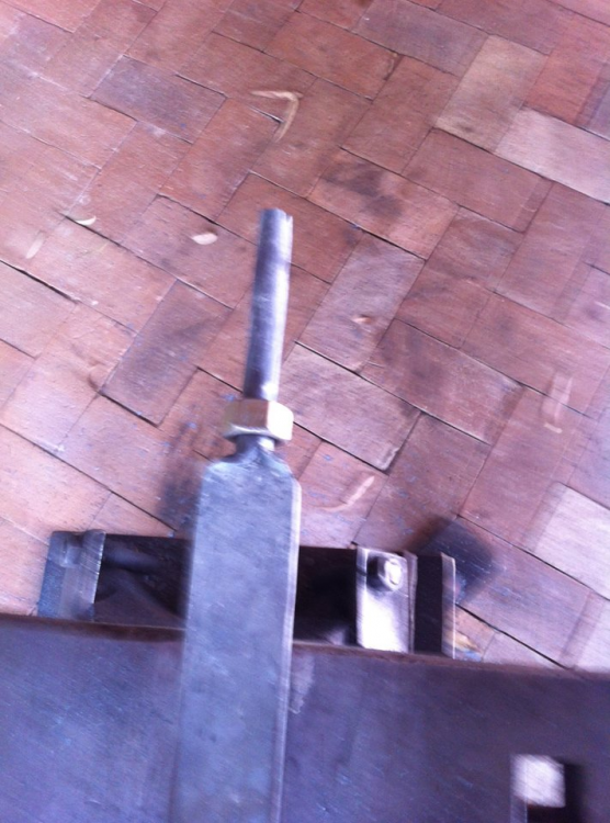

  22. This is a PW 280 lb I made a metal stand for recently. Had the process posted but somehow all the photos are gone. Plate is 1" and legs are RHS 5" x 2.5" x 1/4" filled with sand and oil. Forging the hinge pin for a gate. 50mm x 10mm down to 20mm round. Used a 4 lb hammer the anvil did not move or shake but I should have used the 480 lb that is still stand-less. The nut is just to size the pin My twisted idea for a gate Flatbar is 2"x1/4" New York ... must be a busy place ... I once bought a vintage chainsaw off ebay from NY ... It's a 100 cc Homelite from the sixties. Ha a tag on teh side stating ... this is the property of the NY City Fire department ...
