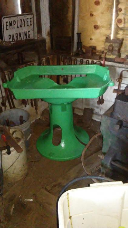

  4. I have the pan and pedestal to a down draft model. I am also missing the tuyere and clinker breaker as well as the hood. I would like to find some decent sketches of these parts if there are any out there. I have a bunch of Buffalo literature that was online, but it is all pretty vauge on the parts I need. Any idea how the down draft hood would work without creating a fire hazard?
