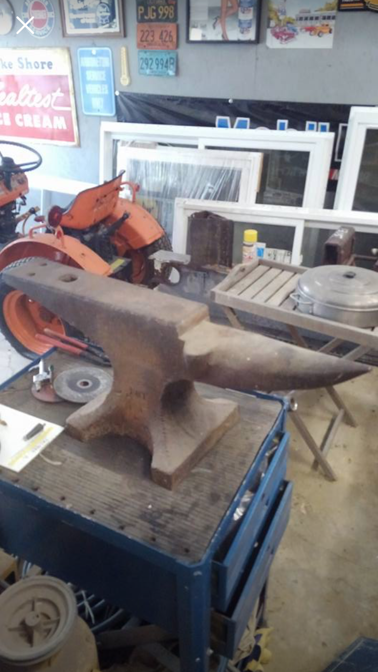

Can someone please help me out. I can only identify the "22" on the back and then the HB in the front with 125
I'm trying to load them, sorry. Everytime I do it says it failed. I'll keep trying. Any suggestions on how to fix that? The 22 is marked on the back leg.
I knew the 125 was the weight. I didnt know what the 22 would be. There are a couple numbers in the front but they are so faint. I know there are more on foot in under the horn but I cannot make them other than 23, but there is space on either side of those two numbers. Thanks anyways, I knew without having those it would be difficult.
