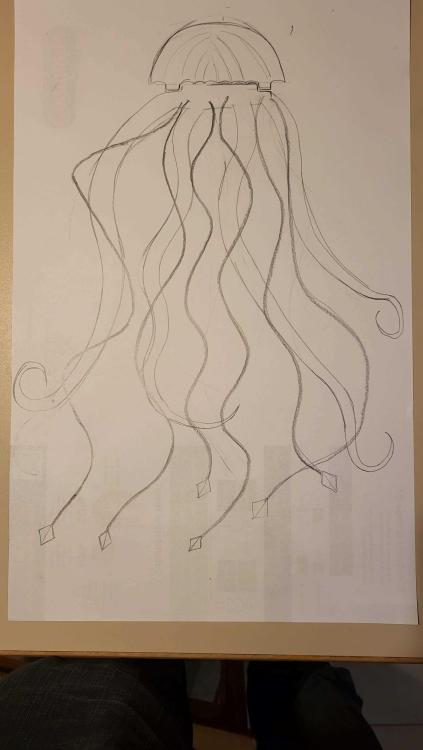

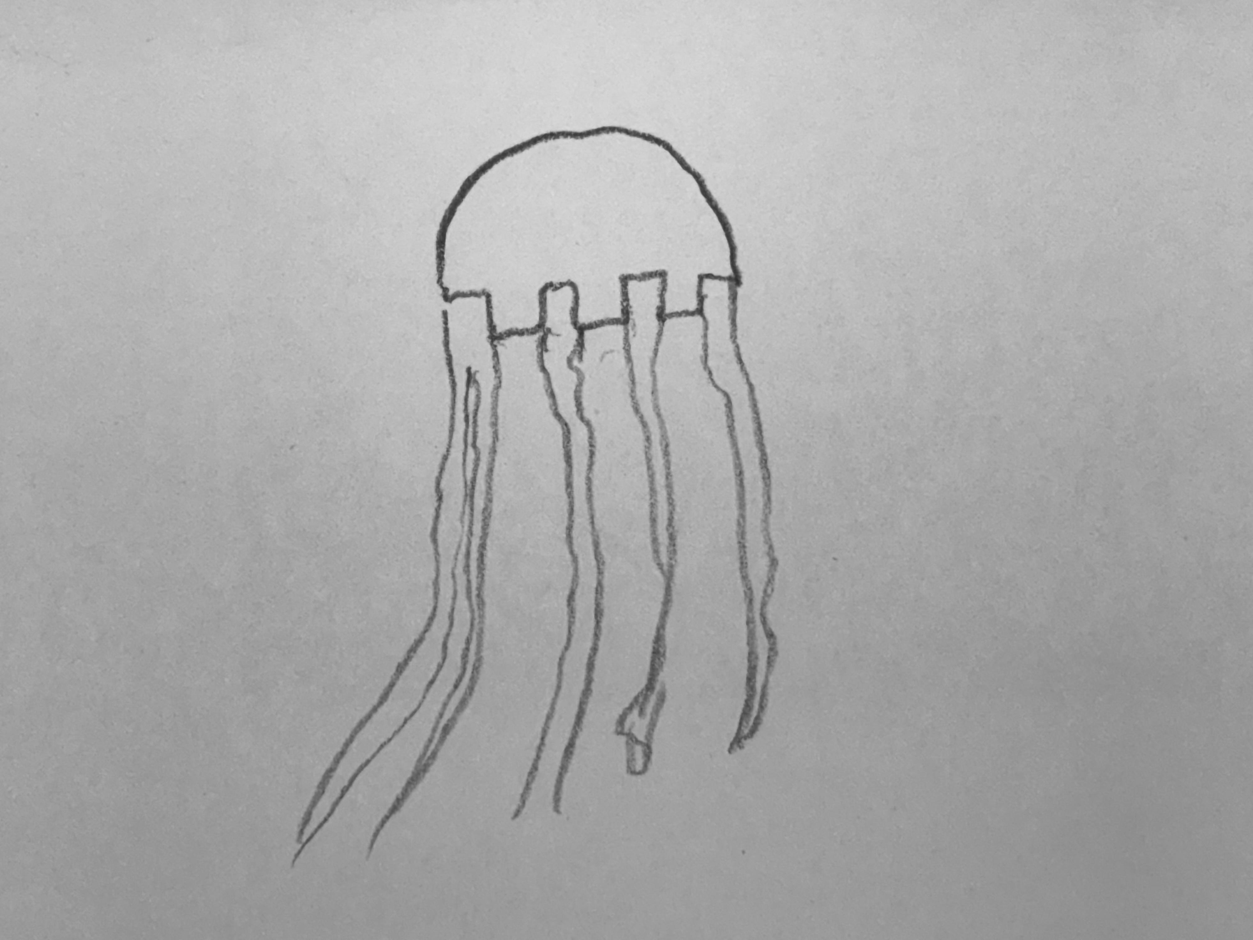

So I was looking on the internet for examples of one that I like. But the idea came when my son was asking if I could draw him some seacreatures. So I was making several drawings of sharks, fishes, octupusses, jellyfishes, ... And than it hit me, i liked the shape of an octupus and jellyfish, so I came up with an sketch.
Showed it to my teacher and he liked the idea very much.
And i started creating some paterns  for the tentacles that I have in my head
.image.thumb.jpeg.d773c628de3bdf6ffe010f8bc1b6c04d.jpeg  patern2resize.thumb.jpg.086021846a55a142da3d1f5ae714b3ac.jpg
patern3resize.thumb.jpg.41a17b7812c28cd20c3943109f66fe2c.jpg detailpaternresize.thumb.jpg.318dfe7abd797d44dd5148533962517b.jpg
So with my idea i started on the round tentacles. The sketch had 6, but in my head 5 will look better.

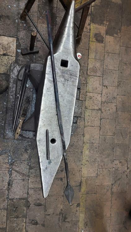

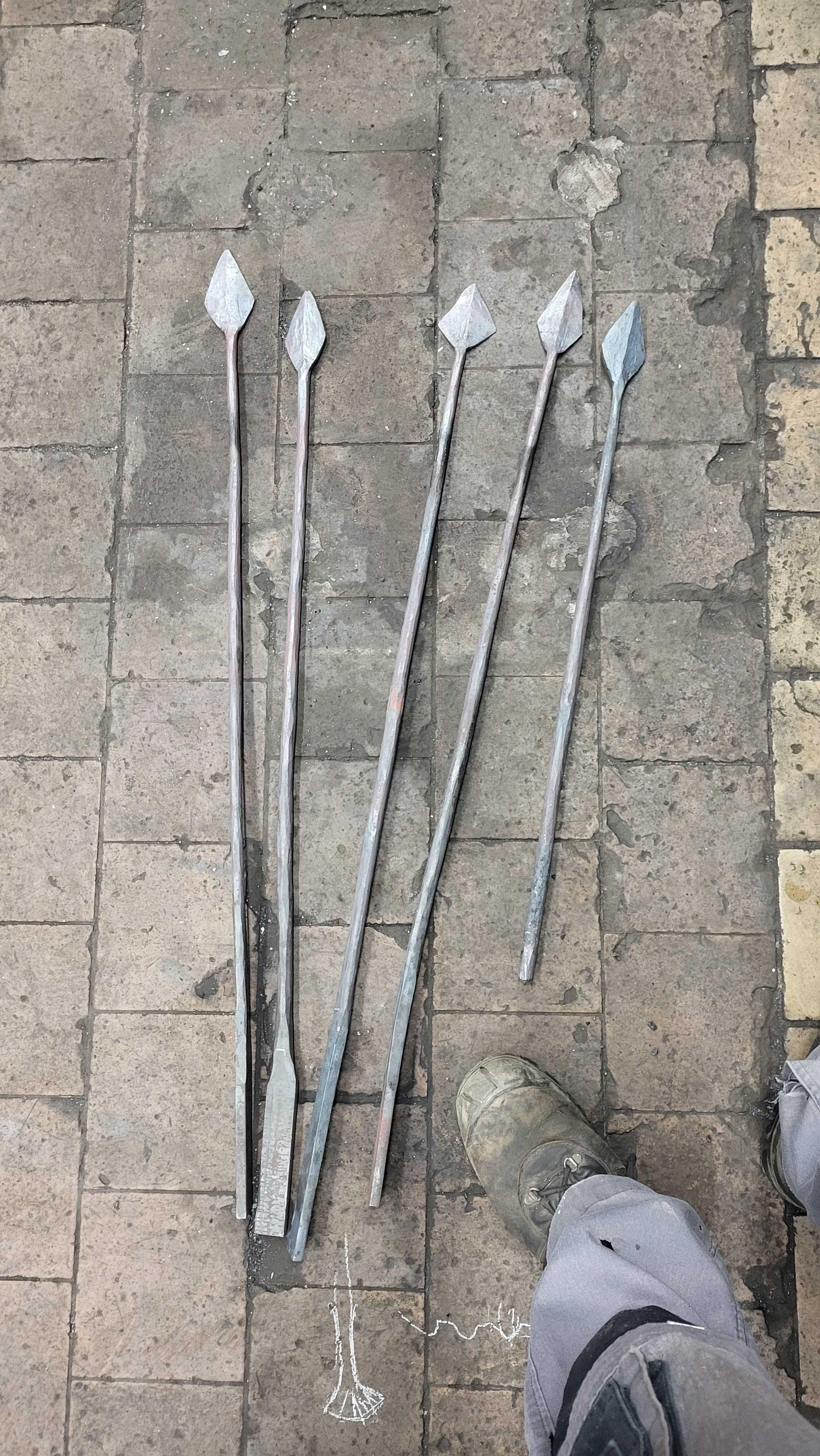

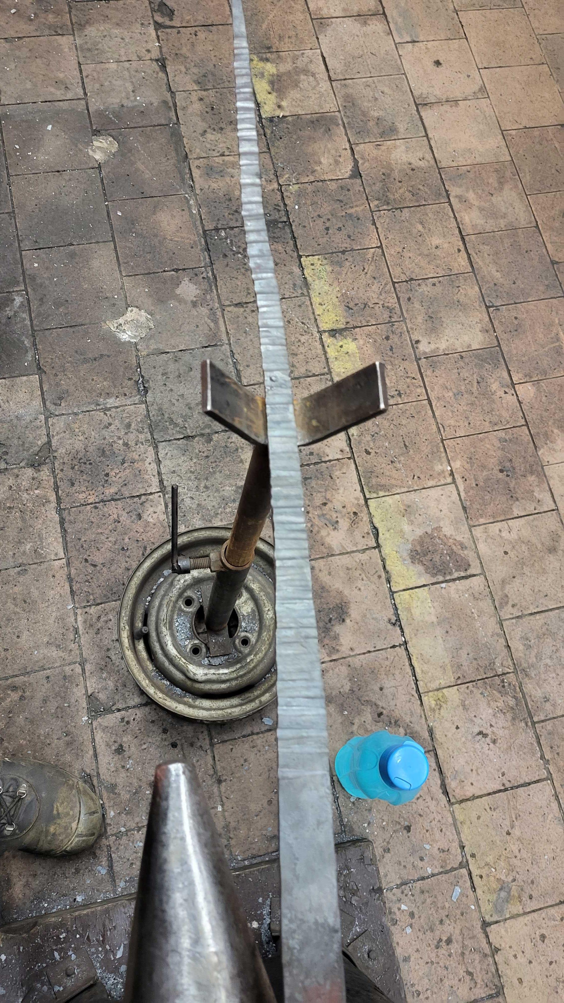

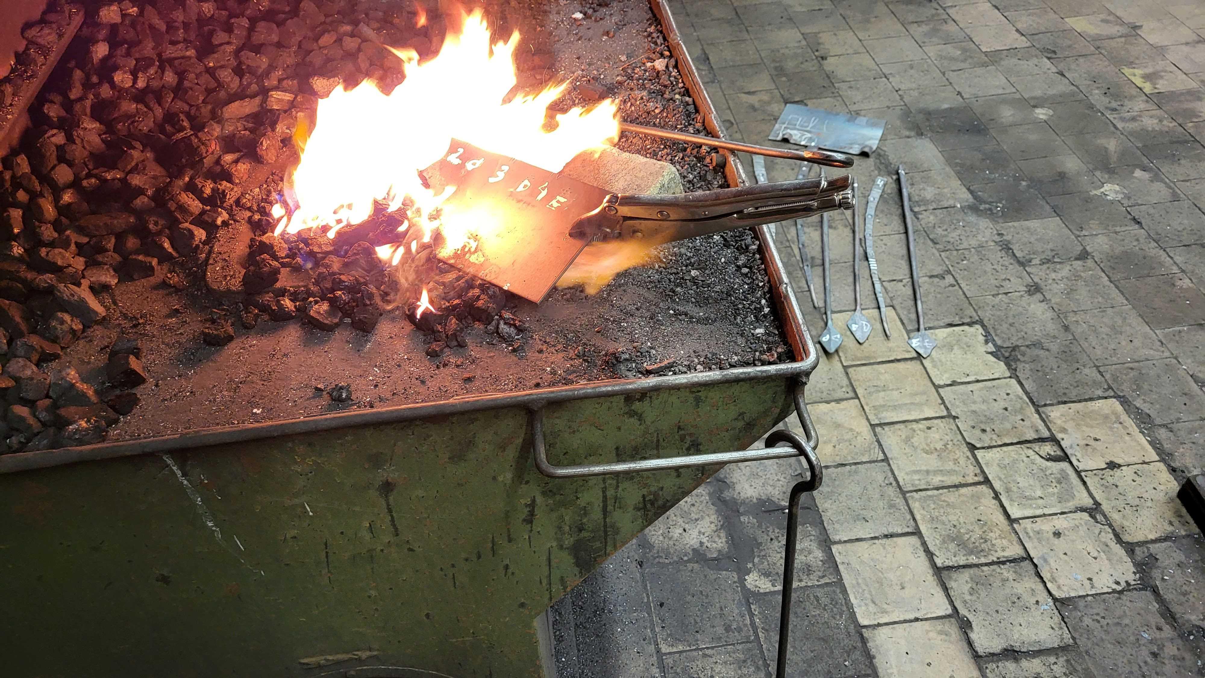

I started with strip material of 30 x 10 and I marked out where the diamond ending will become
some heat and use of powerhamer

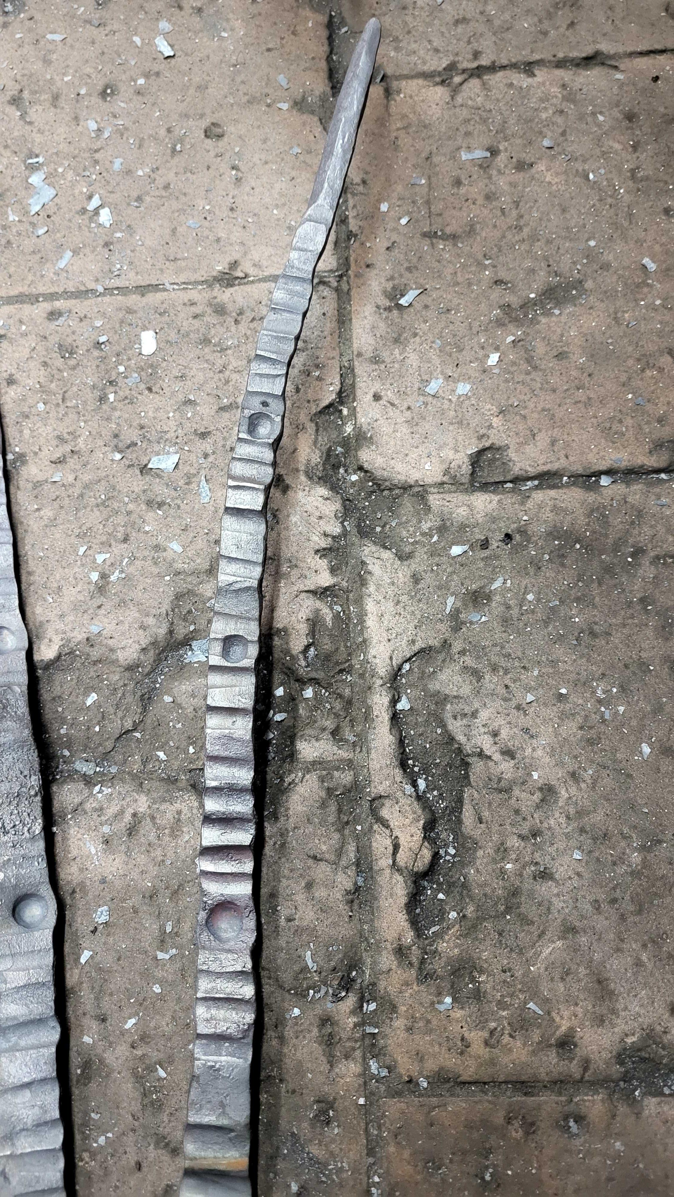

tentacleround2.thumb.jpg.e975ef7092a8f3ec8d7511baea165807.jpg tentacleround3.thumb.jpg.683169ca26e561891c64a7602458d6b5.jpg

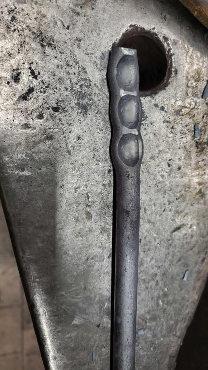

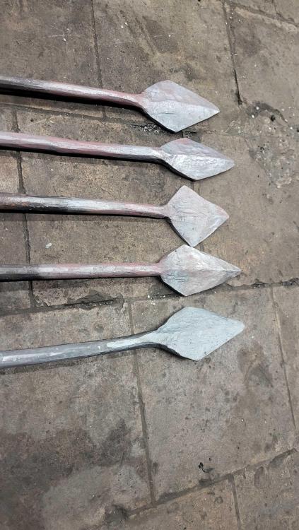

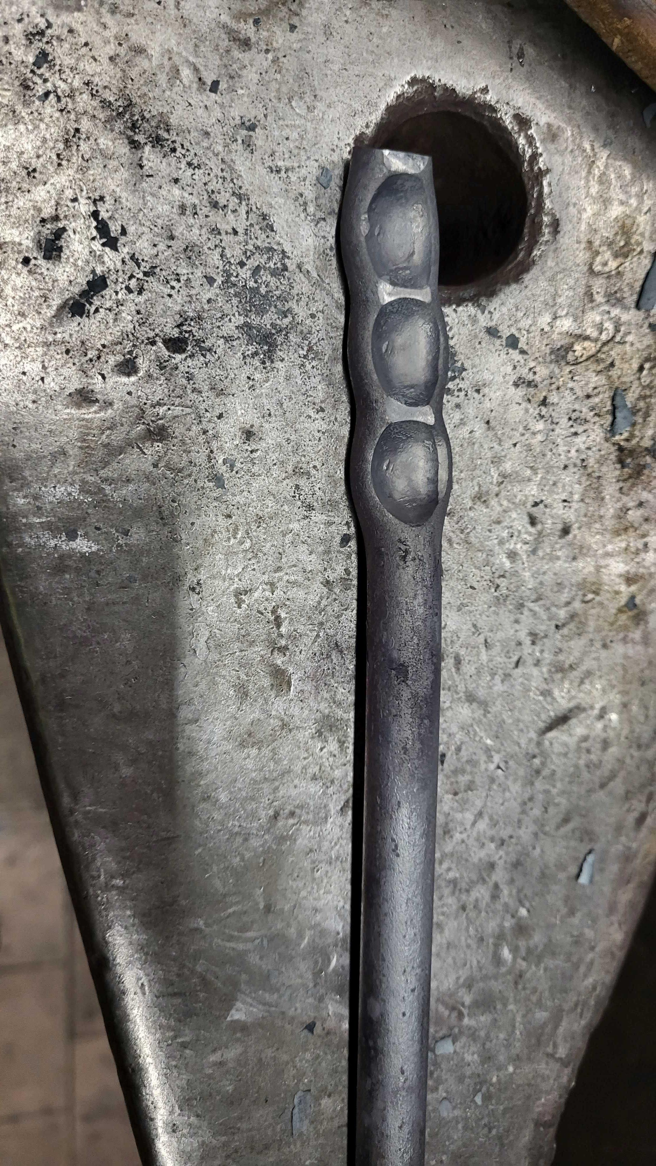

and they become roun and tapered. Do that a couple of times and make the end pieces by hand. I really liked doing those end pieces, the tapering and the fullering to make sure I have a nice ridge centered. They are all a bit different, by purpose.
tentacleround4.thumb.jpg.e80e4854a3d3976a782c7e904338ccb6.jpg tentacleround5.thumb.jpg.efb300dce6ed56d83e28d72ba9c3720f.jpg
some details

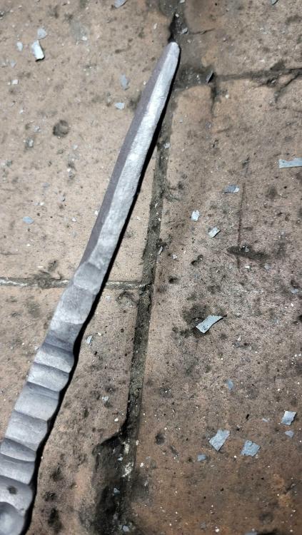

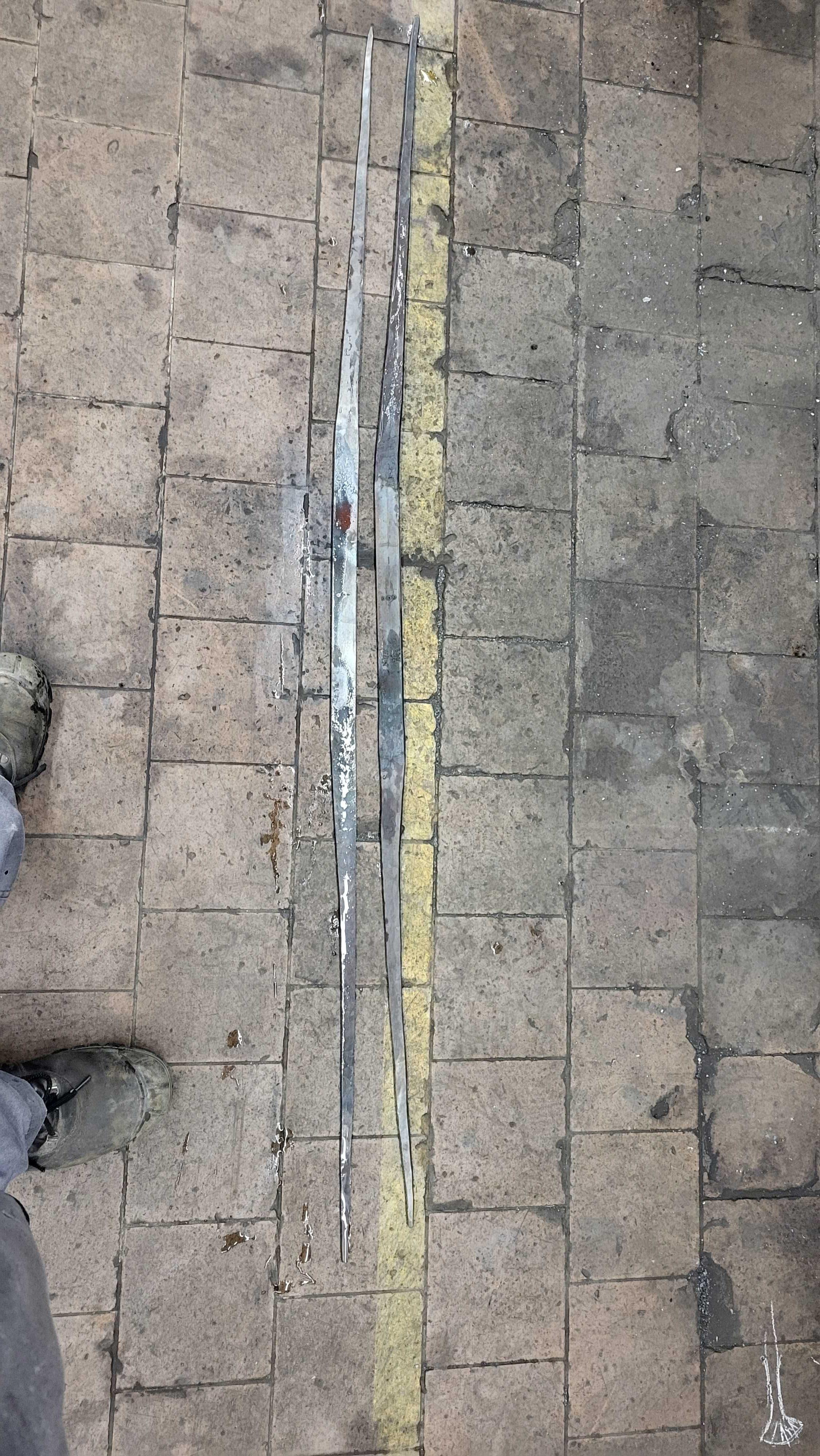

After the round tentacles done, I started on the flat ones.

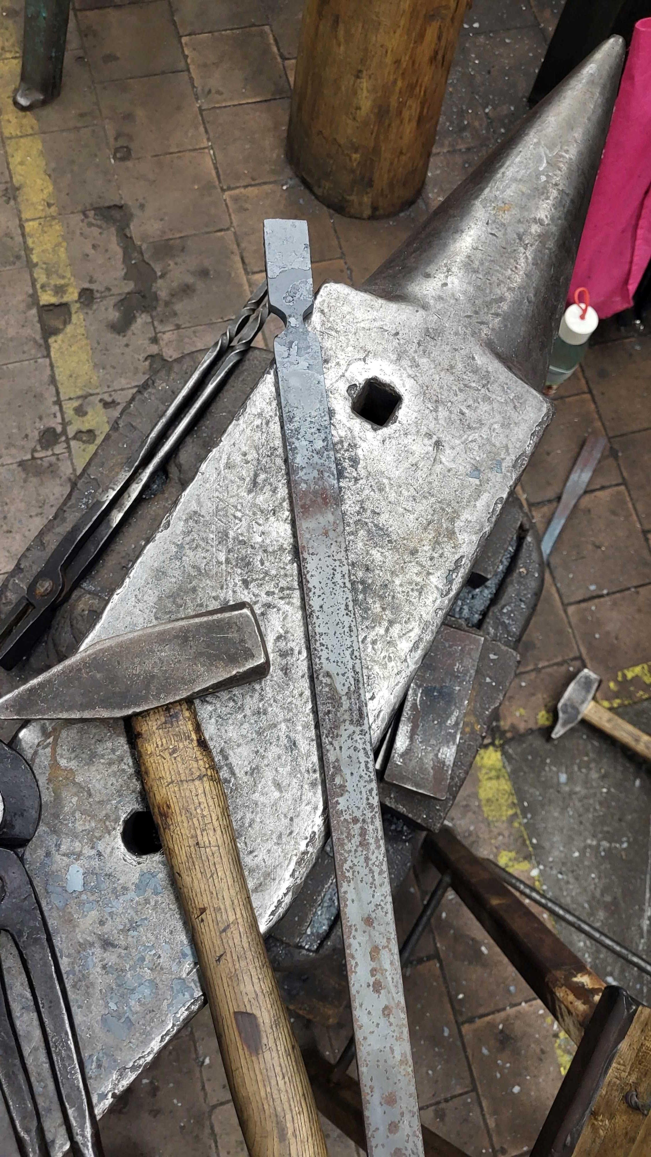

Same starting material, strip 30 x 10. Have made a drawing from the taper I want on metal. So the taper will on all 4 very similar.
Heating and using the powerhamer and some time later I ended with 2 pieces of 2 tentacles
Than some fun with diffent sizes of fullers
tencaclepatern2.thumb.jpg.2ef1fcb10d28edcab52c5de3cad63fb9.jpg tentaclepaternmaking.thumb.jpg.a6cf657e8d784edb4c1366579b35bd21.jpg
The end piece I made a simple point with a ridge in the center. I like that look
And than you end up with 4 pieces.

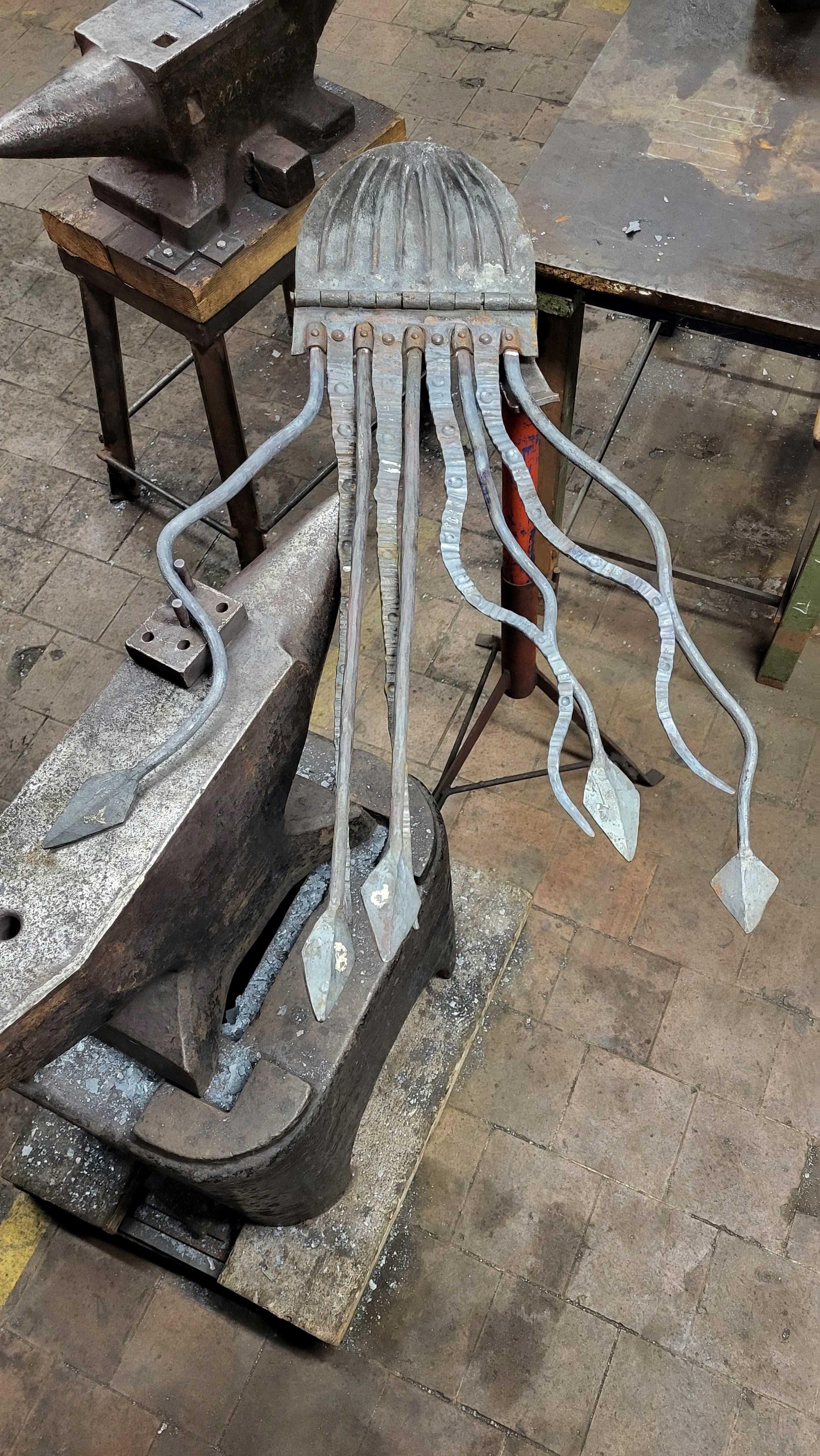

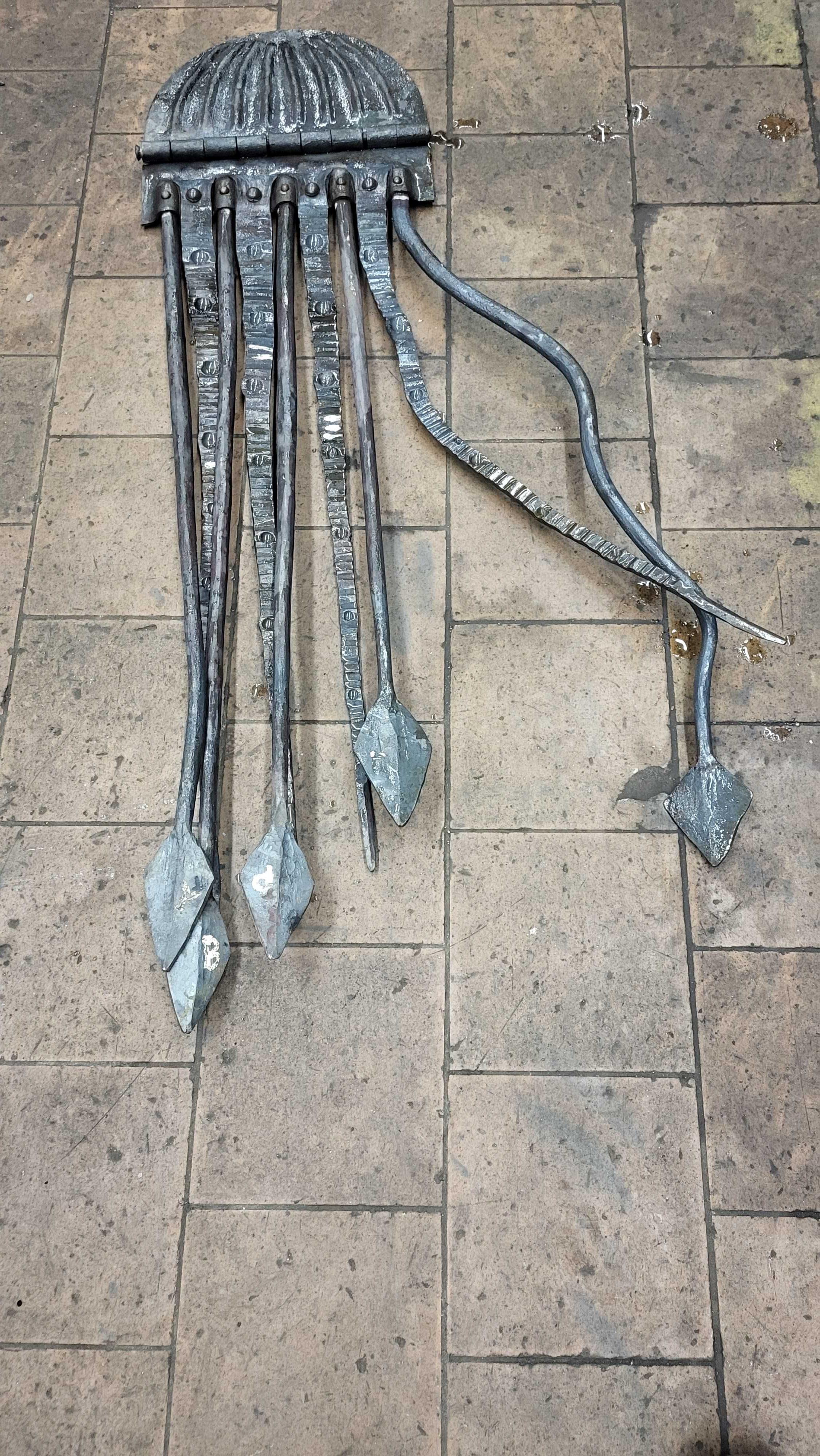

And I took some pictures with all the tentacles loose fitted as well. First time in couple of months all pieces togheter.
fitting1.thumb.jpg.0ba996f478ac620774a98ce555b04d3f.jpg fitting2.thumb.jpg.8af1899369cc129332ac413d93437baa.jpg
Connection between all the pieces will be done by rivets. I made that choice in the beginning, but now I have to choose the size of the actual rivets
than drilling and fitting and drilling and some more fitting and ended up with all bolted togheter
After the rivets, it was the shaping of the tentacles. Was a fun but difficult job. But with oxy-acythelene and several bending forks, lay out table, some jigs and help from others, it was getting there.
image.thumb.jpeg.aa16e0ad6356c8a44d8ac29a841953db.jpeg image.thumb.jpeg.aa76812741f70a4d3c4a10a9fe544f3b.jpeg

So when all that is done, I will update with the works and some more pictures.
Sizewise, it fits on a rectangle of 95 x 85 cm. So yeah, almost a full m2.

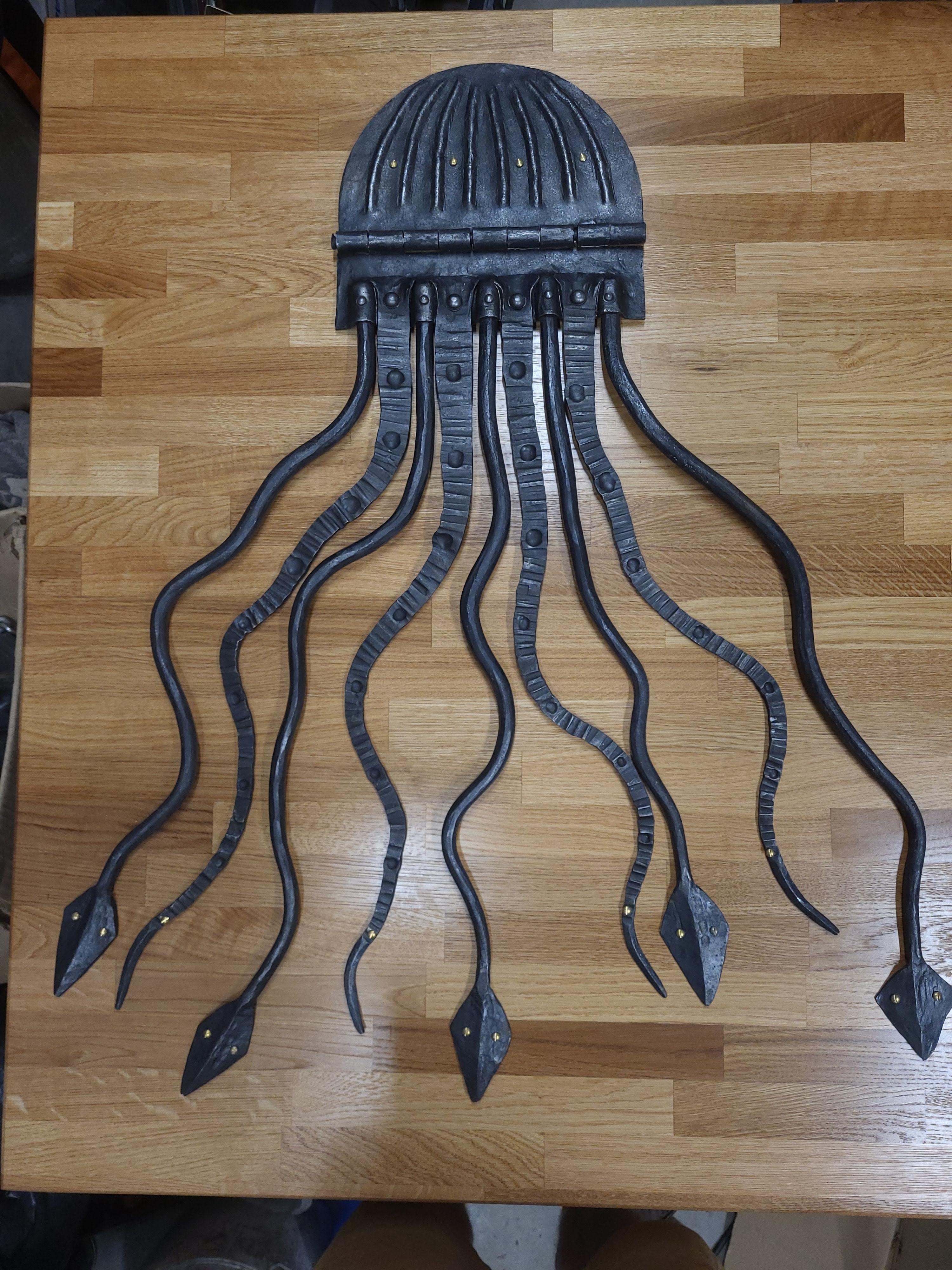

Project is finished
It also will have a place in my living room. But first painting the living room, so it will take a while before it hangs up.
