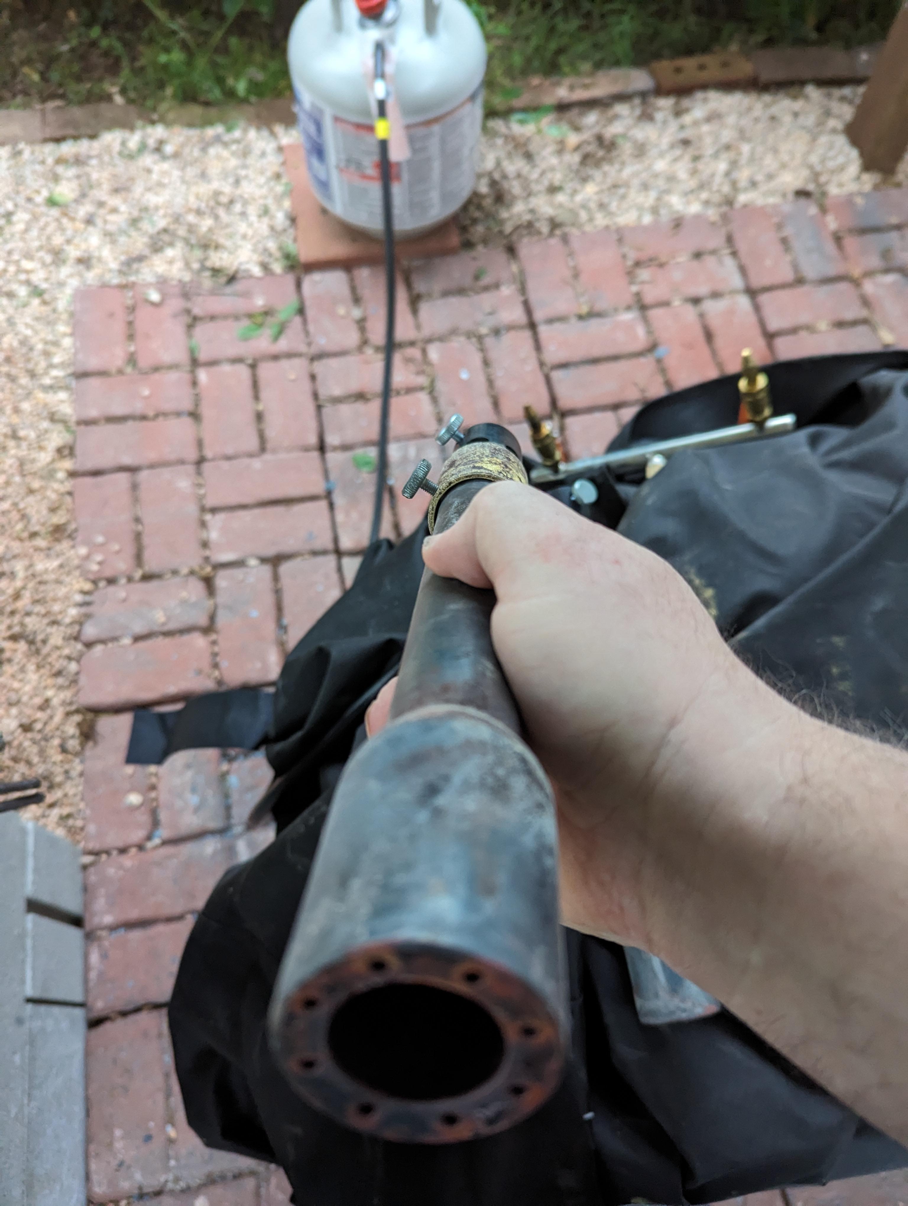

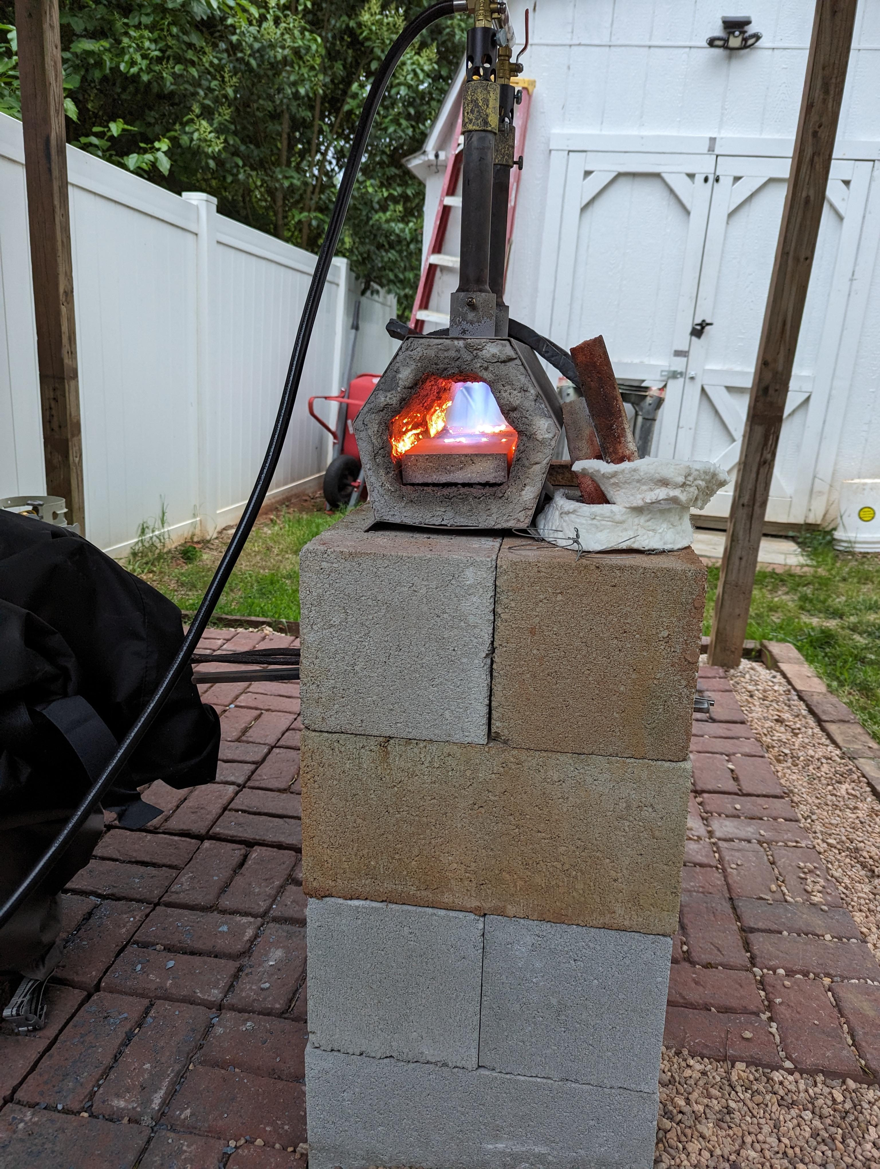

I have a Vevor 2 burner propane forge.
At this point the choke sleeves, and burner pipes no longer have paint on them, after using it a couple hours I can see flames in the choke vent holes, and the pipes themselves glow dark red. I assume neither of these things is a positive.
At one point only one pipe was red, I tried turning off the ball valve and it eventually cooled off then I turned it back on.
Suggestions? I would prefer not to die.
Just for clarification, this doesn't happen immediately, but after I have been using it a while. Probably nature's way to telling me that I have been working at it too long and it is time to go inside. But I am not sure that is the right answer. :)

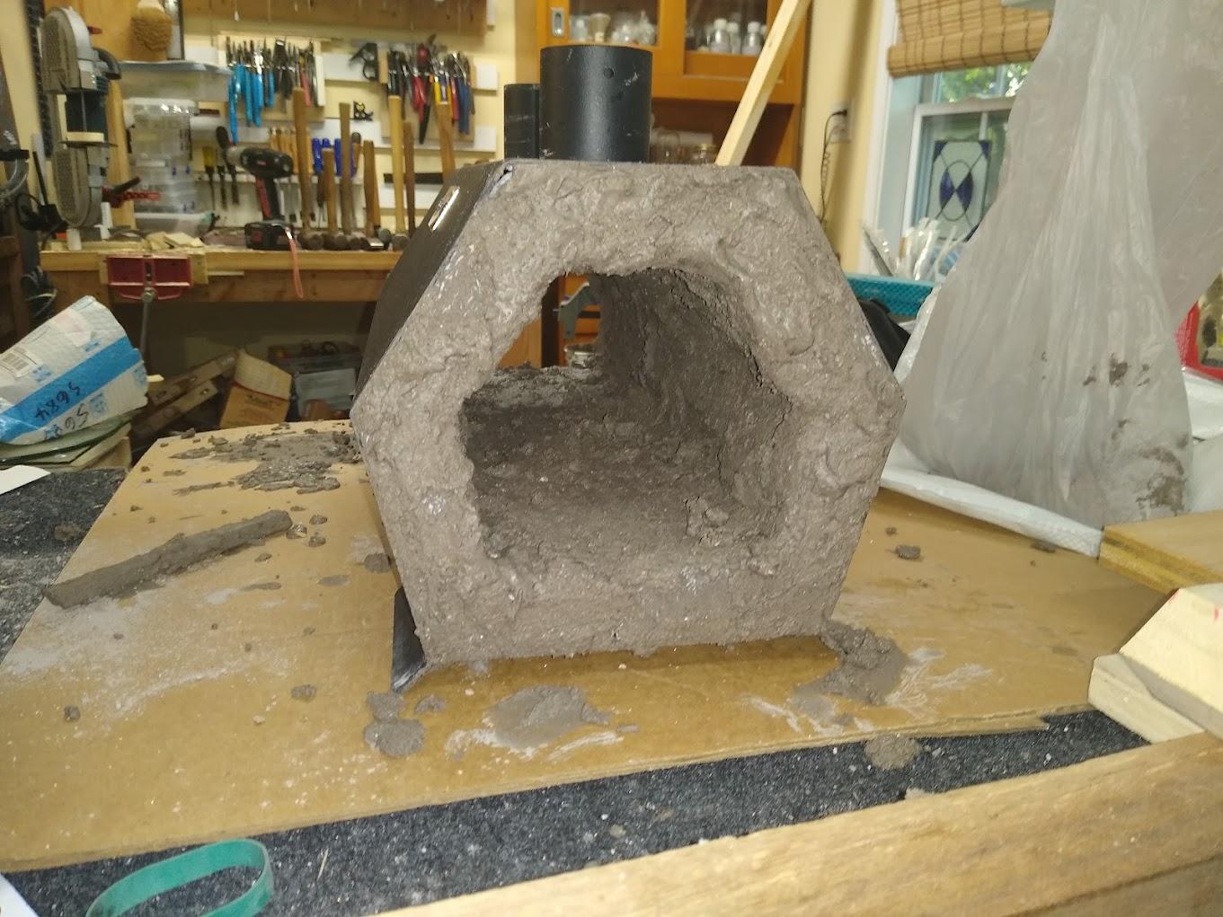

This has the kaowool lining and I slathered it with refractory cement, and on top of that is a fire brick for a floor. Someone had suggested that I better seal the outside where the tubes fo into the top of the box. So I wrapped a layer around the seam and twisted it in place with some wire. I notice no difference.
The regulator has no numbers or indicator, so I am merely guessing at what PSI I am running it. Similarly the choke is handled by a sleeve that potentially covers a series of 3/8" holes that can be slid up and down to cove or reveal some or all of them, then held in place with a screw. I have run this wide open and mostly closed, and tried guessing at a setting in between. It all feels like some serious guess-work, but I am not sure what I am looking for exactly, unlike lighting a OA torch...
Including some photos showing the refractory drying when I first did it. Then you can see it pretty before first firing. Then with all the paint burned off. I don't have a photo with the pipes glowing red, but I could get one next session.

I have never used that forge or those burners, but what I can tell you for sure is that you had flames burning in the mixing tube.  You do not want that.  The flames should always be at the forge end of the mixing tube and never inside the tube itself.  Because your burners are top mounted there will always be heat rising up through the mixing tube when you shut down the burners.  However, in use the mixing tubes should be roughly ambient temperature and certainly cool enough to touch without concern about being burned.
If you want us to help diagnose your issues take some still shots from the side right after you light your burners.  It's best to do that in moderate to low light rather than sunlight so we can see the flame characteristics.   That will tell us a lot.  You can also take another picture or two a few minutes later when the forge starts to glow, but the initial flame in a cold forge is the place to start.

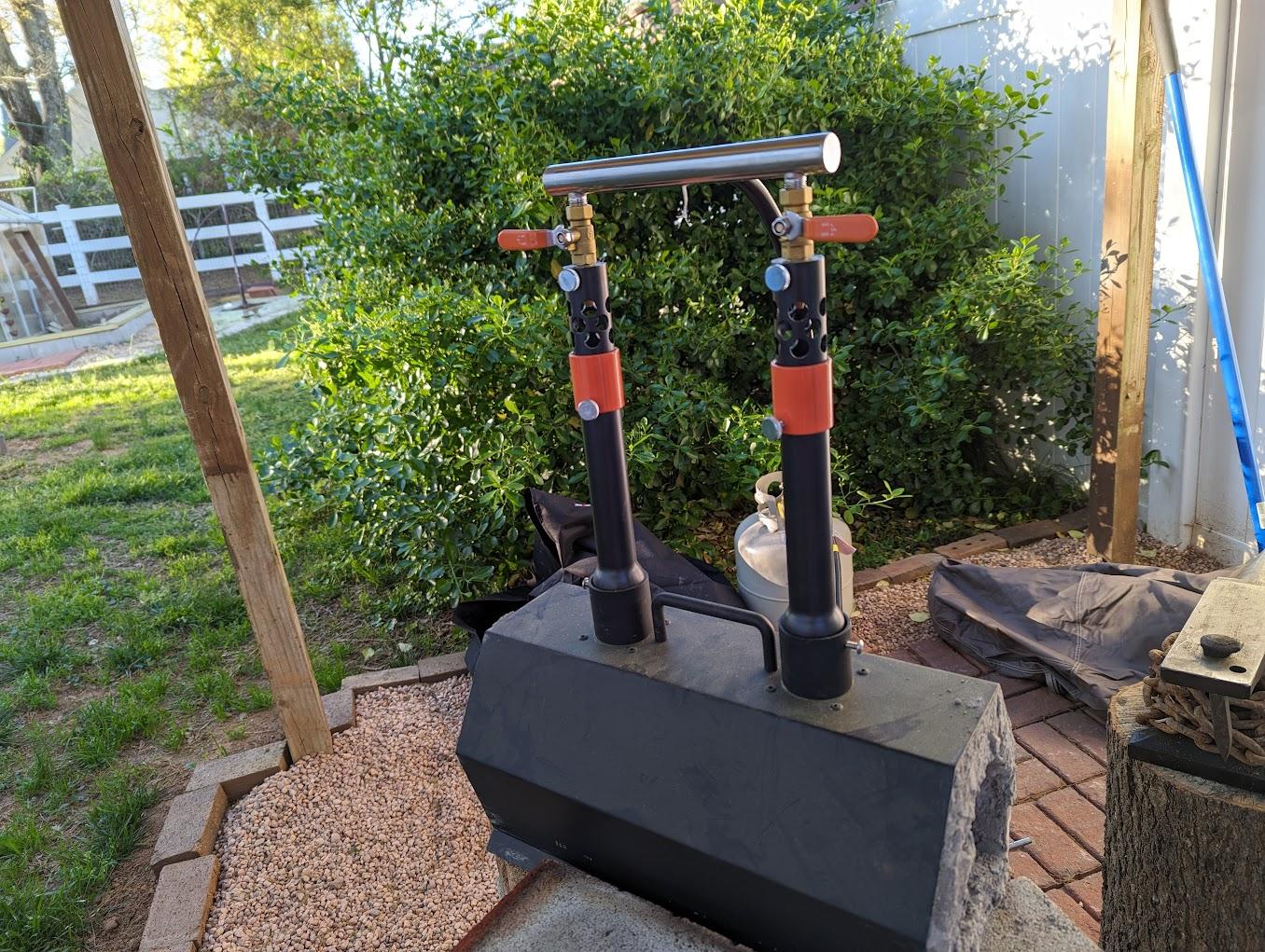

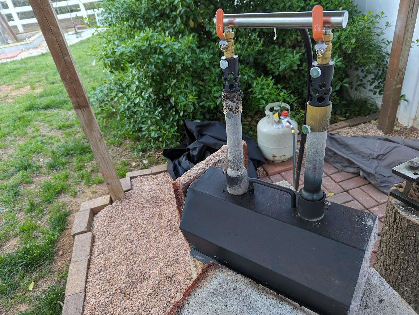

To start with, your burners look to be positioned in the wrong place; the manufacturer may have intended this, or not. But the result is that the flames are also positioned in the wrong place. So, begin by pushing the burners deeper into the forge. How far? Start with the end of the burner flame retention nozzles (which are also the forward end of those burners) just the inner face of the refractory, so that the flames are fully burning inside the forge (but the flame retention nozzles are not). Then gradually move them up, to no more than 1" inside the refractory's inner surface.
Buzzkill has it right, that those burners are burning back into their mixing tubes; the question is why that is happening. Changing the burner positions should bring immediate relief from some of your problems; perhaps not all of them, but the rest can be dealt with as they present themselves. Do this simple thing, and get back to us with the results.
So, I looked up Vevor's heating equipment on the Net; they have a lot of similar equipment; most of which use the same flame retention nozzle design, and improper positioning as yours. Also, most, if not all of, of their burners have flame retention nozzles that are welded in place on their mixing tubes (one of the forges have different burners, which are placed where their flame retention nozzles, if any, don't show). Even their stainless steel burners have flame retention nozzles that will oxidize away in a few months; this will happen more rapidly on the the mild steel burners, like yours. Why? Because flame retention nozzles always oxidize away; this is why most flame retention nozzles are held in place with screws; they are meant to be replaceable.

We'll get it working as well as it can for you Absinthe but first I need to list what jumps out at me.

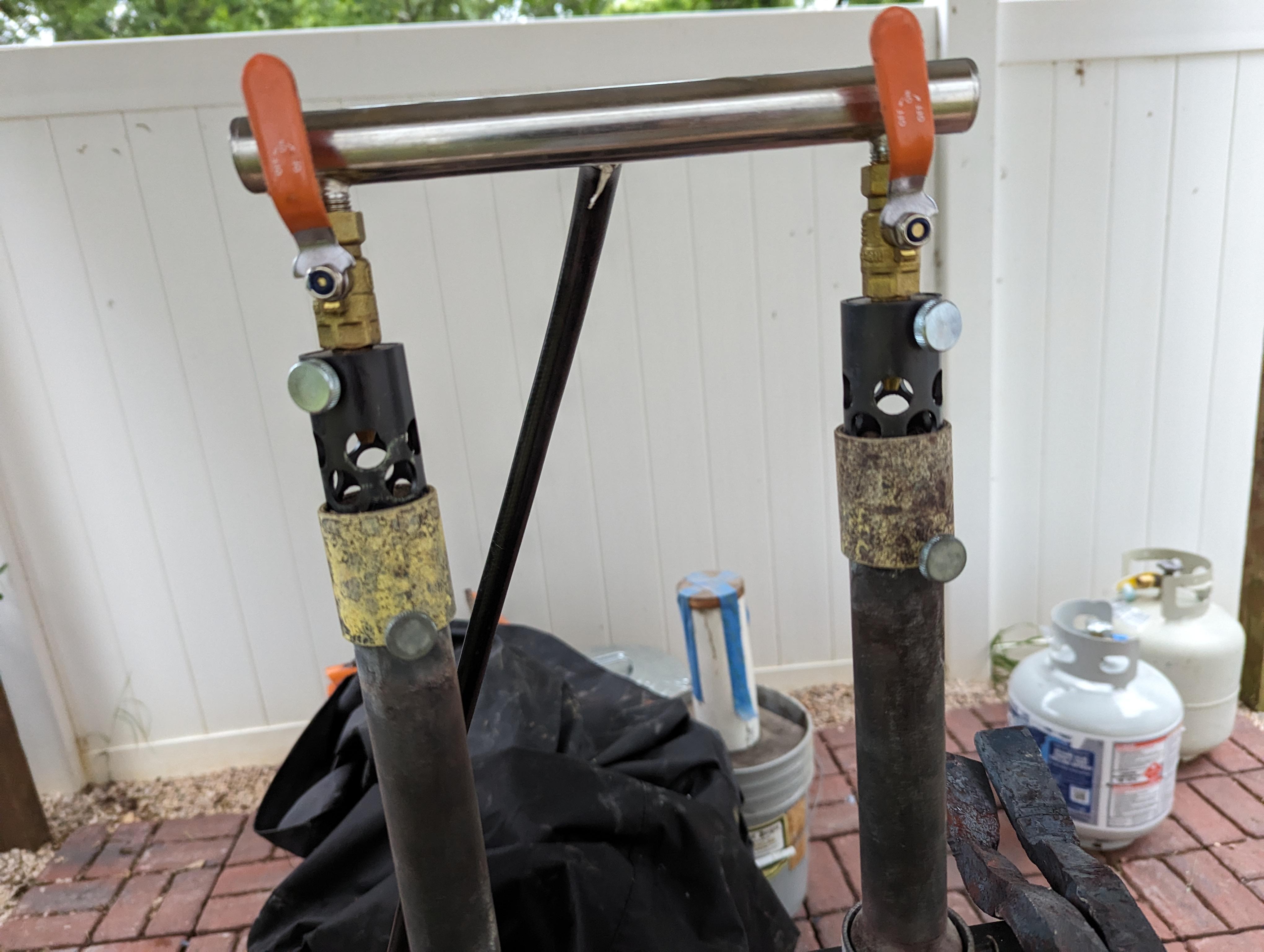

The burners being top mounted in a 5 sided forge chamber looks to be intended to cause back pressure on the burners.
The burner nozzles are too tight in the mounting sleeve so it's impossible to align them so as to minimize back pressure.
I'd much rather see them mounted in one of the angled sidewalls so the flame impinges the floor at an angle and swirls in the chamber. Mounted vertically as they are the flame impinges a directly perpendicular surface and swirls in all directions. Tries to that is which sort of traps the flame's pressure. Back pressure.
Ah, I see Mike dove deeper into Vevorville than I did. Egads the retention nozzle is a cheat to make people buy a new burner regularly! Flares/retention nozzles are consumable, as Mike says they WILL burn up before too long. Welding them to the mixing tube makes the entire burner a short lived consumable.
I don't know about other Vevor products but this stunt alone puts them on my list of scam sites.
I'm thinking you should build a couple burners and get away from those . . . things. Don't worry, we'll help and it shouldn't be too expensive, in fact a fraction of the price of ONE replacement vevor.

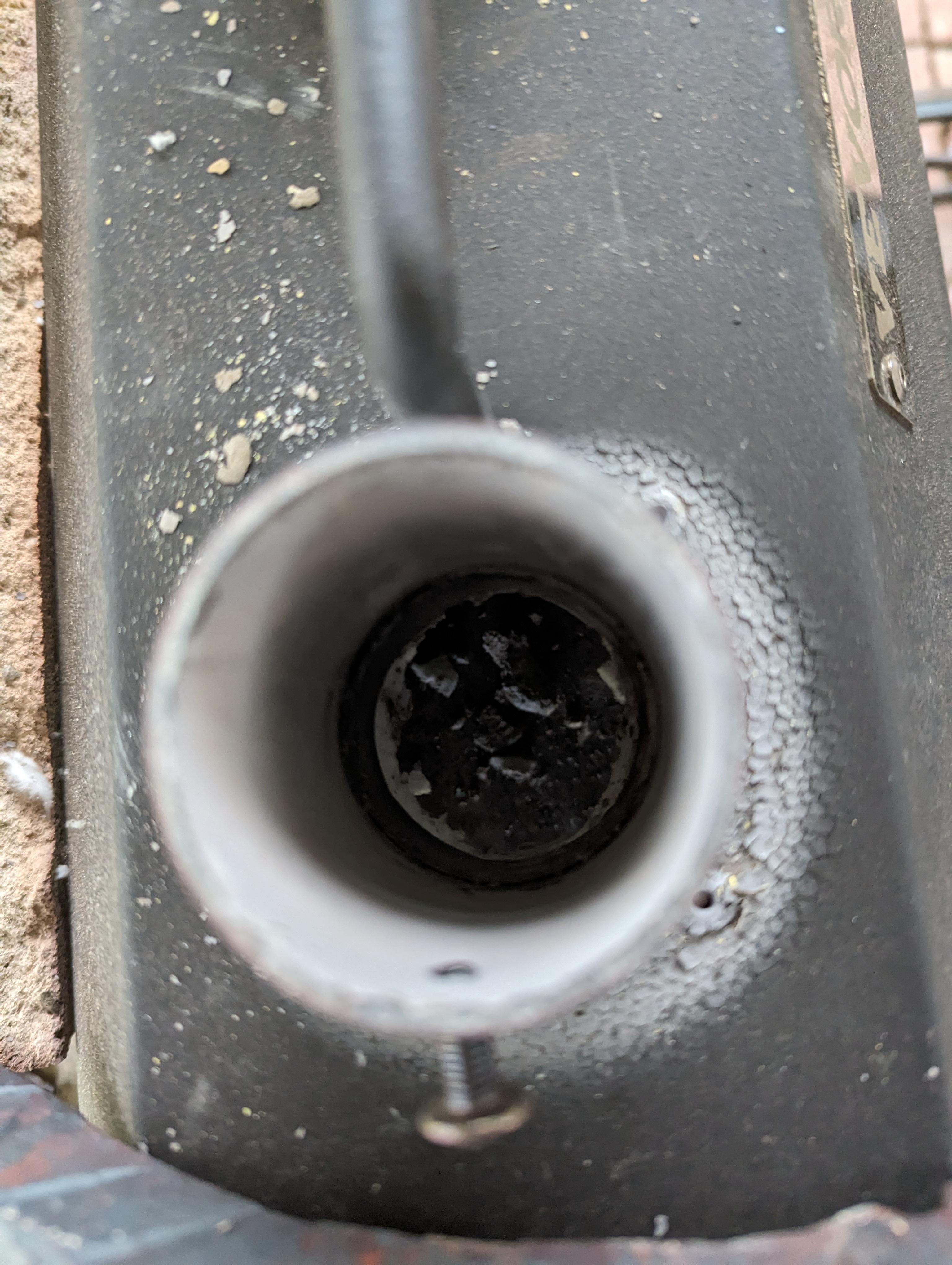

I tried to take a picture, but it is kind of "meh". But near as I can tell those tubes end at the top of the box itself. They do not protrude into the kaowool, much less into the layer of refractory cement. I think I can force these down all the way to the floor if I try hard enough. (Realize that isn't the goal, just that there is no restriction inside the steel that would stop them). However, they will only go so far, and still be able to secure with the side screw.
I will have to un-wire my gerry-rigged top insulation, then I can try feeding then through the wool, and refractory cement, so that the openings are even with the refractory ceiling? Or some amount below?
I would suggest, instead, that you drill and thread two other holes, and employ three longer screws through them, to hold them against the burners mixing tubes; this allows you to move the burners to different depths within the forge, and also to keep those burners centered in the forge's burner openings

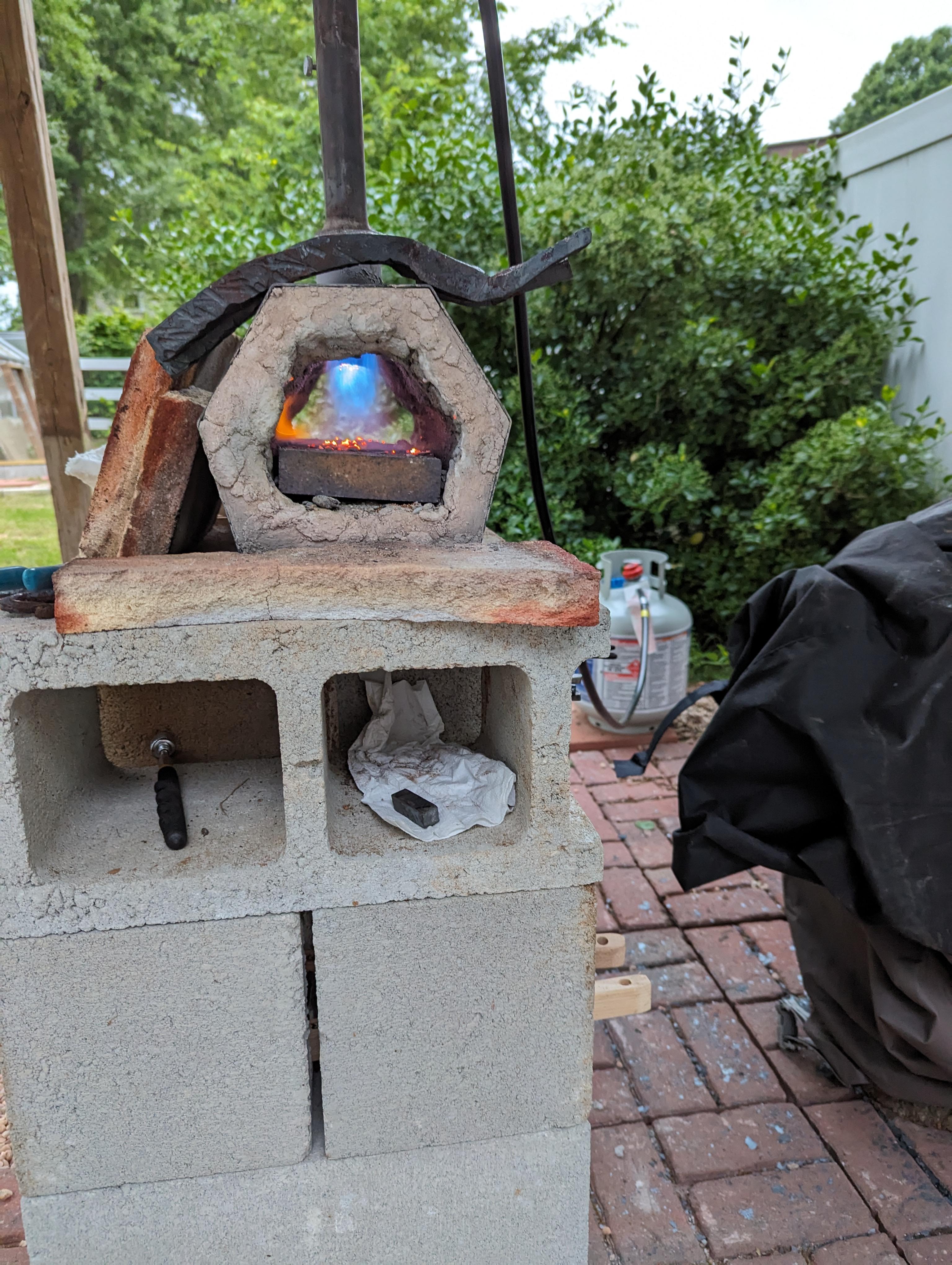

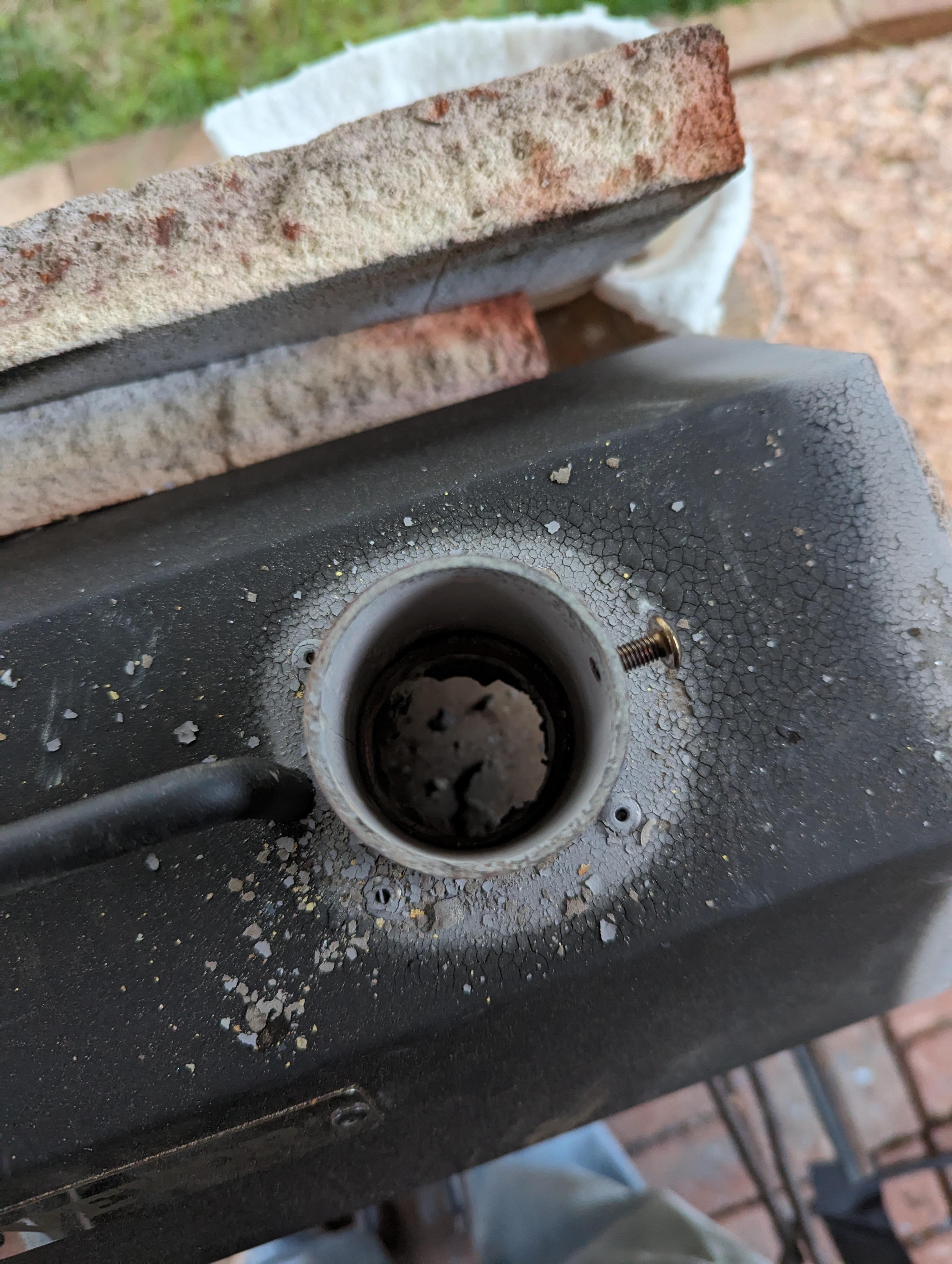

Okay, did some examination, and took some photographs. I lit it and showed the initial, then turned it up and took some more photos. I cleared any refractory from near the opening. I was wrong, there is a restriction so it is in as far as it will go. I removed the tubes and showed the nozel, it seems threaded rather than welded as someone supposed. I hope this helps.

What are you using for doors on the ends? If you lay a flat brick outside the front, you can support your work and provide support for doors. I don't think your work piece has been hot enough, either from the lack of heat inside or from taking the work out too early.
My experience of the burners getting too hot, back up the tubes, is lack of air movement through the burner. I don't know why there is a restrictor at the end of your burner tube. Take the washer out and try it.

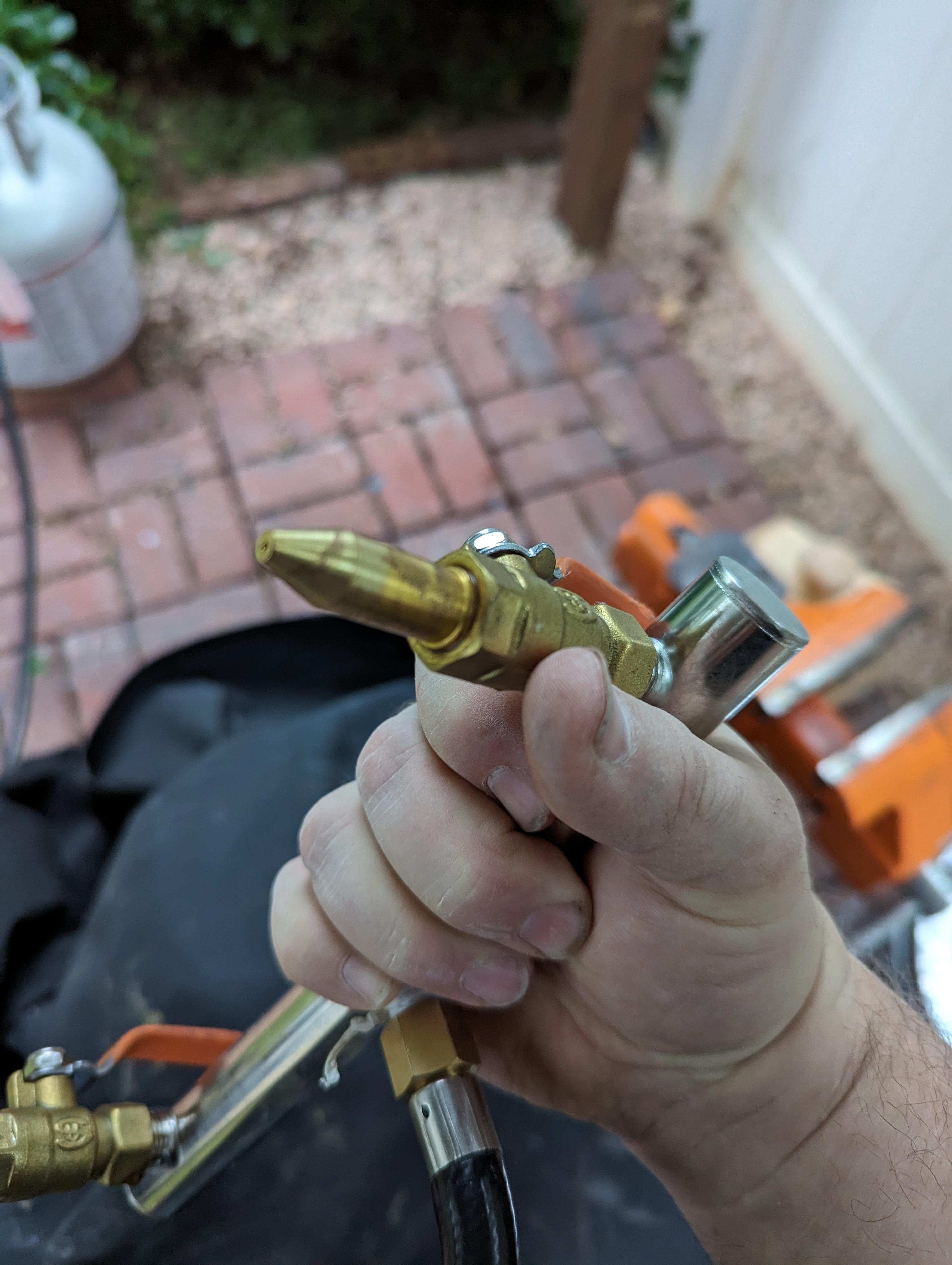

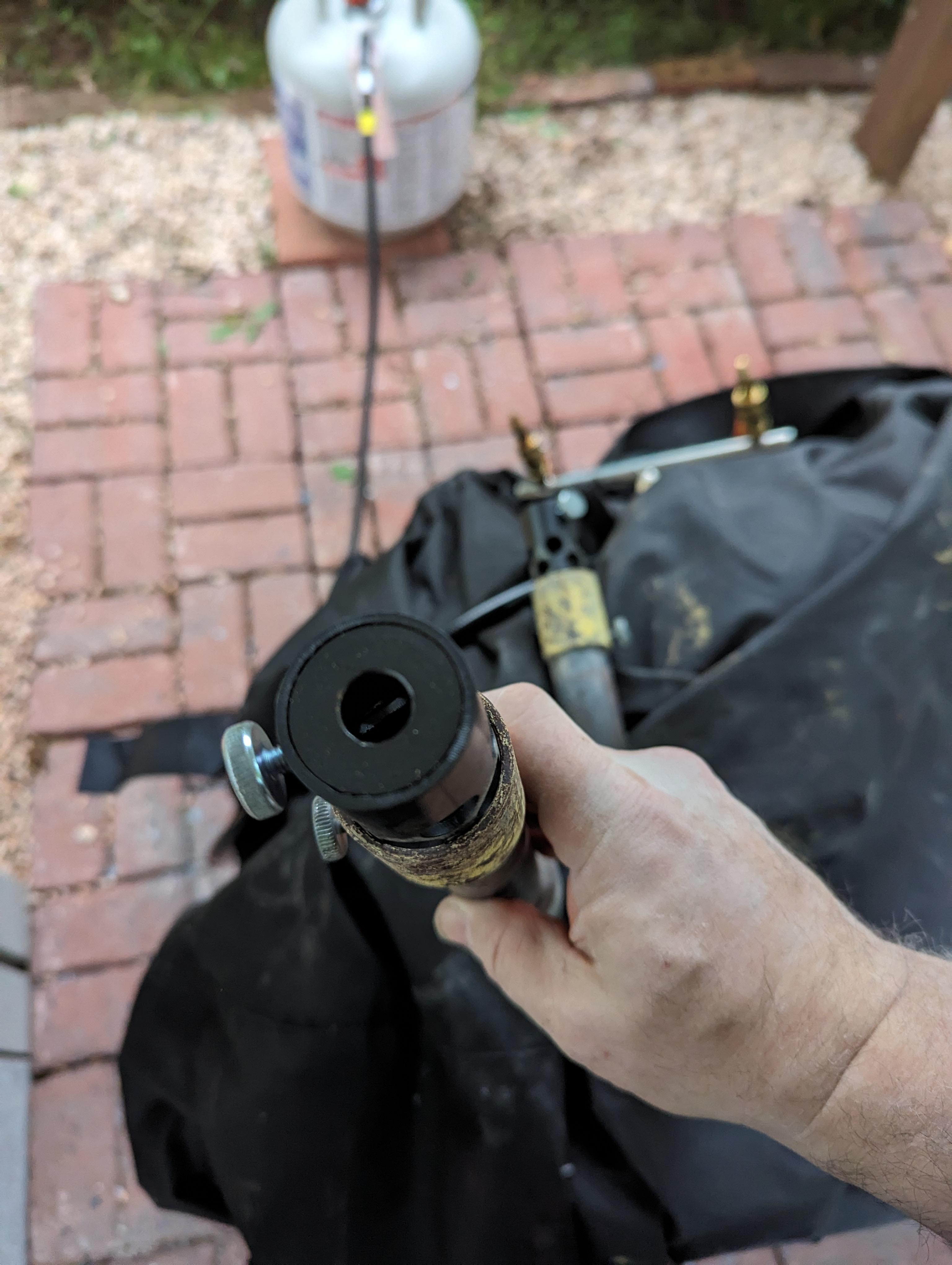

The flame retention nozzle we were talking about is what you show in Pic 2 and I don't know what to think about the restriction with the holes. How is this attached to the burner mixing tube?
The brass fitting you thought we were talking about is the "Jet" and focuses the propane flow like a water nozzle focuses the water stream. It's inside diameter ID determines the volume of propane that enters the burner at a given pressure.
The stream of propane also called a jet produces low pressure behind it as it flows down the mixing tube which induces combustion air through the holes in the tube, the choke sleave is used to adjust the air fuel mix.
What brand castable refractory did you use for the flame face? (inside of the forge that comes in direct contact with the flame) You said refractory Cement and I managed to not to lecture. . . Barely. Unfortunately refractory "Cement" is a mortar type cement used to hold bricks and such together in a hot environment like a fireplace or pit and not suitable for a propane forge flame face. Unfortunately so many people have been using the term incorrectly manufacturers have begun selling Refractory as refractory cement. <sigh>
That leaves me not knowing what you actually used and it makes a real difference but it's in so don't worry for now. If it is the mortar you'll find out soon enough and we'll help you get it right. Not your fault.
Why I bring it up is you really need to get the split brick out of there! It brings the floor very close to the burners and is probably THE reason they're overheating and burning back like you describe above.
If you have more of the refractory you made the flame face with lay another layer on the existing floor to give it some more abrasion resistance.
And lastly for now, making door baffles similar to what Neil suggests will go a long ways to keeping the fire IN the forge where it can transfer energy to the flame face where it will re-radiate onto your work and heat it.

So this is a mixed thing. I have a bunch of fire brick, both insulative and hard. I have closed off the back, using a big piece of soft fire brick. But then someone said not to close things off because that might cause the heating to go up the pipes :)
i do have a fair amount of fire brick, both soft and hard.
Everything seems to be connected with friction fit and a side screw. The nozel fits down a hole in the pipe and then has a screw that keeps it moving. It is possible to move that further out of the pipe if necessary, but I bottomed it out down into it.
The choke holes are where they are not much I can do about them other than moving the nozel further away from them.
The pipe flairs somewhat at the end, and has a series of holes around the bottom but it also has a "bottom out when it is placed into the box." Relationship.
As for the refractory cement, it came in a bag with the forge, and minimal instruction. I still have a cup or so left.
Basically it came with the wool in place and instructions to coat it with the cement. I have since bought some more to have and use in places, and some liquid rigidizer to go with it.
I can certainly remove the bricks from the "floor". Once again it was a mixed thing. Some said put them in some said don't put them in and so on. :)
As for baffles, I have enough fire bricks one one type or another to stack up external floor extension and completely close off the back .... As well as the front of I were to so choose to do so.

Good Morning,
It doesn't matter what kind of brick you use for the ends, regardless what others may think (soft brick breaks up easier and sooner). If you leave a little opening in the back, that cuts down a bit of the Dragon breath out the working end. On the working end, front, I leave an opening closer to the bottom. I use two pieces of broken brick and lay a full brick sideways across the top of the pieces to block off the top part.
Heat in the Burner Tube, means flame is moving up into the Tube. You don't have enough air flow to keep the flame at the tip of the Burner. Try using an old Hair Dryer/Blower to add air to your air intake (use a reostat to vary the blower speed). The tip of your Gas Jet creates the low pressure behind it, that draws the Air in the Air ports. The Gas Jet MUST BE IN CENTER of the Burner. Adjust the Gas Jet, in further, to draw in more Air. Frosty is always talking about 'Fine Tuning' his Burners. This is adjusting where the tip of the Jet is, in relation to where the Air in-ports are.
Whatever Air/Gas mixture goes into the Forge, there must be sufficient chimney openings, for the waste to get out.
Good Luck, Neil

So, the thing that looks like a mig tip is a nozle, but should in no way have any burning going on near it. However, about 12" away the pipe sort of flares out somewhat, but has some holes in the base where that happens and sits in the mount plate for the forge. Below that is where flames should be and they are. You can see a relatively neutral flame in the picture where I just lit the forge.  Very blue and barely licking the brick. When I turned up the pressure at the tank, is the second lit photo, and you can see the flame is crashing into the brick where the blue is burried and the slight orange is rolling off of it. Granted this is not all the way heated, but just long enough to take a photo.
I do know, and it looks like a case of "monkey see, monkey do." a circle of smaller holes outside a central flame hole is employed on many older air/propane torch heads to induce secondary air and fuel into a row of little flames around the center flame; narrowing it for torch use. However, the burner head is constructed to provide sufficient secondary air/fuel mix to feed those holes. I don't believe these burners can, so the secondary holes probably don't adequately serve their purpose.
I suspect that he would be better served to run his burners with their flame retention nozzles taken off, and replaced by simple pipe couplings (to preserve the ends of the mixing tubes from oxidative loss).
