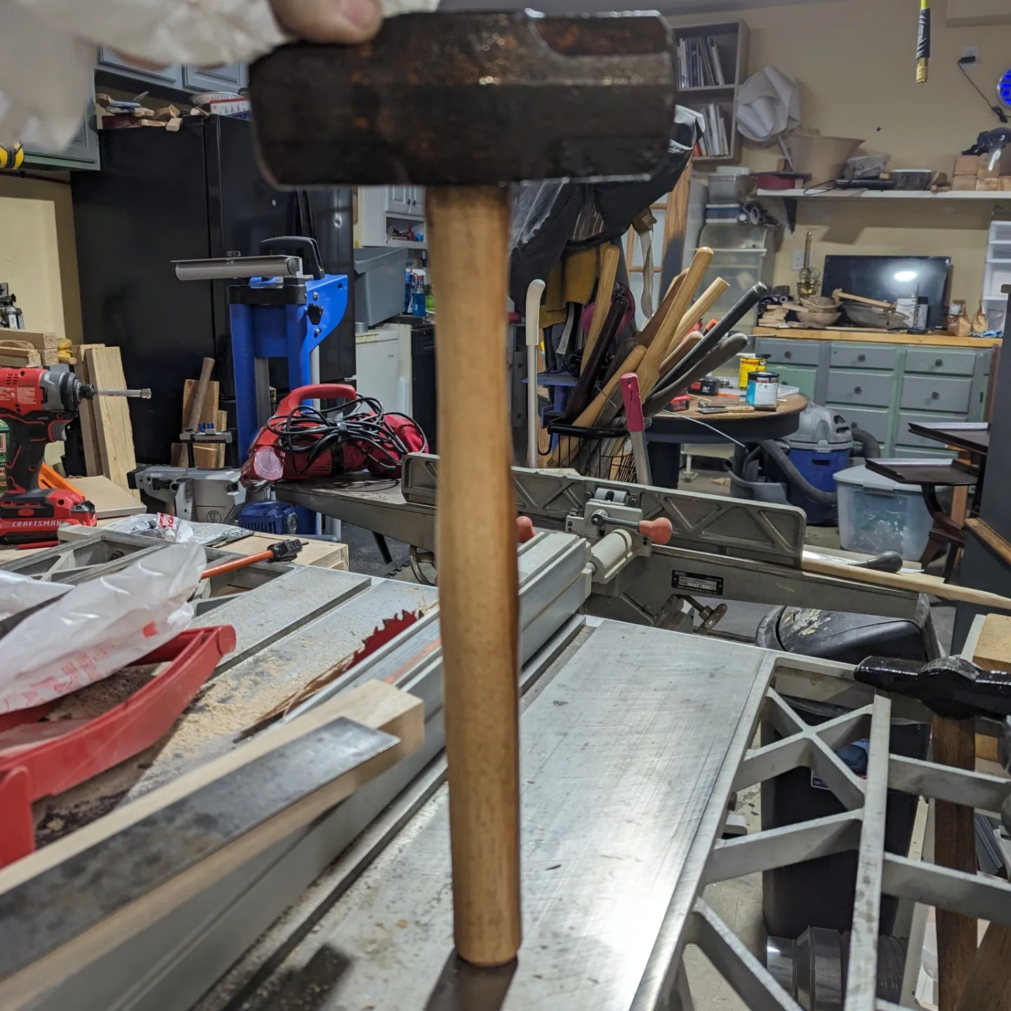

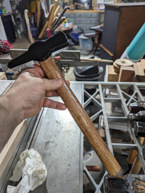

I missed the engineer. You can't really tell the one round face from the finished picture (top) but the pre-handle replacement (bottom) shows the profile pretty well. I did it by eye so I couldn't say for sure, but maybe a 10 or 12" radius?? It does move stuff pretty well for its size, so I find myself reaching for it. I have a second one of the Piccard style ones but as the replacement, the handle is definitely mounted well. Unfortunately, the cross peen is almost squared off flat, and the face, although they are calling it a round-square will be seeing some spa time with the angle grinder before I put it into service. For now, it sits next to my work desk in my office.

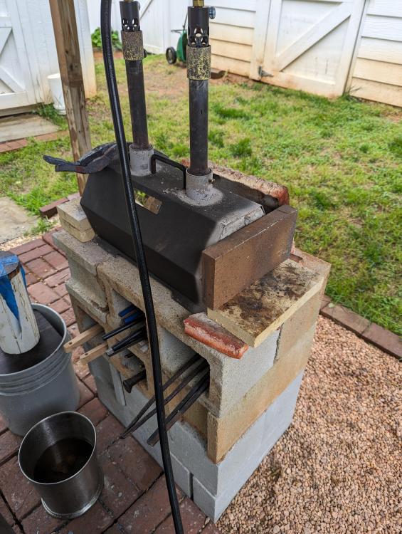

Applying what I have gotten so far, I was able to get the inside quite yellow! Metal was getting far hotter, and moving much more easily. I made a quick 4130 cold chisel and with a simple squared off end I was able to slice a piece of steel electric panel cover. I had 2 partially worked pieces that were supposed to be hooks, that I gave up on the other night, and I was able to get them to move all kind of easily. I had to use my too thin tongs, but with the metal moving better they were nearly useful. I saw some temperatures where the metal almost looked wet, so I assume I am getting closer to welding temps, which I was nowhere near. I didn't go back to my way thick tongs in process since I didn't have a lot of time. However, when I heard the sputtering death rattle and I saw the bottom quarter of the tank was all frosty... I decided I was done for the evening. So it seems that lots more pressure is quite helpful, but I was only able to work for 1-1/2 hour before that particular tank got too cold. I assume that I could somehow operate lower, but no way of knowing what pressure I was working at, and I turned it off at the regulator. Live and learn. Next time perhaps I will attack the thick chunky tongs. PXL_20240515_001957200.TS.mp4

Okay, cleared the bricks off the bottom, and setup doorways. How's this Bricks removed from floor, doorways established.
