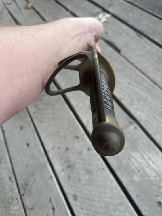

Howdy everybody! How’s it been going?
it’s been a hot minute since I been on here, been busy busy busy at the new place!

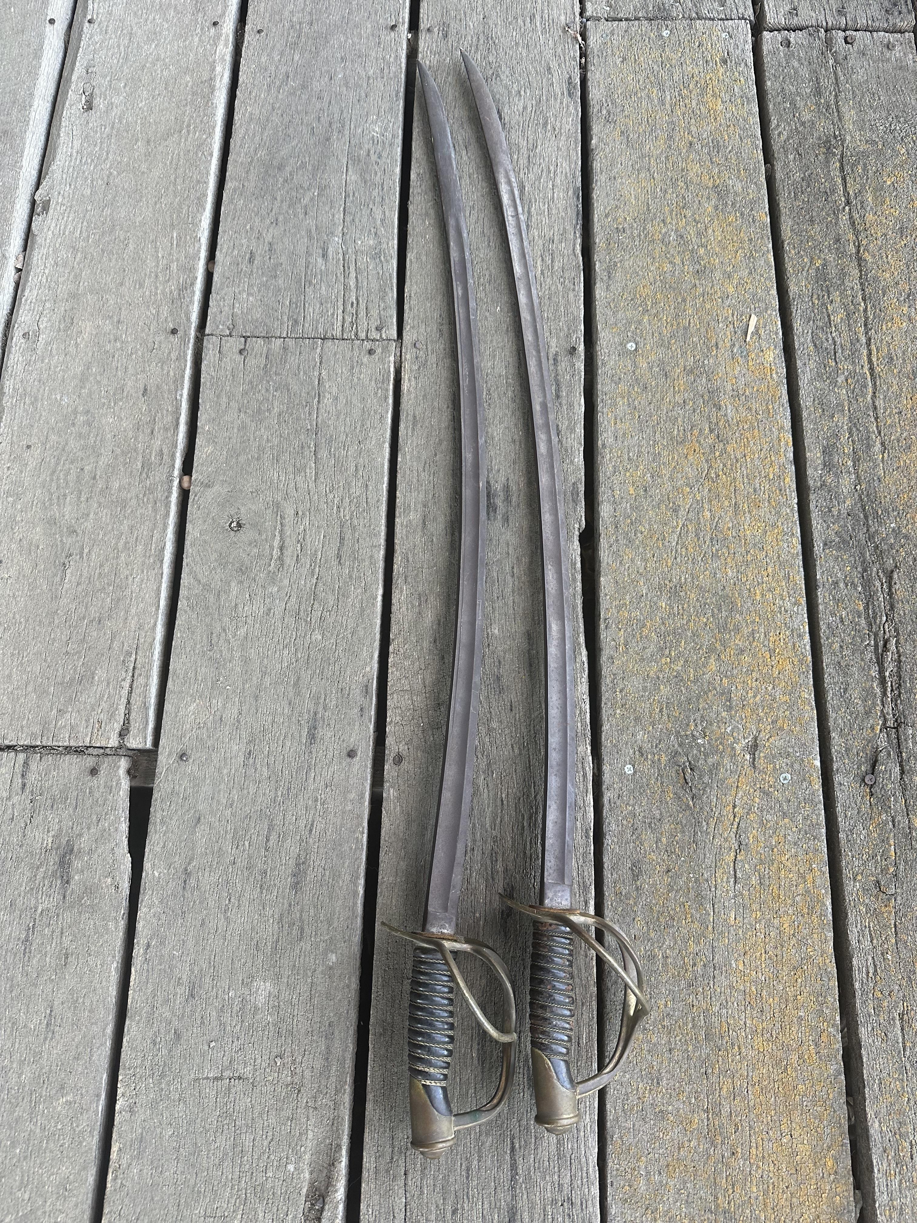

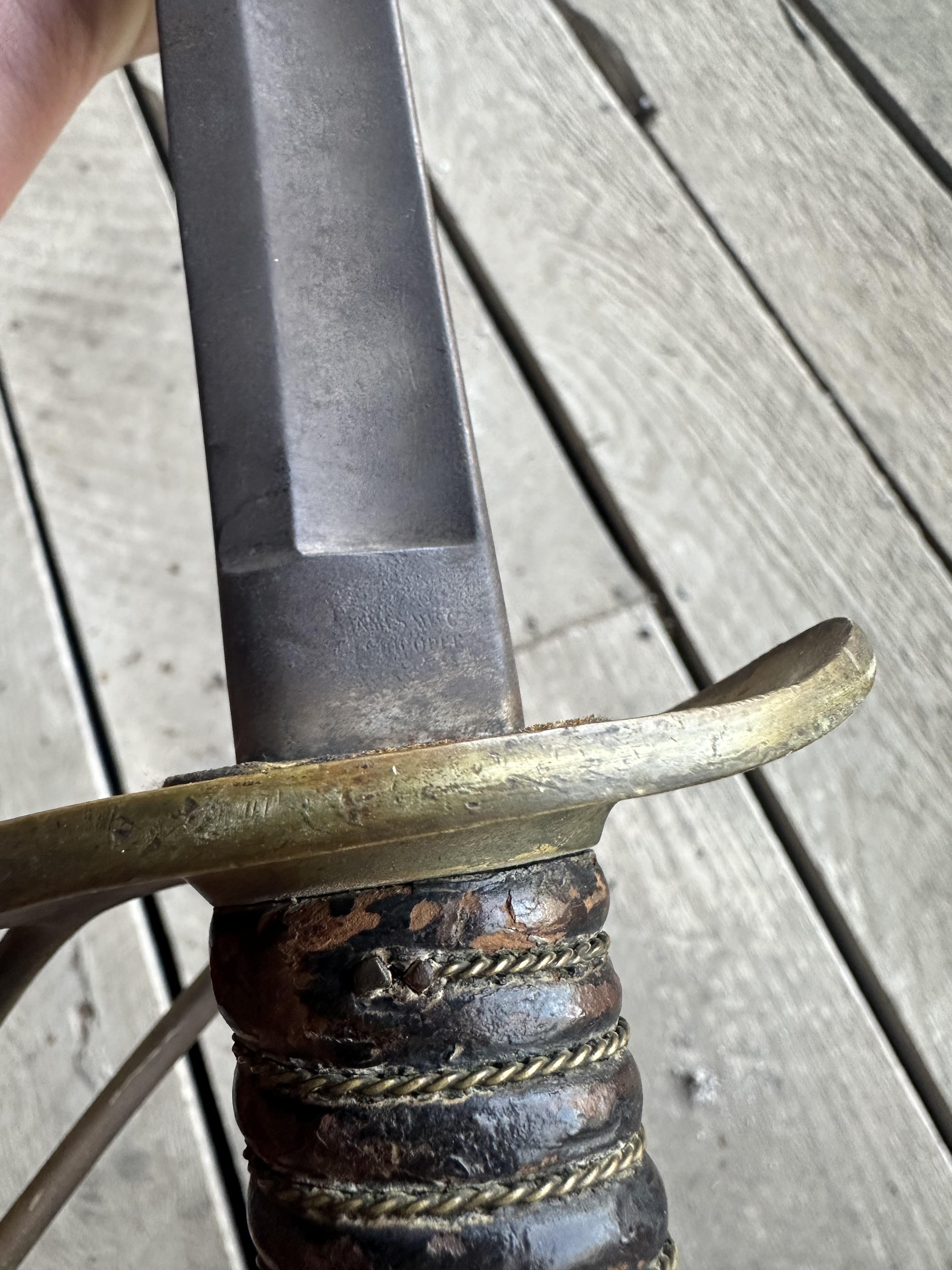

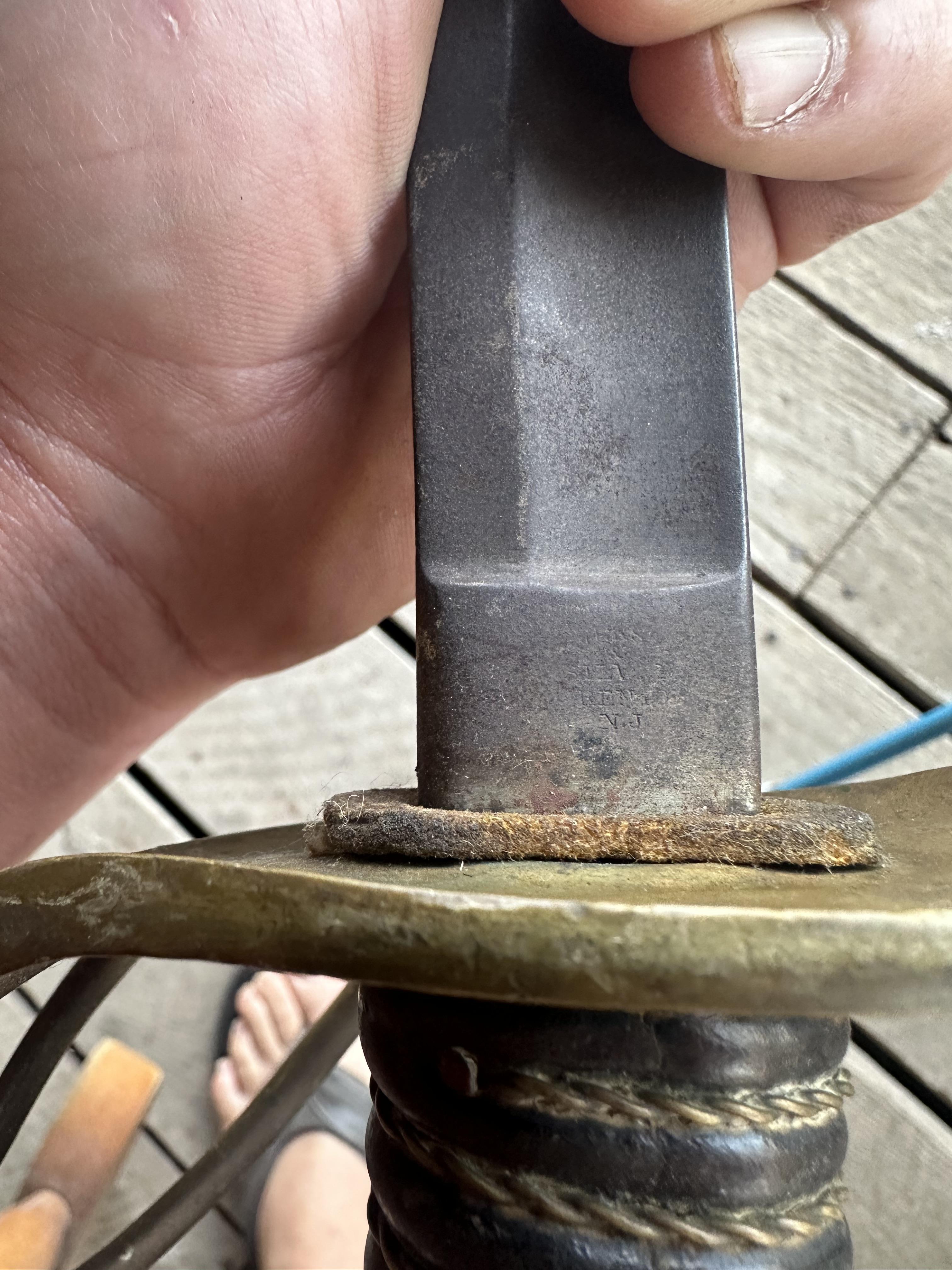

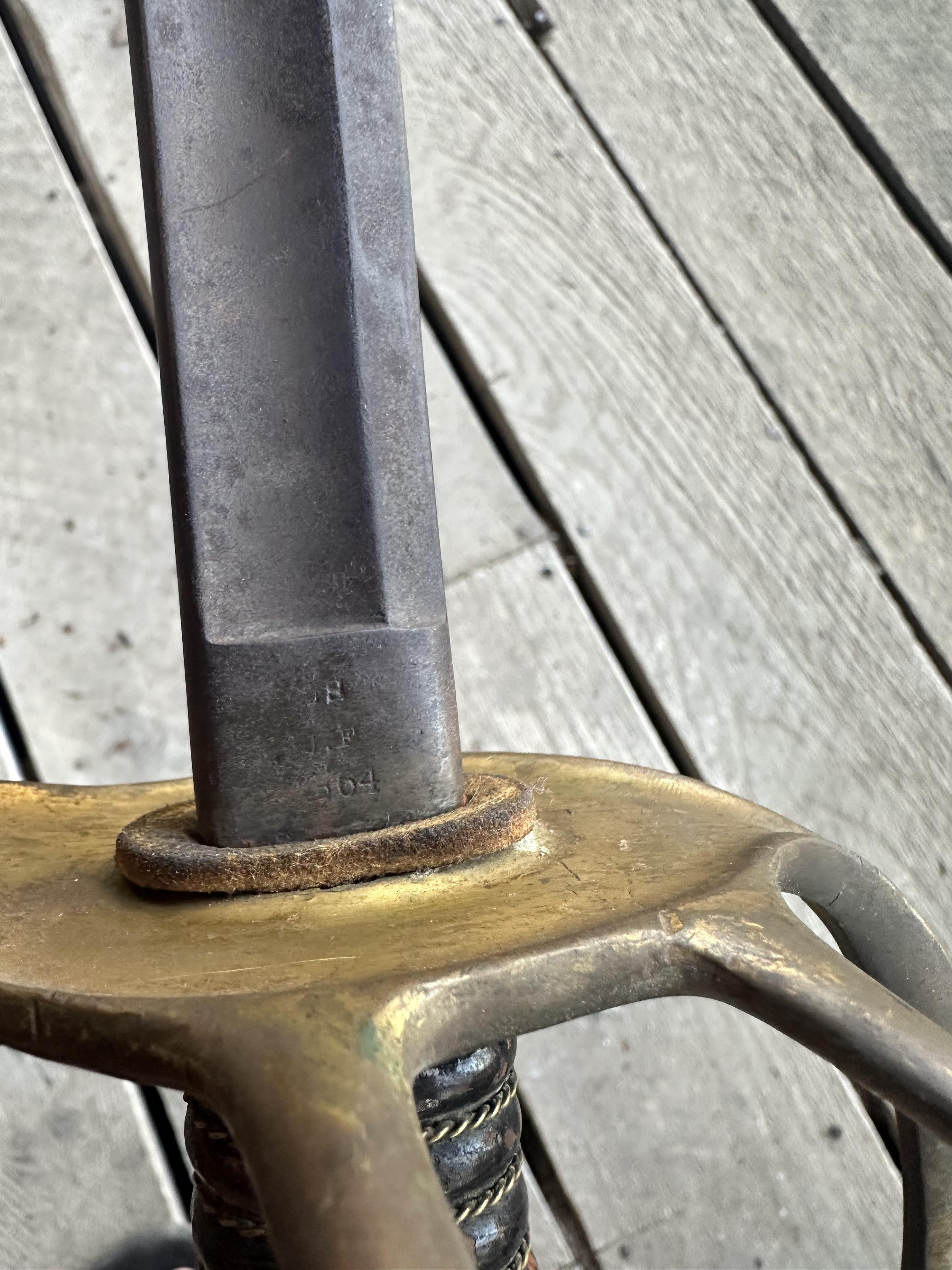

I just had a couple of antique swords givin to me about an hour ago, they are heavy on the patina but I can make out Ames MFG
(or at least I think I can:wacko:) lol

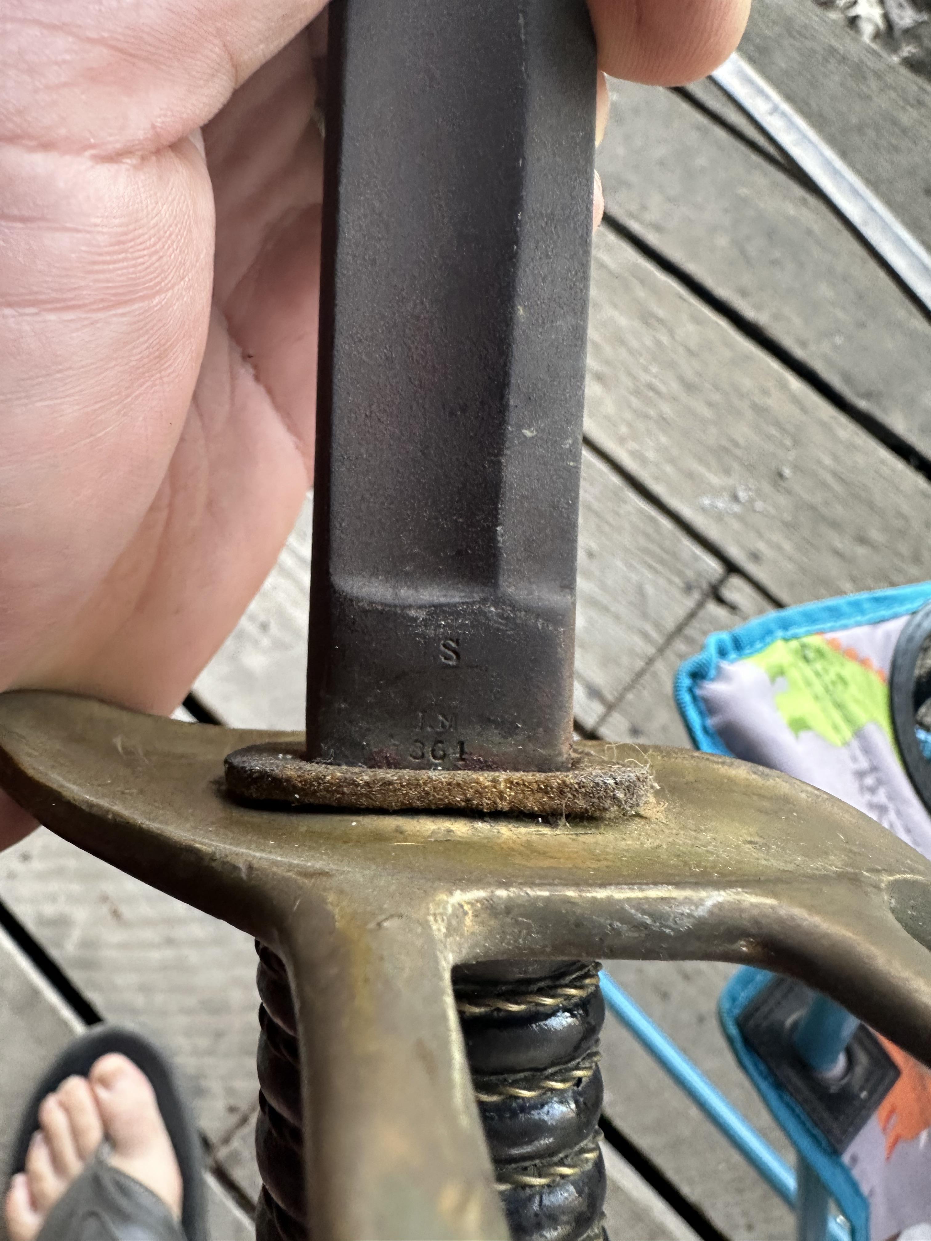

thats on one side and then some numbers and letters on the other side
The only thing I know about swords are that they are pokey on one end and you hold the other end that’s not pokey! Lol

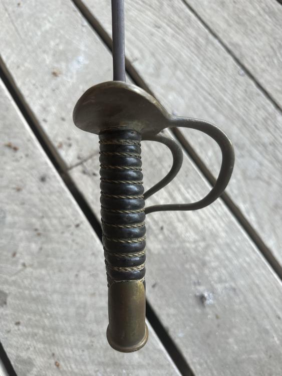

im afraid to use anything to awfully abrasive to clean up around the hilts so I can read what they got to say, there’s a lot written there but it’s hard to make out,
I’m wanting to do some research on them, what would be the best thing to use to clean up the area with the writing to make it legible?

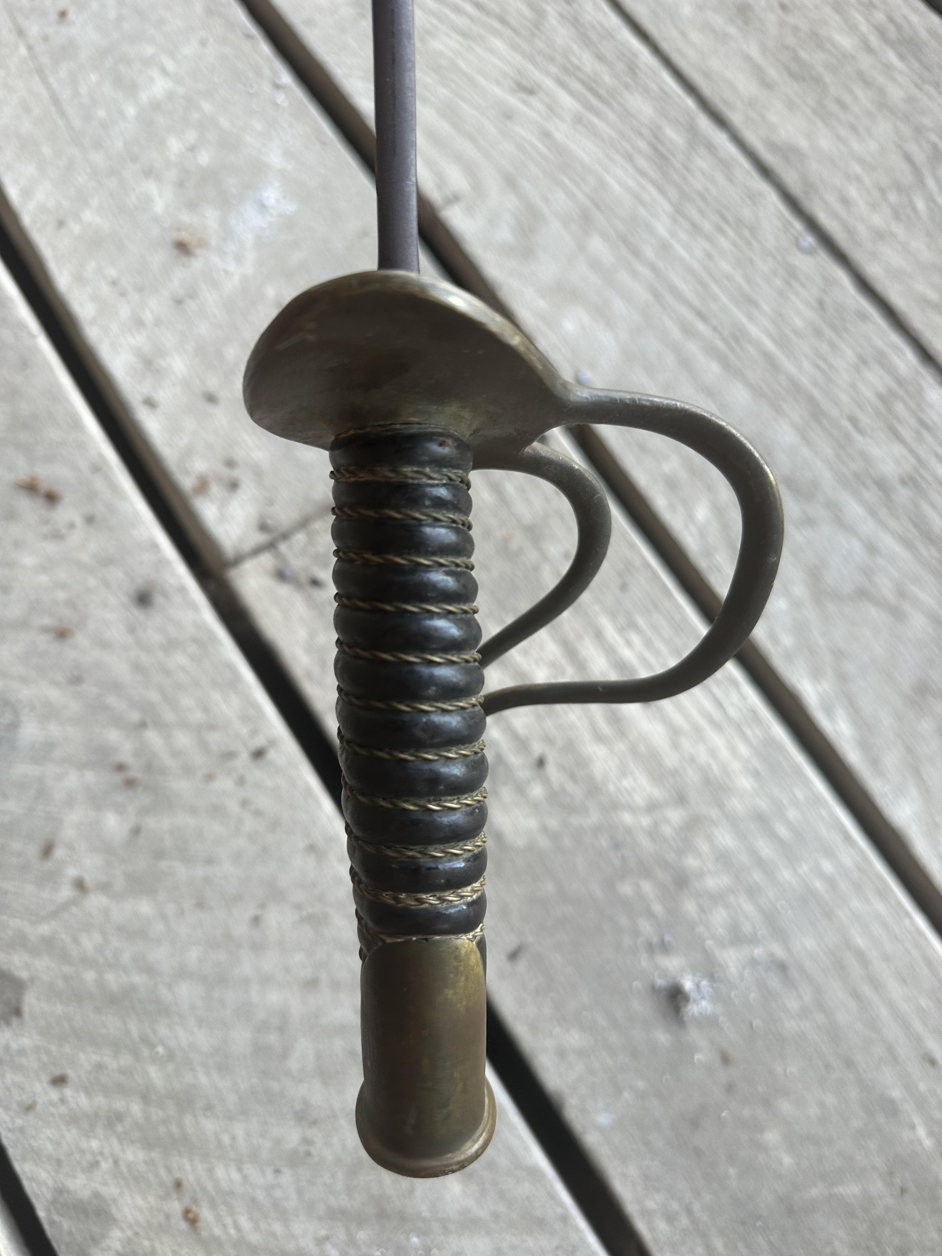

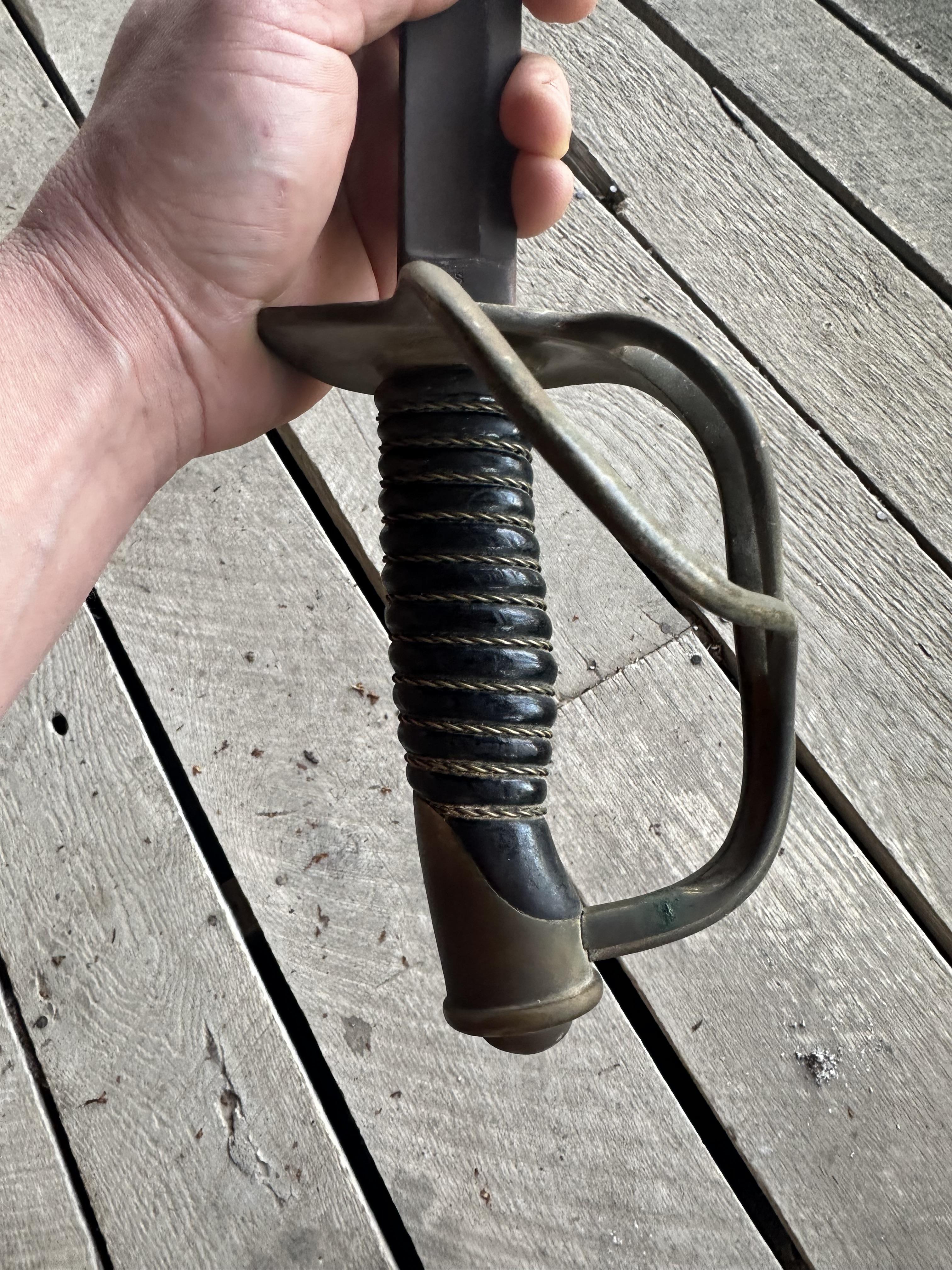

If I were wanting to restore or rehab those I'd see what it took to take the hilts and guards off. The blade and tang should be plenty happy with electrolysis just don't leave it too long or it'll start to etch. Cleaning and rehabbing the handle, guard and butt cap shouldn't ge a major job.
While electrolysis works well on brass or bronze, NEVER mix metals or weird things start happening say the copper in the brass plates the anode or the sword blade if you do it second.

Glad you & yours are doing fine and welcome to the rabbit hole of sword collecting. I think they are the M1833 model, Dragoon saber used extensively in the ACW so quite old and in very good shape.
The words Made by/Ames Mfg. Co/Chicopee/Mass are enclosed within an unraveled scroll, and initials/US/date is stamped on the opposite side of the blade. This scroll mark is usually very weak, and often has been partially worn down by the scabbard—this is a feature that helps in authenticating the sword.

I wouldn't remove the handles as the twisted wire wrapped leather is probably very fragile and it could fall apart. Ask me how I know.:) A lot of collectors will devalue the sword that has been cleaned up to look like new.

I’m not sure I want to actually restore them all shiny or nothin like that just clean them up a bit, I’m afraid I’d mess something up if I tried to disassemble them for super deep cleaning, I just wanna clean up enough to read and maybe get a date,

don’t worry I’m not gonna mess with the wire or try to remove the hilts,

but I also want to display some antique weapons and some artwork in there, so we come to the swords, I want to display them but I would like to clean up around the writing so I can possibly date them and have the history of them, but probably not go as far as restoring them,

I gather the scabbards are not with the swords.
I have had some success "cleaning" old blades using dawn dish washing soap on a damp clean rag then rinsing them to get any soap residue off. After drying the blades rub them down with Renaissance wax. I did that on a WWII Japanese Non com officers sword and it looked good without making it look new. If you wanted to go further use some oiled 0000 steel wool and lightly rub the blades until you get the finish you want, then wax them to protect them. That will usually leave them clean but not shiny new.
You could also just use the steel wool on the Ricasso to bring out the writing.

Just to say, sometimes, Many times cleaning off the patina ruins the value on antiques like swords, bayonets and the like.   Just so you know that going in.
Not going to say I wouldn't think they would look great cleaned up and displayed.

  Those are really nice, Billy!  I never dreamed I would have sword envy....:)

A tip from the art restoration world: first, put a few drops of your chosen soap/detergent in a little water and stir to combine. Then dip the bulb of a cotton swab in the liquid, press it against the side of the container to squeeze out the excess liquid, and then clean a small area about the size of the pad of your thumb. Look at the swab to see how much dirt is coming off and repeat as needed. Make sure to blot off any excess water and wipe each area dry before moving to the next.  Continue this process until you’ve cleaned everything that needs cleaning.
I would *not* recommend penetrating oil for initial cleaning, as it can sometimes stain leather and it’s impossible to get out.

I was wondering what to do about the leather it’s really really dry

Billy, for dry leather you may want to try neatsfoot oil.  Sometimes leather is so dry and brittle there is no way to bring it back but I have found neatsfoot oil works about the best of anything I have tried.  It will darken leather but almost anything will.

Call a tack shop, we used to buy leather dressing oil for saddles and leather in general. I believe "Neatsfoot oil" is still very high on the list of preferred leather treatments. It will darken light colored leather. WE kept the "special stuff" in the tack room but Mother and Dad tended to believe salesmen so I don't know if it was anything special or what the name was.
