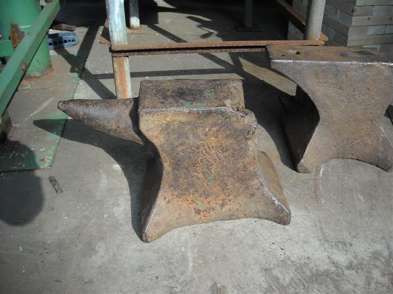

Actually here's a question that perhaps someone who does re-enacting might be able to help with. I'm trying to determine if the style of this old horned anvil I have could possibly be early enough to have been period around the battle of Culloden (1745)
I can tell by the manufacture, with the pointy feet, the short and wide body (12" long if you include the length that would be there with the missing heel, and 6" wide) and the lack of a shelf at the end of the horn that the anvil is 1700s or very very early 1800s (I'd be able to date it even more accurately if the heel were still there so I could tell if it had a pritchel hole or not, though I suspect it did not) I'm just not sure if that may be too late period for a fairly strict living history group, or if I should be looking for a hornless anvil (not that I'd use an actual early colonial hornless, but I will [and do] use the above pictured colonial anvil with no heel)
I've got other anvils and anvil-like objects that are certainly period for even far older times but they're not ones that i'd want to use for any work for fear of damaging them
