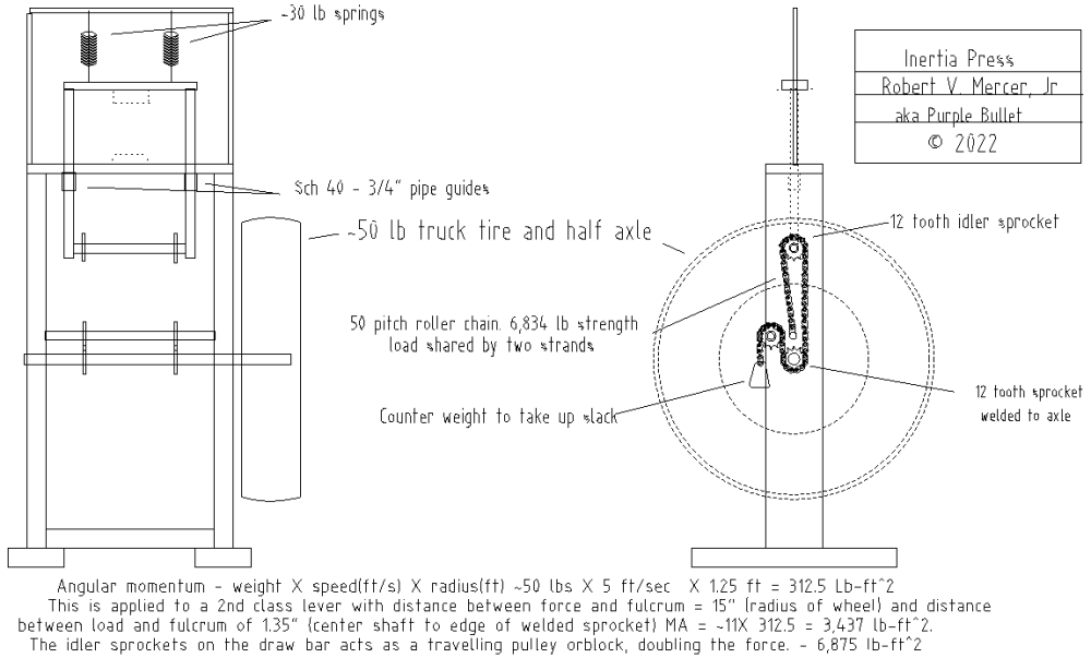

Purple Bullet Posted July 24, 2022 Share Posted July 24, 2022 At one time a little over a year ago I was all ready to buy a new fly press. I couldn't find one locally and when I called one of the importers he said he wanted to wait and see what the economy did before ordering any more. It got me thinking about trying a build, but although I have a lathe that might be capable, my skills are not up to cutting multiple thread screws. I also kind of question the design. I've never used one, but I've heard of bumped noggins from the handle or counterweight. Also, the force you are putting in is horizontal while the force delivered is vertical. Not the most efficient, but then again, I don't know. Maybe its easier to develop a horizontal pull than a vertical. I started to think of how to do this with commonly available materials. I remember as a kid growing up down Bayou Lafourche, seeing boats lifted up out of the water with two windlasses made of wire rope wrapped on pipe and a large hand wheel. These were ~20 ft skiffs with inboard engines. I don't know how heavy they were, but I'm pretty sure they were multi-ton. I made a trial run with something made from a truck tire with half axle. I turned the axle down to fit pillow block bearings that I mounted on a stout frame. I used two lengths of wire rope to pull two 3/4" rods through guides welded to the cross piece that held the bottom die. This was attached to the movable cross piece (or ram?) that would hold the top die. I made a lightweight frame with springs to lift this pressing part. It worked after a fashion. I could cold bend 1/4 in square mild steel in an angle iron die, but too much energy was wasted in coiling the wire rope so tightly on the shaft. Now I'm trying for a re-design and would like some advice before I go buy the materials. Especially I'd like to know if I'm figuring these forces right, but if you see anything that doesn't look right or safe about this, I'd appreciate the input. One big caveat! THIS IS EXPERIMENTAL! Don't take this as a "how to" to build your own. I'm not saying "Don't build this." I'm saying there are no guarantees here. That's why I'm soliciting input from the experienced and knowledgeable folks on this forum. I BTW - speed of 5 ft/sec is just a guess. I'm thinking that is reasonable for a speed you could accelerate to before the press die hit the object. Link to comment Share on other sites More sharing options...
George N. M. Posted July 24, 2022 Share Posted July 24, 2022 PB, very interesting and a concept I haven't seen before to convert the radial inertia of the rotating tire to vertical force on the ram. Is there a stop at the end of the motion of the ram to halt the vertical motion? Could you use something other than a tire as a flywheel which has more mass nearer the rim? That is why the weights are on the end of the bar on a fly press and are sometimes adjustable in and out to vary the pressing force. This may be overthinking but could you incorporate a clutch mechanism where you could spin up the tire and the engage it into the ram to increase the pressing force? I'm thinking spinning it by hand, not using a motor which might give too much oomph. Anyway, I look forward to seeing how this works out. I like the idea of using inertia, like a fly press, rather than hydraulics. GNM Link to comment Share on other sites More sharing options...
Purple Bullet Posted July 24, 2022 Author Share Posted July 24, 2022 Thanks, George. The tire was just my first available thing to use. I thought of filling the tire with concrete, but that would be WAY too heavy. Currently, I'm thinking of rolling or segmenting a three inch pipe into a 30 in circle and weld that onto the tire rim instead of the rubber. Do the force calcs look reasonable? I thought of having different sized sprockets for faster but lighter strokes. Not sure that would be worth the effort. As for a clutch, are you thinking something like a derailleur on a bike? The chain could be on an idler sprocket and swapped to the drive sprocket? Link to comment Share on other sites More sharing options...

Latticino Posted July 25, 2022 Share Posted July 25, 2022 I think you are underestimating the side forces the pressing of a piece of stock may have on your frame and guides. There is a good reason for those heavy weight guides on fly presses, hydraulic forging presses and power hammers. I would be careful of the potential for off center force, the guides binding, and the whole thing wracking. Just the offset of the chain from the center of the axle may cause you trouble. Still, best of luck with your build. I'd love to be proved wrong. Link to comment Share on other sites More sharing options...
Purple Bullet Posted July 25, 2022 Author Share Posted July 25, 2022 Thanks Latticino. I had that problem on my first try using wire rope without a pulley. I can't say I solved it, but the way I got around it was to have my anvil "float" on the top of the frame. The anvil and ram were made from heavy duty truck springs. I used the center bolt hole to mount my dies. The two draw rods were not connected. The cable would wrap unevenly and it would move as it wrapped. The small movement up until the instant that everything came together was easy to compensate for in a test, but wouldn't be acceptable in a production machine. That is one of the reasons I'm going with roller chain. My hope is that the pull will be consistent enough that I can place the anvil where it will always pull straight through the guides before i weld it down. I'll give your advice some more thought. Perhaps static rod guides ABOVE the anvil that the ram will ride down? And I'll try to be more careful to center the loads than I was in the drawing. Link to comment Share on other sites More sharing options...

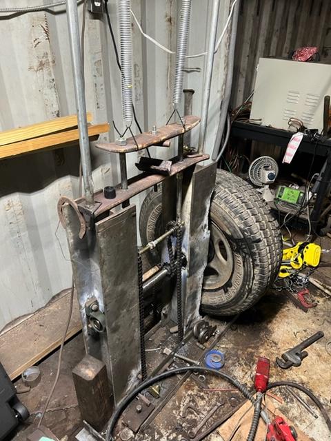

Purple Bullet Posted August 17, 2022 Author Share Posted August 17, 2022 Doesn't look much like the drawing but it does work the way I envisioned. So far I have only used it to cold bend some 1/4" square stock ( I know, you can bend that by hand). The first time I tried to cold bend some 3/8" round it didn't get very far. I found that the tire was loose on the rim and was slipping when it hit the end of the stroke. I inflated the tire to get it firm on the rim and then was successful in bending the 3/8" rod. I bought a couple of rollers to stabilize the draw bars, but so far I haven't needed them. I think it is because I'm "pulling" the force down instead of "pushing" it. My dies are some heavy 2" angle iron with a 1/2" threaded rod welded to it and a 3/4" round ground flat on the mounting side and another 1/2" all thread welded on. I'm thinking of cutting the bottom mount out to 3/4" square so I can use my hardy tools in it. I think my next step, however, will be to remove the tire. bend some 1-1/4" conduit into a 30 inch circle, fill it with lead and weld it onto the rim. I have no idea how much force I'm developing, but it does seem like a useful amount. Concentrating more weight on the rim of the would give me much more initial (and inertial) force to work with. Link to comment Share on other sites More sharing options...

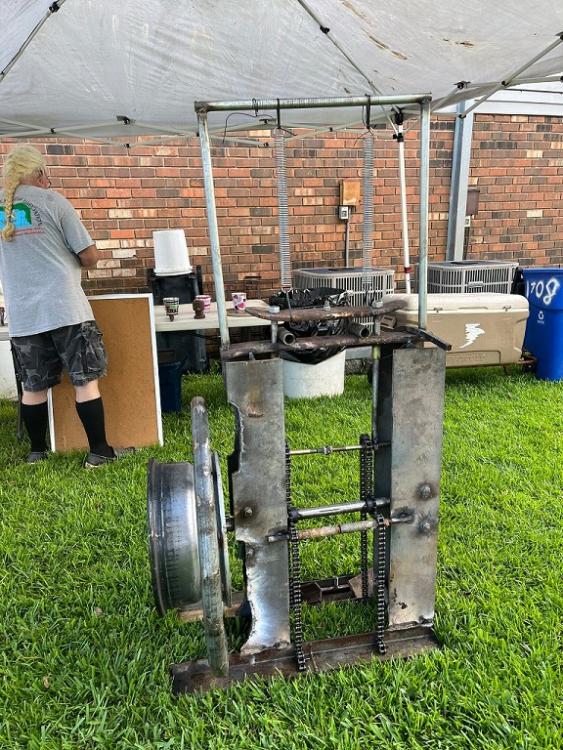

Purple Bullet Posted September 1, 2022 Author Share Posted September 1, 2022 Update time. Probably well past, but I'm recovering from a couple of health issues, not the least is sciatica. I brought the press to our Gulf Coast Blacksmith Association meeting and it was pretty well received. I demoed bending 1/2" square mild steel cold. I got some good suggestions for improvement, specially from Larry House who suggested a brace leg to avoid losing force to lateral movement. I plan to implement that as soon as I can get back to the shop. As you can see from the picture, I ditched the tire (well not entirely, I'm going to make a horse swing for the grand kids) in favor of some junk tubing, sectioned into a circle with ~30 pounds of lead poured into it. This concentrates the weight more to the rim to get the most MA. John's posts on his flypress tools are an inspiration. I just need to get well so I can work on it. Link to comment Share on other sites More sharing options...
